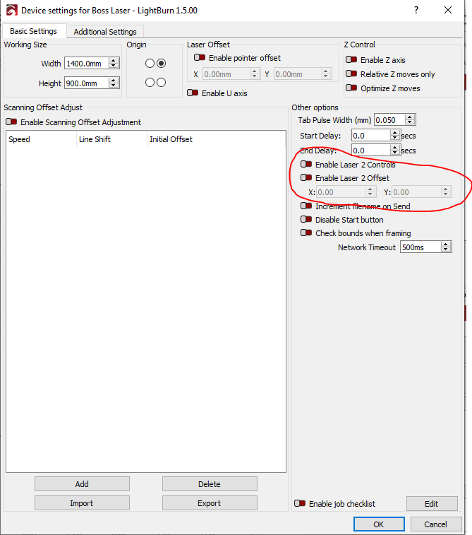

I believe you need to turn this on in Edit/Device Settings:

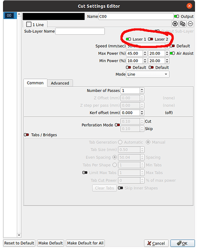

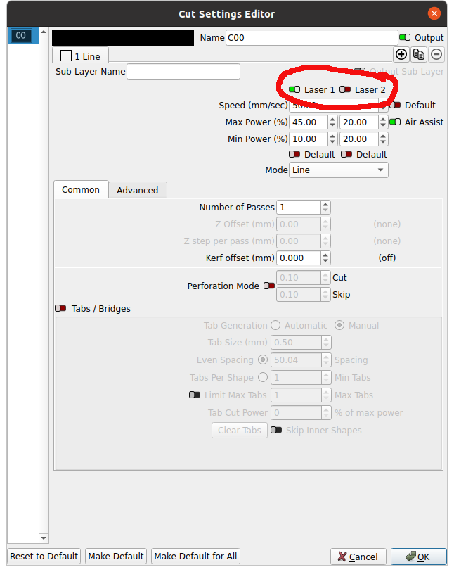

It should be able to control both of them with the enabling of two tubes, as @sutick advised. The layer should then have an available selection for each laser.

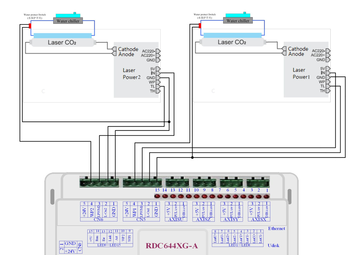

@MikeyH these are a standard configuration with most dsp machines. Here’s a roughed out Ruida dual tube setup… fyi
