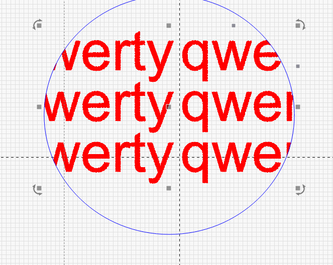

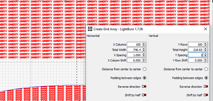

I want to fill a shape with text that repeats, so that the result is like wallpaper, with the same text repeated over and over across the shape. Is there a way to do that?
More then one way. One easy way, type text. Select and array. Select outside shape, select text, Bolean Intersection. First make a copy of the outer shape if you want it afterwards. Shape has to be closed and vector, not image.

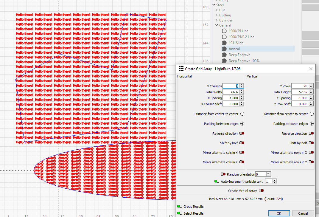

Thanks. Is there a way to have lightburn make many copies of the text? Your solution works with very large letters compared to the size of the shape. Using your example, I would want the text to be so small that QWERTY could fit a couple hundred times.
