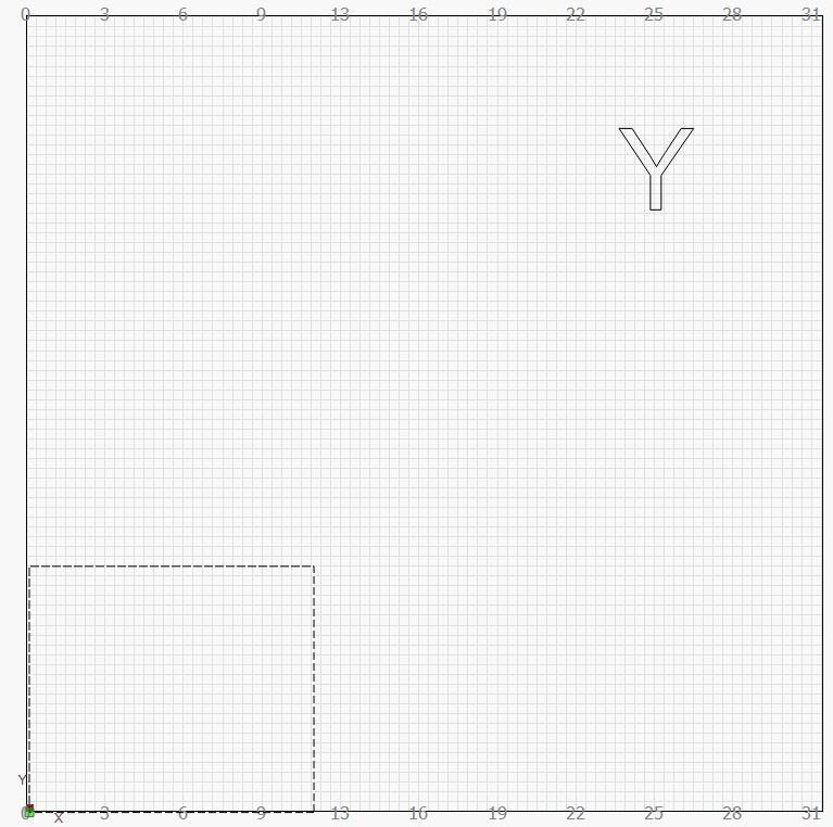

Good day to everyone Something happen with update on Lightburn. Never had to find it to fix it but here is my issue. I have a s33 ultra and it seems as if it does not have its sizing. At start up I entered in 26 by 26 just to try and it still only goes about 8 in up and 8 in over it did not matter if i put home at top or bottom or were i put my object. Where else can I look check. Belts are good I even tried image enlarging. it just is not relatable in sizing and placement. If you look at image the Y is location Tring to burn the square is all that will frame
In the console window type $$ then press enter key. Copy / paste the output here. Also post a screenshot of the device settings window (wrench & screwdriver icon) and your entire Lightburn screen showing the laser and move windows.
