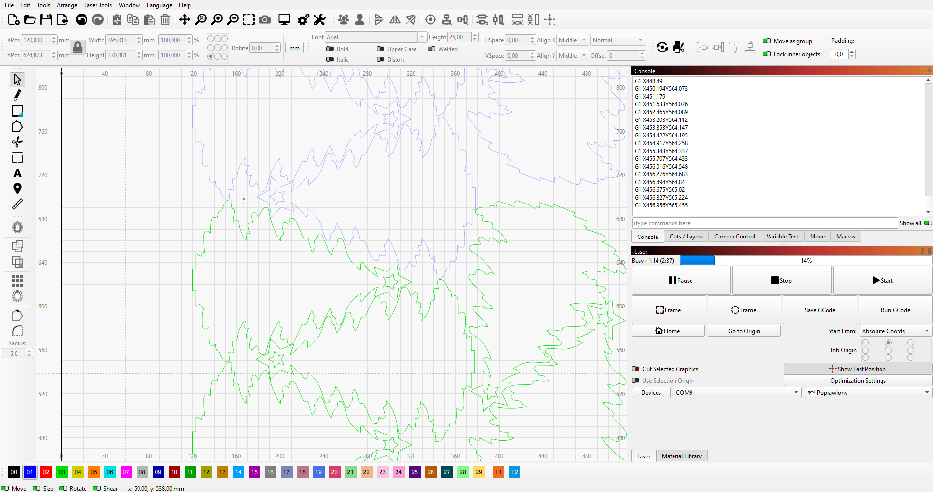

Hi, I have a problem with cut line optimalization.
I uploaded a file which I created in inkscape and exported as .svg.
From some unknown for me reason, the Lightburn is generating so much GCode to cut curves, so my laser is slowing down from 25 mm/s to even 5mm/s.(annoying and cut time is x3 longer)
I know Lightburn unfortunately can’t send G2 and G3 GCode to controller, it would be perfect solution, the controller will not speed up and slow down every command it gets.
Is there any settings that can reduce the resolution, so there will be less GCode generated → less movements changes → lower cut time?

If the basic shape is just the tree outline - it may help to offset the shape outward and then back inward, to smooth out the outline.
Can you set the layer to FILL and show us what it looks like?
Have you deleted duplicate shapes? I have seen on the forum many times that shapes made outside of lightburn will import with hundreds of unneeded duplicates.
Lastly, what are your optimization settings and cuts/layers?

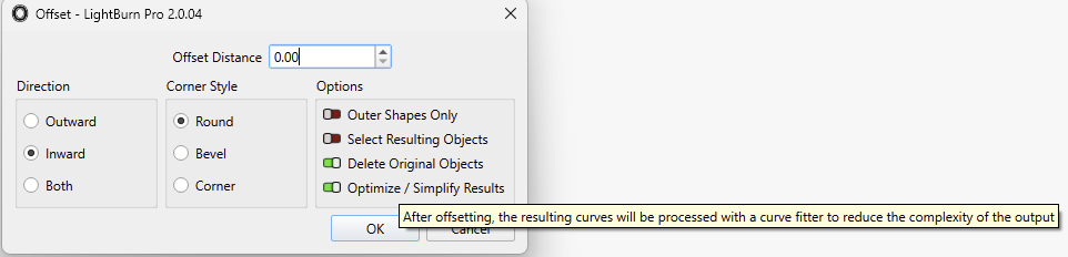

As James mentioned, the Offset Tool Alt + O can be used to simplify the vectors and delete extraneous nodes. You can offset by 0:

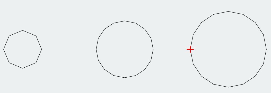

If the file has tons of short segments with lots of nodes, LightBurn will generally send at least the endpoints of the lines. If the shape is actual curves, you can change the “Curve Tolerance” value in the main settings (on the Import/Export tab).
That curve tolerance value directly controls how accurate LightBurn’s curve output is. The default setting of 0.05mm means that if drawing the curve as a straight line is within 0.05mm of the curve, that’s how it will be sent. If it’s further than that, LightBurn subdivides the curve in two and tests each half.
This is three circles - 0.2mm, 0.3mm, and 0.4mm diameter:
