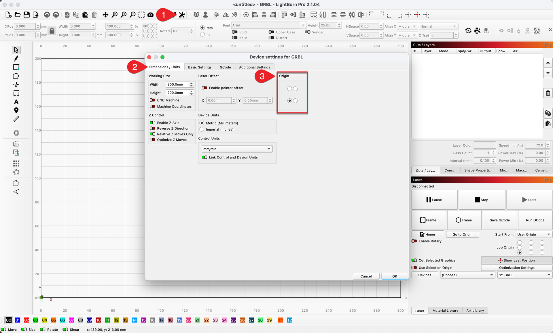

My engraving is starting at the back of the board upside down and engraving right to left and not the way we write left to right…help please.I’m a newbie and my first laser Woxcker L2 10 W

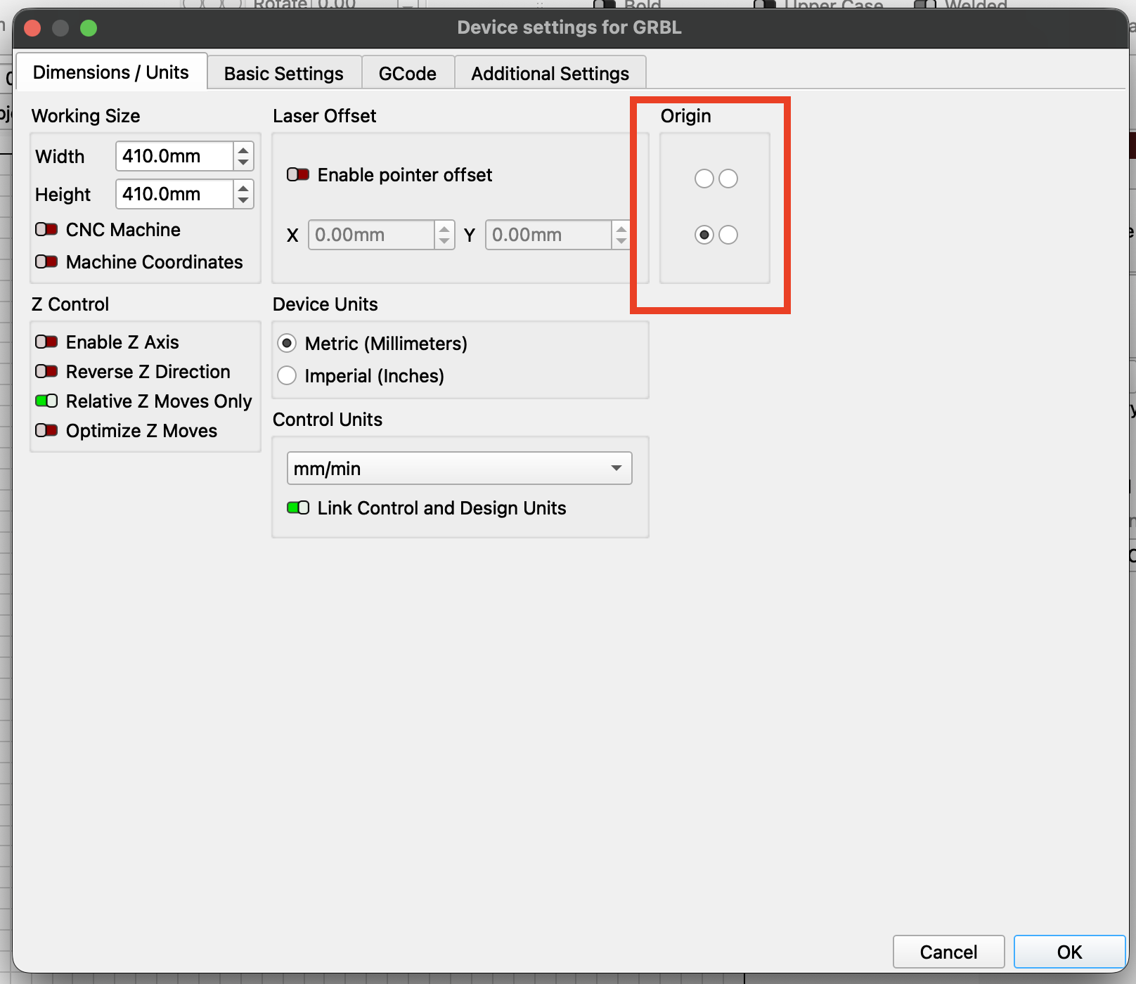

You most likely have your machine origin set incorrectly. Most diode lasers have the machine origin in the left front. Check & change it in Machine Settings (Wrench & Screwdriver Icon)
Is this diagram from Lightburn?
Yes, Device Settings. I misspoke earlier, sill wrench & screwdriver icon to open it.
Thanks Rick!..I check the orin and it worked!
Thanks Tim & Rick!..I check the origin and it worked!strong text
