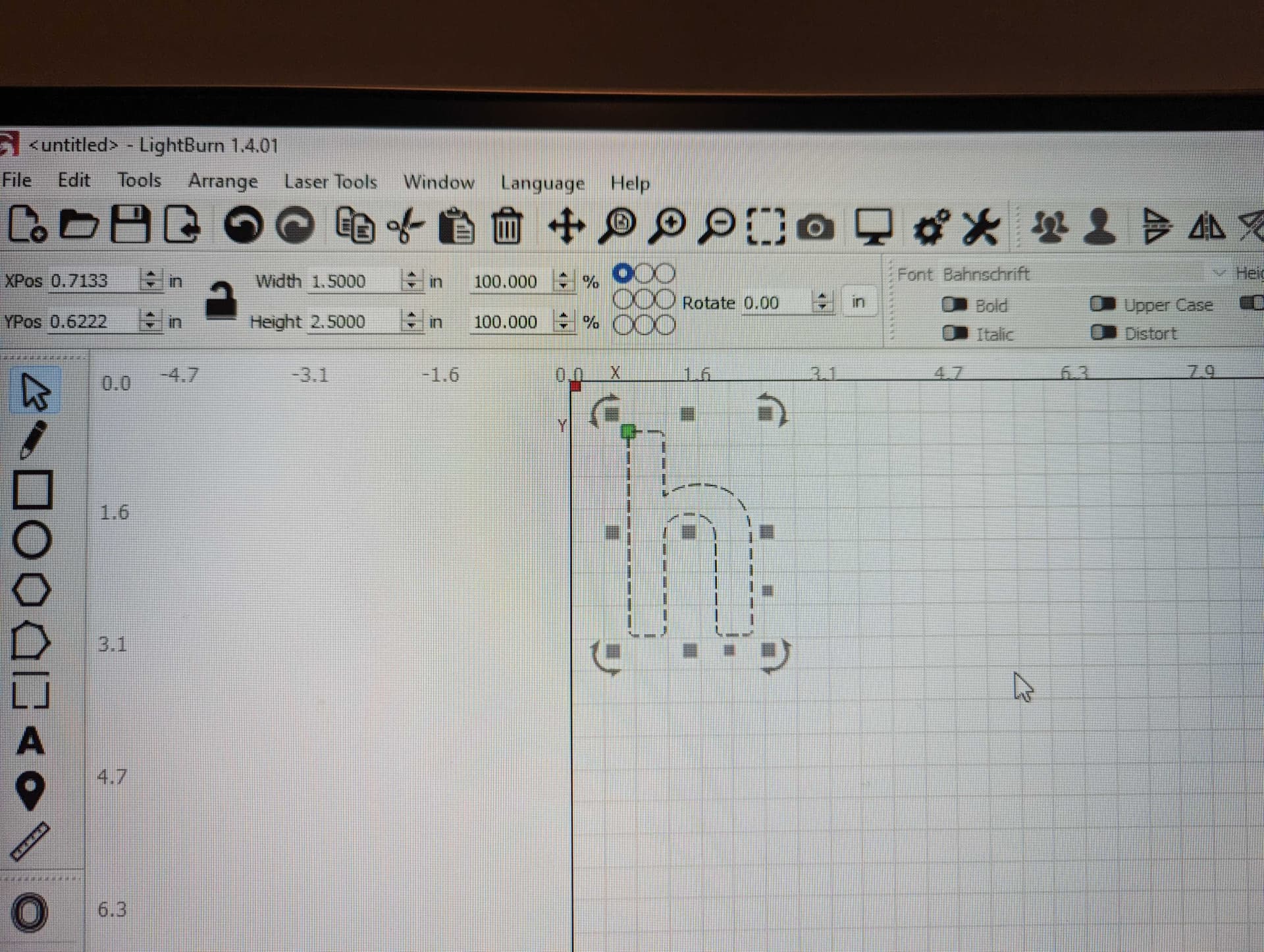

I am pretty new to Lightburn and am still switching back and forth to XCS as well.

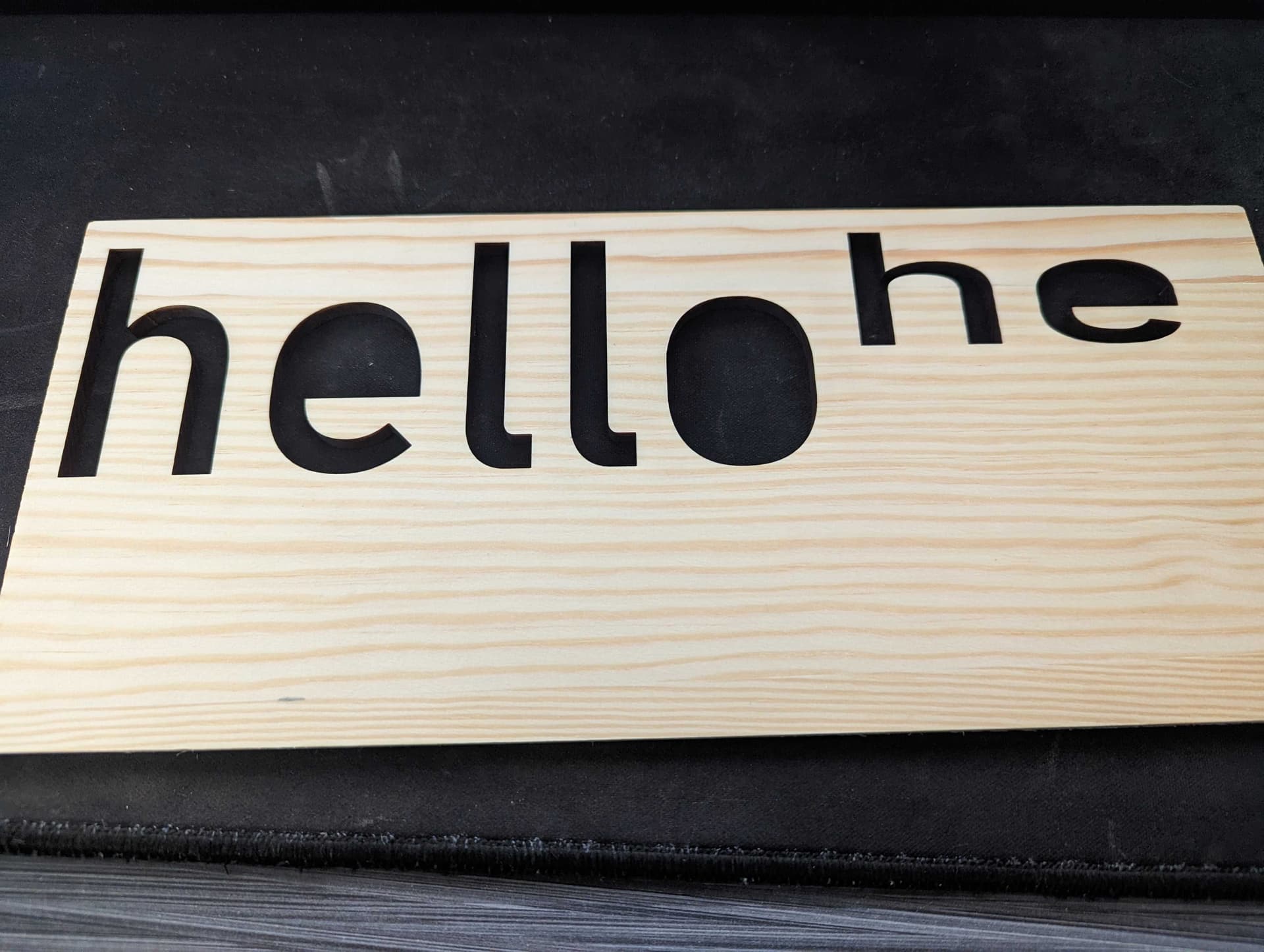

Question - I am using the same text in XCS and Lightburn and using the same width and height settings and getting completely different results with the two. XCS is cutting where I need it to but Lightburn is not.
I am trying to cut the letters at 2.5" height. In the picture below you can see the full hello is done in XCS @ 2.5" height and the h and e were done at the same 2.5" setting but only cut at about 1.25." Any help would be greatly appreciated!
Check to see if you have rotary enabled. Disable and retry.
This worked, thank you!
