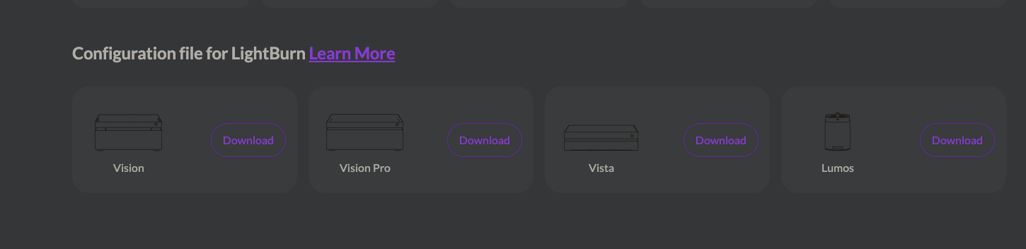

Go to the linked page they provide in step one and scroll down until you see the LightBurn configuration.
Step two guides you on how to import the .lbdev into LightBurn.
