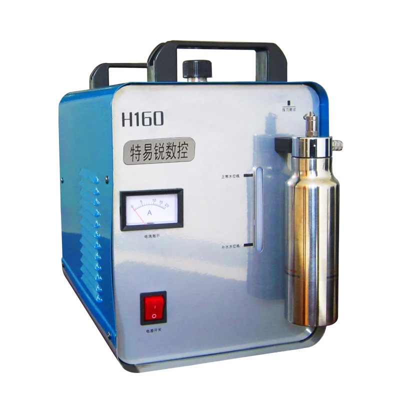

If you’re going to do a lot of acrylic work, it’s worth investing in an oxygen/hydrogen edge polisher - they aren’t expensive - and investing the time to learn to use one properly. you can sand using wet and dry paper, wet. Start at 240grit and work up. We pay $200-300 in NZ for one, so I imagine in the US they are $100-200. They ā€˜crack’ water for the hydrogen and oxygen and then burn it as fuel. I’ve used this one, it’s a good basic unit for a small shop: https://www.amazon.com/Portable-Hydrogen-Generator-Polishing-Polisher/dp/B01DNAU33W
The advantage to a flame polisher is that you can edge, relieve stress in the sheet and remove scratches in the face, as well as weld the sheets, without glue (although that’s a skill I’ve never acquired).
Often the polisher is sold as just the unit, you will need a couple of different handsets, depending - a fan jet for stress relief, scratch removal, edge polishing, and a point jet for welding. They are basically oxy welding tips/handsets, but lighter.
handset
The Amazon one does come with a basic handset, but just check when shopping around.

About the oxygen/hydrogen edge polisher, great piece of kit so it seems! I just looked up some videos on YouTube about it. Didn’t know these excisted. Already found some affordable ones on my local Amazon website (Netherlands, Europe). I have a Map gas torch, bought for this application really (used it for thicker acrylic) but that flame is pretty huge. Warps the acrylic pretty easily no matter how carefull or small i adjust the flame.
