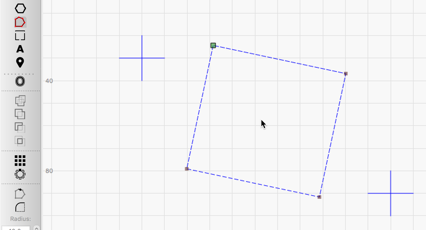

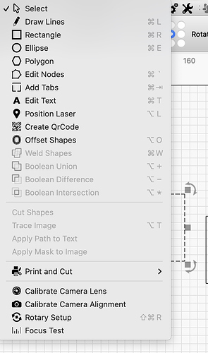

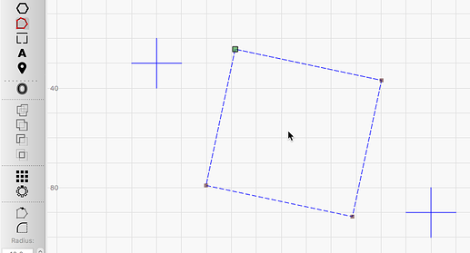

Not sure if this is a bug or some type of user error. If I have a shape selected (already ungrouped) I can’t get to the edit nodes unless I go up to menu -> tools -> edit node. The keyboard shortcut of apple + ’ doesn’t do anything?

Note edit doesn’t work on “Primitives” IE a circle, square etc. You need to convert to a path first, then that should work. If you draw the shape with the pencil tool it will work ok. And as you have found, it needs to be ungrouped as well.

You’re right, but in my case all the conditions are met and it still does not work as expected.

All relevant functions (the hot keys) in the toolbar are grayed out but work, also with hot key - except the hot key for the “edit” selection.
Mac Big Sur, 11.1, LightBurn 0.9.19
So it works if I go up to the menu and select it, I can get to see all the nodes, it’s just that the keyboard shortcut that is listed won’t also make it work for me.

Hi Rick! I am also running High Sierra 10.13.6, my lightburn version is … one behind 0.9.19? Honestly I am a bit stumped here, I don’t see where the version is listed? I tried checking it on a shape created with the pencil tool and with the original one I was working with and no go. Not a HUGe deal, I’m just a keyboard shortcut junkie… ![]()
