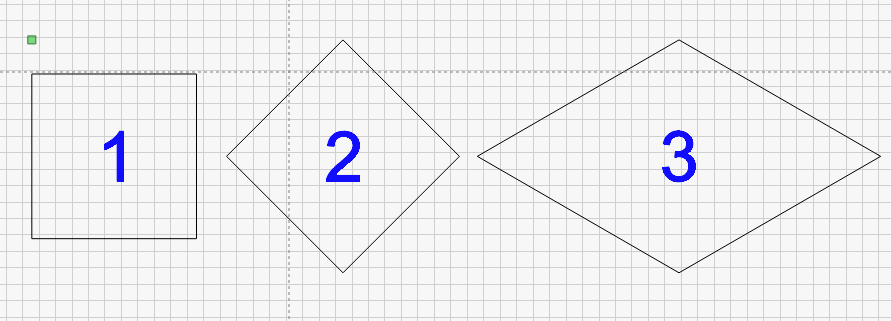

I want to make a rhombus (4 sides all equal in length) but not with 90 degree corners. I want a “star” shape with 2 120 degree angles and 60 degree angles.

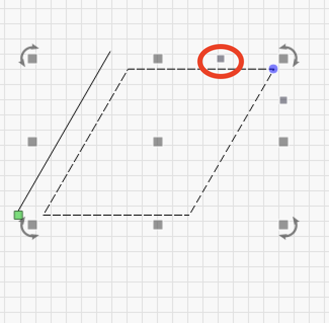

Make a square or rectangle with the sides you desire then place a vertical line near it. Select the line and rotate by 30 degrees. That will be your guide for skewing the rectangle with the skew tool. (the square that I highlighted in the screenshot)
Something similar has been asked before and the simplest way that I can think of is in a post I made here: Rectangle to Parallelogram - #18 by Marcus_Wakefield
Hope this helps.

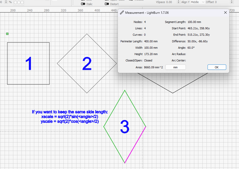

EDIT:
This method does have the potentially unwanted result that the side length is altered. If you want to keep the side length the same, then enter two scaling factors:
xscale = sqrt(2)*sin(angle/2)
yscale = sqrt(2)*cos(angle/2)
“sqrt(2)” is obviously constant so you can enter “1.4142” instead of “sqrt(2)”.
So, for example if you want a rhombus with a 60° corner angle then enter the following into the X scale: 100*1.4142*sin(60/2)
and the Y scale: 100*1.4142*cos(60/2)
