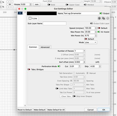

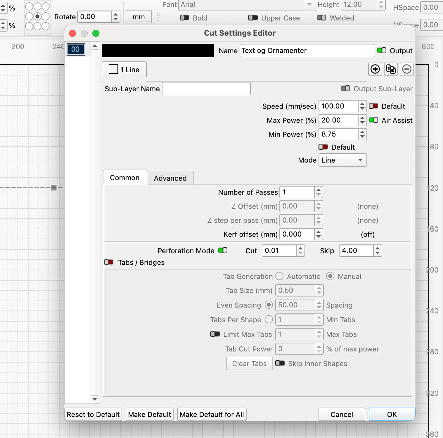

You can try whether “Perforation Mode” can give you the desired result.
…or “Dot Mode”

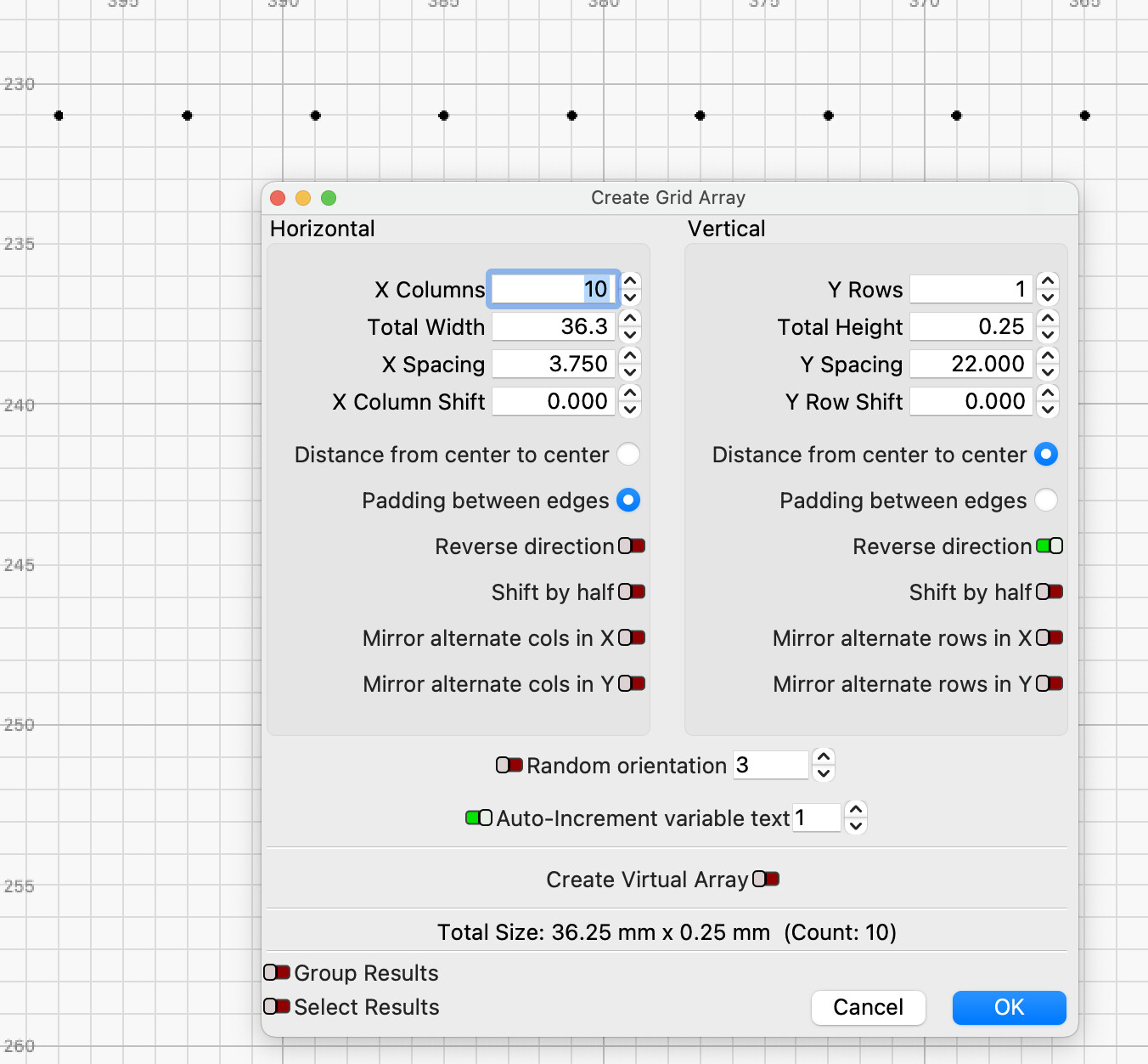

Create one dot. Use the array tool.
In Perforation Mode, I can only see the dots in the preview. Not on the workspace in Lightburn.

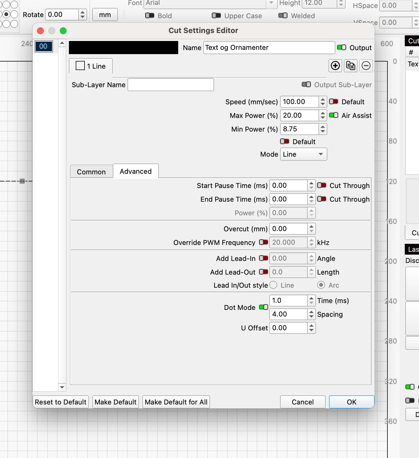

I don’t have dot mode in Advanced. How do I make it visible?
I have Lightburn 1.7.08
If it is not visible to you, it is probably a controller dependent function (DSP)

I think Dot Mode is not available for Diode lasers.

Probably not, because there’s no good way to specify the exact separation:
Perhaps fiddling with the exact length & number of objects would be close, but a linear array gives more control.
I can use Perforation Mode and I’ll go with this. :slightly_smiling_face:
