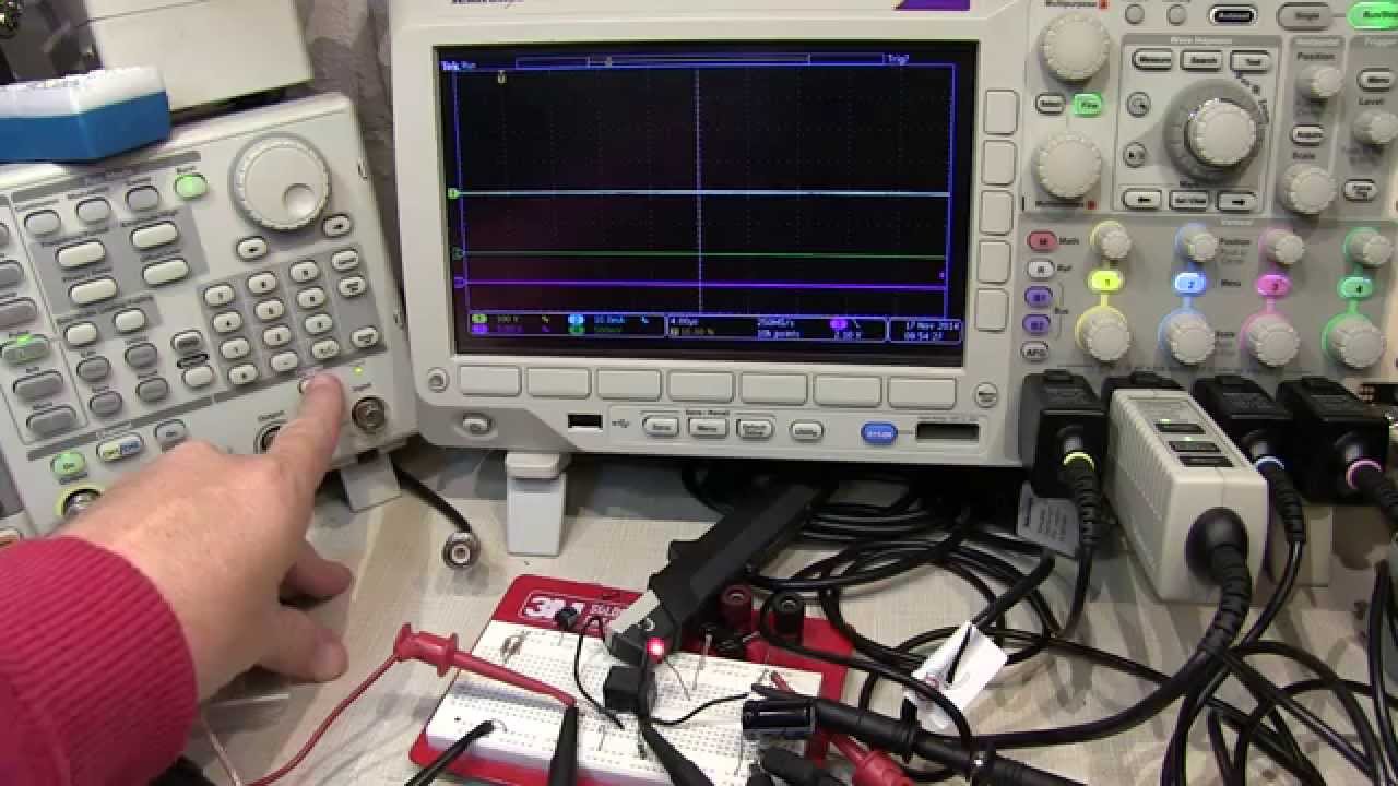

Snubber, reverse voltage, fly-back or whatever you refer to them as, are small signal diodes and are only required when you have a coil that is energizing, such as my solenoids for air control. They actually come into play when the magnetic field collapses.
A 5V circuit with a relay will create a reverse spike, in this video, it’s about 250V, but the current is very small, so a small signal diode works fine…
When this occurs, there is voltage and current produced… if you can’t drain it, the current changes in to voltage and it climbs… This allows it to destroy small signal and low voltage equipment…
