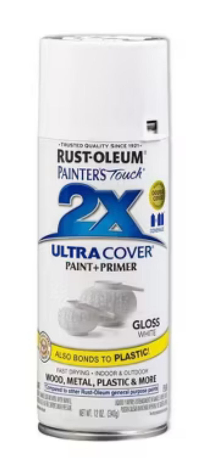

If you are using this type of paint:
I am sure you will agree that the cleanup phase of your project is a pain in the @$$ if you have to use acetone to clean up the white paint that was not engraved.

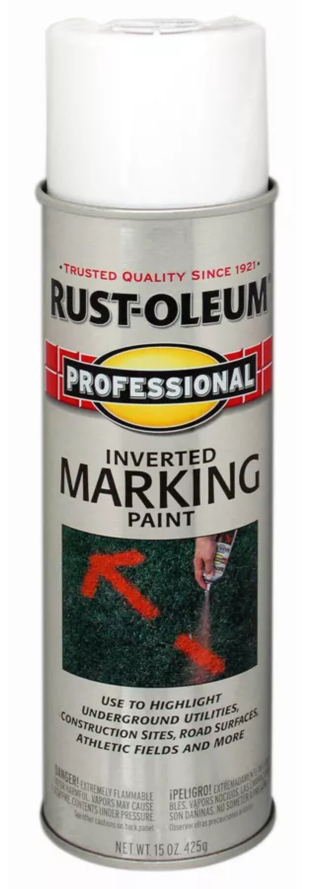

Did you know :? It is as simple as switching to using a water based paint found in RUSTOLEUM Inverted paint can used to mark on a field for sport games or construction :construction:

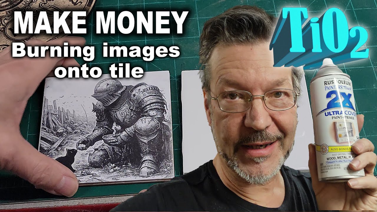

The YouTube presenter does a great job showing 3 different methods of preparing the tile. Also shares what type of tiles are best and why. I never knew that there was a faster way to remove the titanium dioxide paint until I discovered his video.

This video details IMHO the easiest NWT method I’ve seen yet… with darker grays and blacks, faster jobs, and water cleanup. I followed his super-easy recipe [initially] to the letter and later substituted Floetrol for the glue… i.e. 3 parts water, 1 part Elmers school glue/Floetrol, 1 part TiO2 powder, and a few drops of food coloring. Lightly brushed on… not messy at all and super-fast cleanup.

TiO2 turns black when lased. I put food coloring in mine so I can see where it is on a white porcelain tile.
I have closed the bottle and left it for a couple of months with no problems.

Thanks. Just lightly apply with a foam brush and use a small propane torch to pop any bubbles instantaneously! Food coloring also makes it easy to tell that the coating is evenly applied.

I bought a can of this stuff and found it is fairly east to work with. I make 2 passes and that seems tto be enough. Did learn this stuff is SLOW to dry. I let it dry for about 20 minutes, then finish it in my Emeril Air Fryer, 180 degrees, 10 minutes.

Fairly smooth finish, like flat paint spray. Not getting a good enough result so far to decide if I am having a consistent coating issue. Bad thing about tiles is that you get one try and toss it. Can’t sand it off and start over.

Just watched your video. Definitely have to try this way to prep the tiles as I been painting them. This looks a hell of a lot easier. Perfect for when I want jobs black. Thanks.
