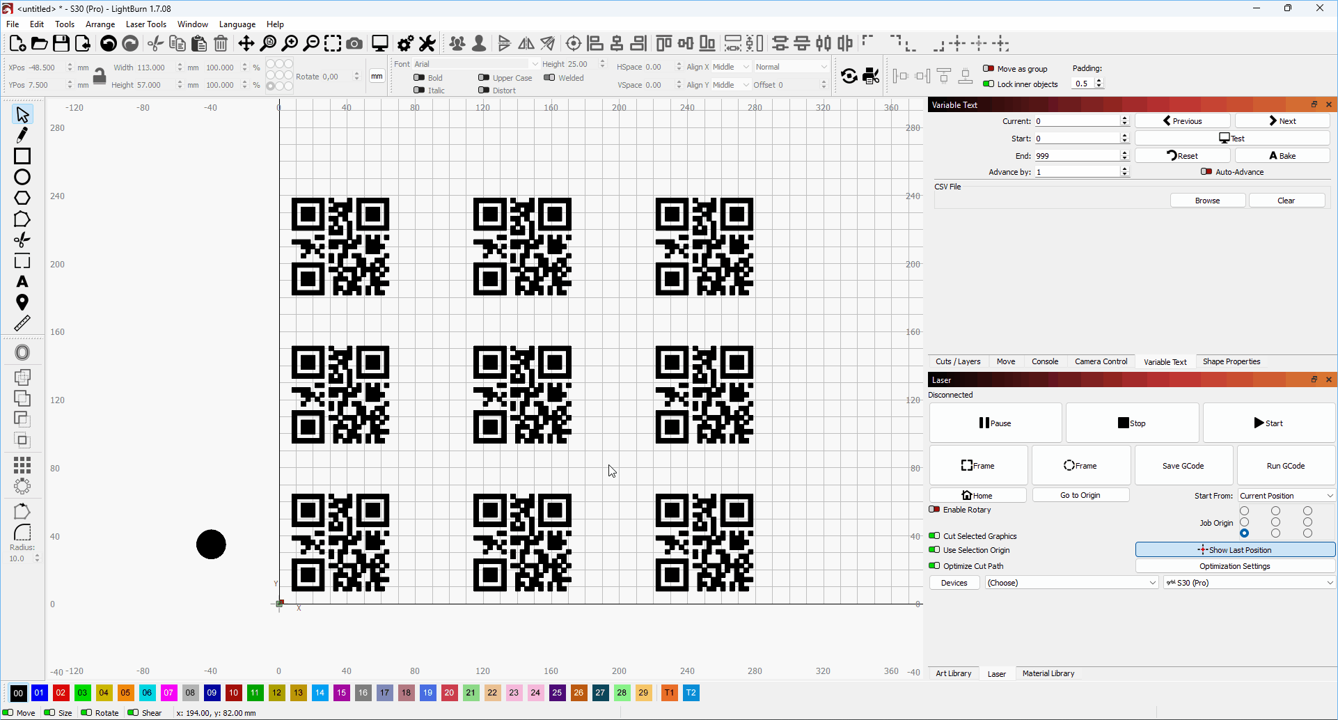

Another thing you could try is to use the (virtual) array feature of LB to create a set of let’s say 50 qr codes at once, create another array of 50 logos with the same array settings (so each will be positioned correctly, and then do only one boolean operation with both layers. But I’m not sure if you can create qr codes as an array and using csv input..
I did a quick video of what I meant. It does work fast if you can create the qr codes based on CSV, which I never used so far (I don’t know if that works).
ArrayQRCodes

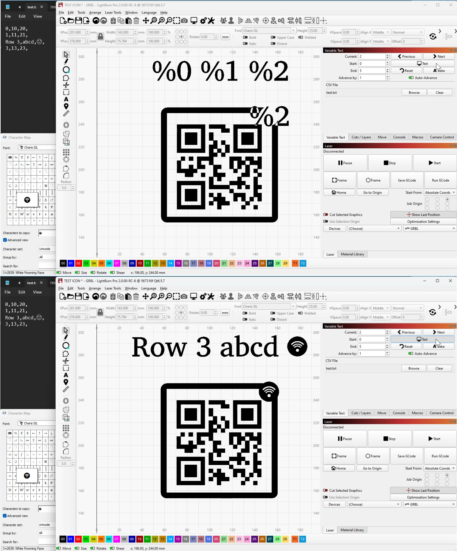

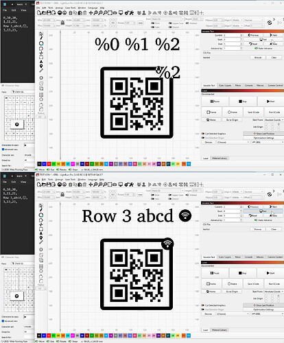

If you need the small symbol to vary dynamically based on the content of each row (if they are mixed up and not able to be batched one symbol type at a time) then for now you could convert your graphic into a character of a custom font, and include it in another column in a unicode supporting csv file.
For example, here I imported a wifi symbol (svg) to replace a character of a basic font using Font Forge. I replaced the ā€˜Frowning face’ glyph as you can see in the character map (but there are plenty of spaces to create your own characters without disturbing the others).
You may not have much space for the QR code, but if you put the symbol to the corner and shrink the QR you will need less error correction so the readability may not suffer.
