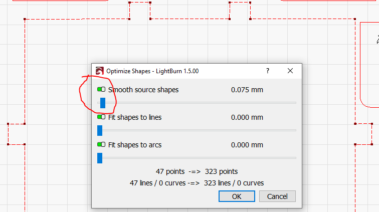

There is (at least) one thing I don’t understand in this dialog, and the docs don’t help (or I missed it).
What is this count 47 points -=> 323 points? Isn’t it supposed to be the reverse, reducing the number of points? Idem for lines.
The “Smooth source shapes” option is meant to smooth shapes, eliminating wavy lines or jagged points (this often helpful after you’ve traced an image), and adds nodes to do so. After adjusting the “Smooth source shapes” slider, you can also adjust the “Fit shapes to lines” or “Fit shapes to arcs” slider, to fit the smoothed version of the shape to lines or arcs.
If you’re just looking to reduce the amount of nodes on rectangles (or other shapes comprised of lines and corners that you do not want to smooth), it’s best to leave “Smooth source shapes” off, and and just use “Fit shapes to lines.”
I see if I zoom in that it does round edges with more nodes, and of course @JTR is right to use the Fit shape to lines to remove nodes in between.
