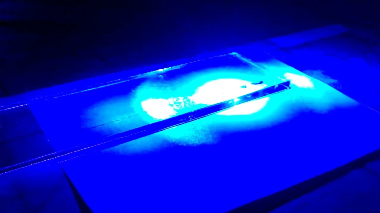

The paper leaves the recording behind the glass, I think for glasses it’s ideally on the outside… when I want to record on the surface, I use permanent black CD ink, but I think any ink will do, Tempera for example, then the recording turns white, I saw people using white ink (the same one used to engrave Norton tiles, with TiO2) and the engraving turns black.

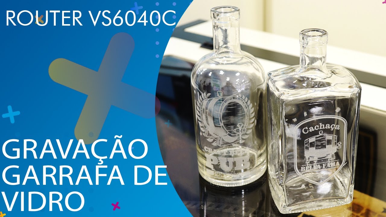

You would have to put the dry paper on the inside, but the recording would be on the inside of the cup, which I believe is not desirable. You can paint the area you want to record with black ink (I use those permanent ink pens to write on a CD surface), the recording will be outside the cup. Watch this video I make in a bottle:
Here the engraving behind the glass, with paper:

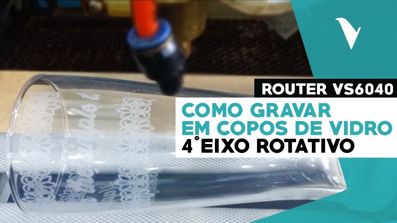

You should be able to engrave on a shot glass, but it’s small and how well it will work depends on the kind of rotary you have and how well you have configured your controller for the rotary.

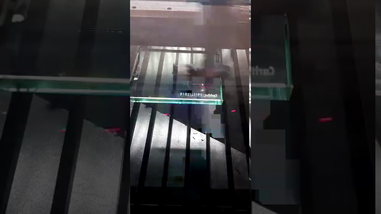

The laser will effect only that type of material that absorbs the ā€˜beams’ frequency. With glass, the IR frequency of the beam will be absorbed, heating the small area of glass and causing it to shatter. Same game happens with acrylic, except the acrylic usually vaporizes/melts rather than shatter.
How deep and big the ā€˜craters’ are depend on power, but mostly speed.
How ā€˜big’ the craters are determine how fine the dpi/lpi that you can attempt.
