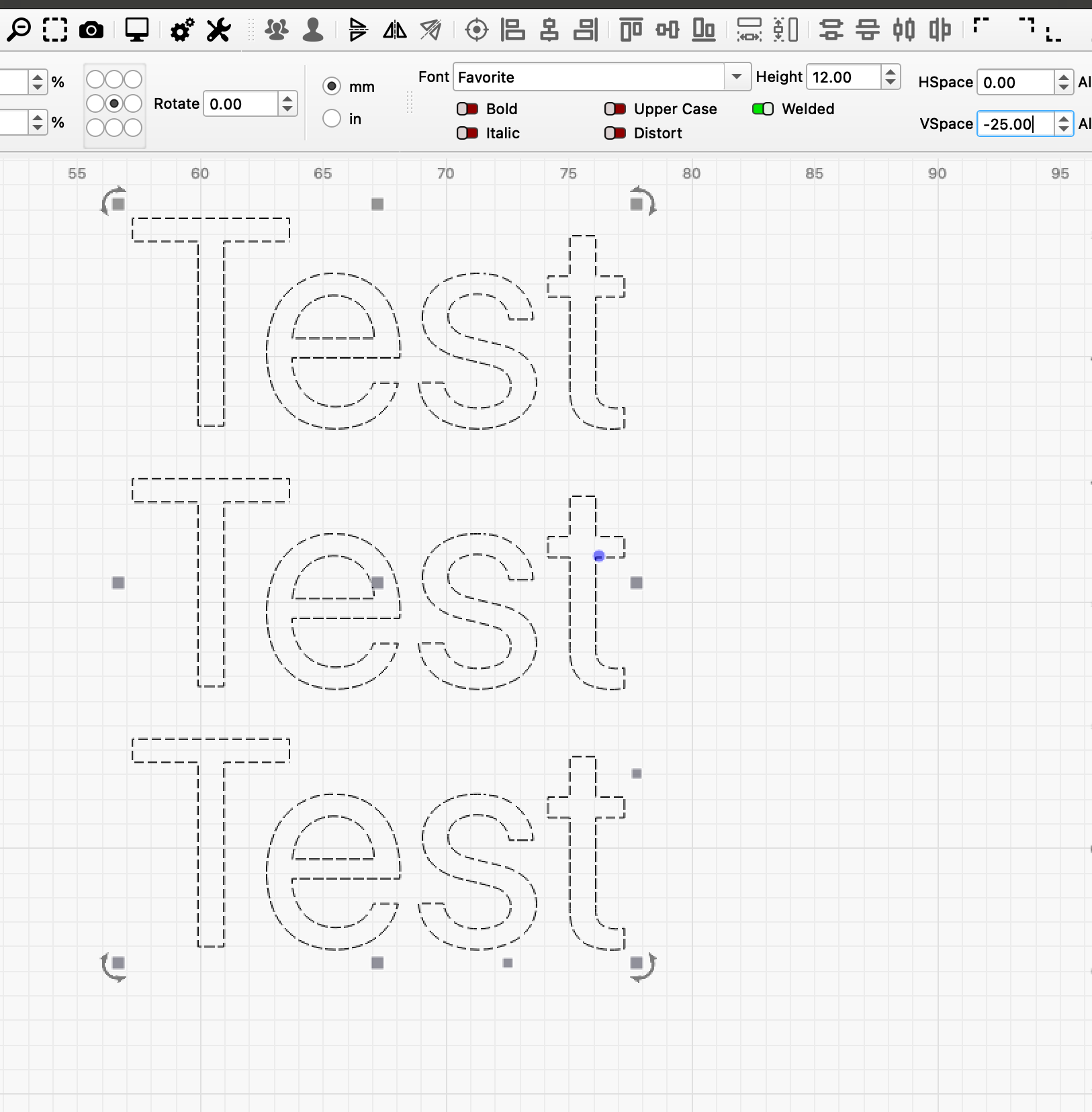

I’m still fairly new to LightBurn and currently using it to engrave multi-line text.
I was wondering if there’s a way to set a consistent vertical spacing between lines of text, without having to manually adjust each line every time the content changes.
Ideally, I’d like to maintain a fixed spacing (for example, 1 mm) between four lines of text. In my current workflow, I’m using a 1 mm rectangle as a spacer and manually positioning each line, which works but feels inefficient.
I’ve attached a screenshot to show what I mean.
Is there a better or more automated way to handle line spacing in LightBurn? Any tips or video references would be greatly appreciated.

This looks like a “variable text” task, can you confirm that?
In this case it is easy to create a template and place the “autotext” in visible or invisible boxes

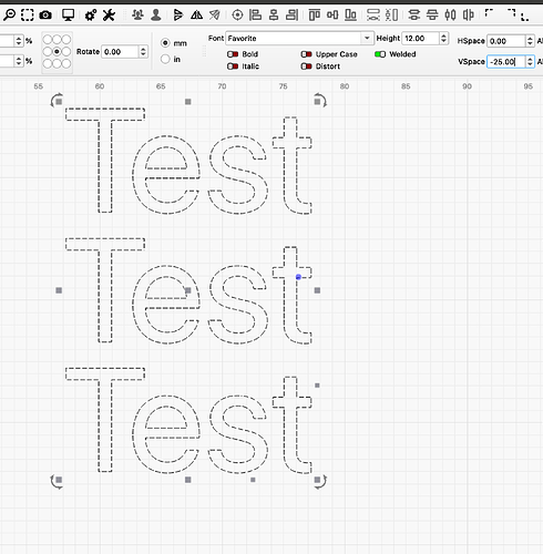

Variable text with line spacing (VSpace), which only needs to be done once in the first field, should meet your needs.
You could also use the Distribute Tools to equally space everything out. Docs section here:

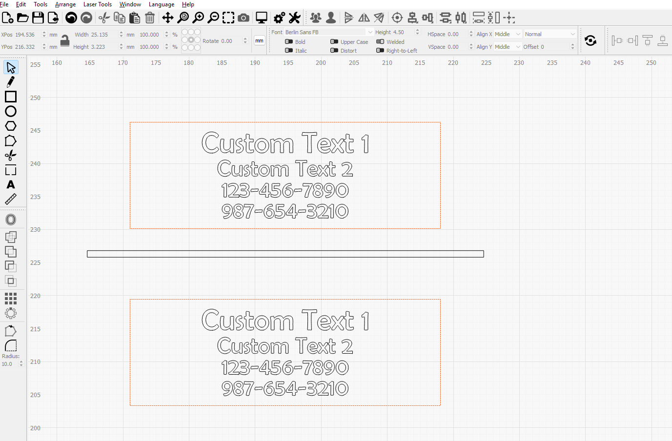

I created a short video to better explain what I’m trying to do.

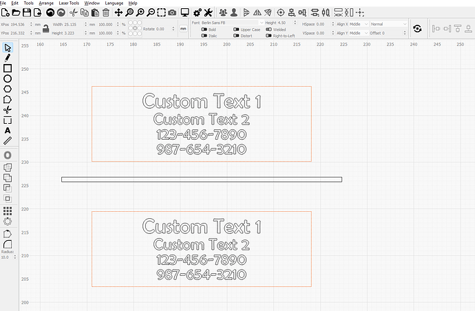

In this setup, I’m using a CSV file to populate custom text inside rectangular boxes. I have five different text entries, and each can contain 2, 3, or 4 lines. I’m aiming for consistent vertical spacing of about 1 mm between each line. To help with this, I used a rectangle that is 1 mm in height as a guide for spacing.
I’ve already uploaded my CSV file, and when I click “Test,” I can see that many of the lines are not spaced as intended. I was hoping there might be a way in LightBurn to enforce a fixed 1 mm spacing between lines automatically.
In the video, you’ll also see me measuring the spacing after clicking the “Bake” button in the Variable Text window.
For now, my workaround is to click “Bake” and then manually adjust the spacing for each set of text.
