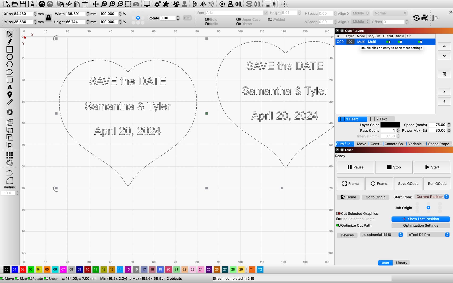

Have a project need to etch (burn) text in the middle and after that, cut out the pattern. I have tried to set preferences ( settings) as i added shape. Or text, but it does not fix the order.
I want text, then cut.
Using 1.4.00
Screenshots are very useful to understand what you’re facing.
What does your design look like and how have you setup your layers?
So I want the heart cut out. And want the text to be a light brown, but not burned all the way through.

NOW however I duplicated the hearts to make 16 per sheet. Somehow the text is not inside the heart now. I thought the first messed up sheet was because the wire loom got caught on the material. It didn’t get caught.

So I have redone the entire project, from individually placing each heart and text, to using the array button.
It is still not aligned properly.

I have tried multiple settings, all had the same result. I tightened the belt, squared up the machine. None of that fixed the issue.
I think i have narrowed it down to the file. I remade a new file. And first run it worked. Then tweaked settings and back to same mis-alignment. Closed down the file, and computer, restarted and ran again, it worked fine. Made a setting change, had the mis-alignment. So I think in making the setting change and running the new settings is where it is going wrong. So I am just saving and closing the file, then opening and running it.
Can you upload a .lbrn file where it’s not working correctly?
