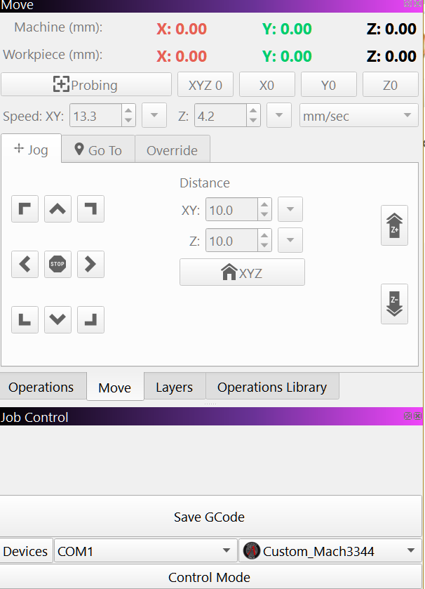

How to setup in mm/Min
My interface for tools is working in MM/sec. I want to work in mm/Min. Where DO i set that up?
Not sure what this is.

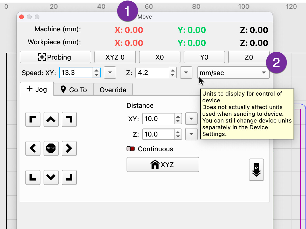

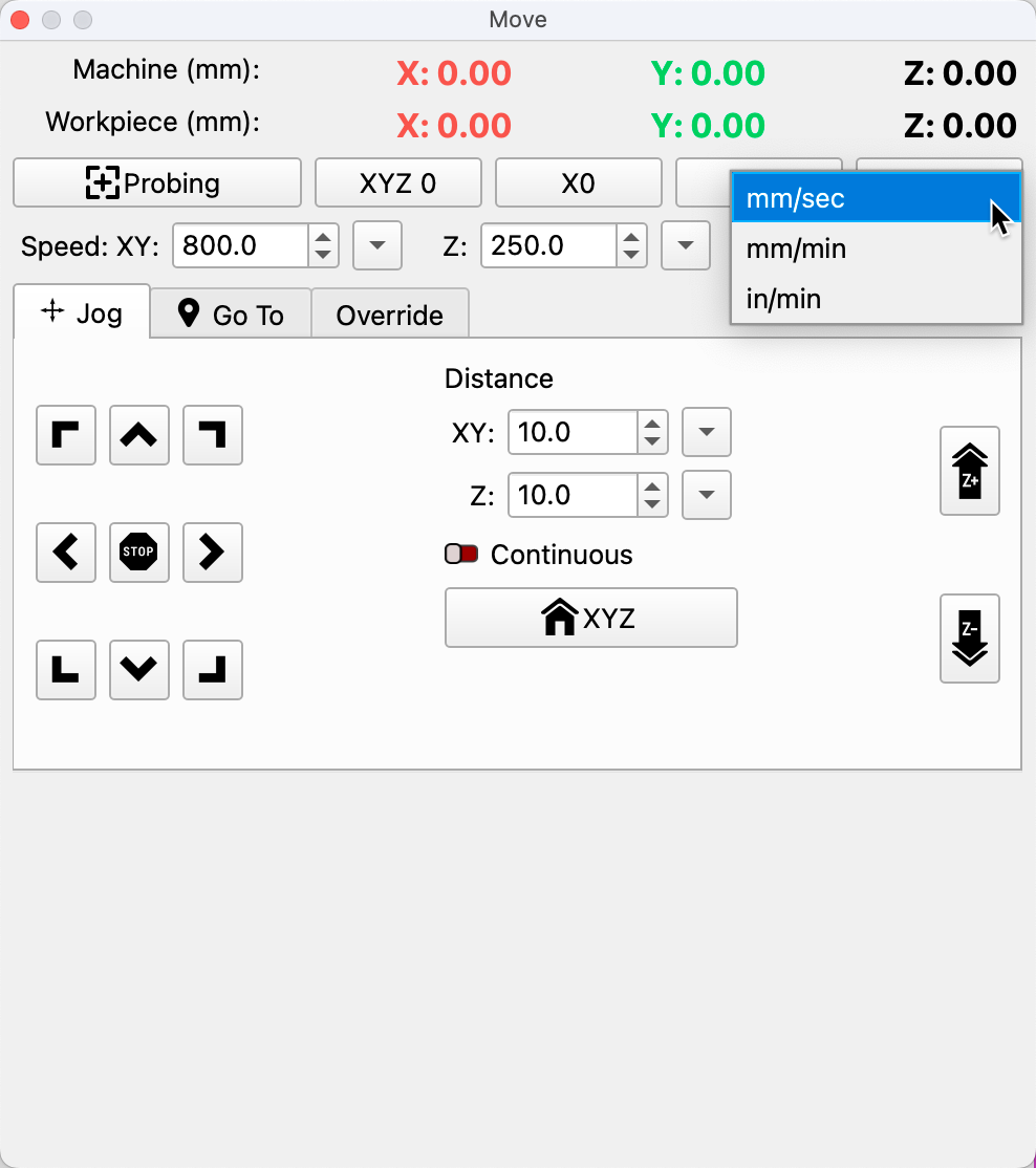

I have found it. It is in the “Move” tab when I am connected to my CNC.
It should be in the Parameter. :slight_smile:
Adding a little clarity for others that might find this post.

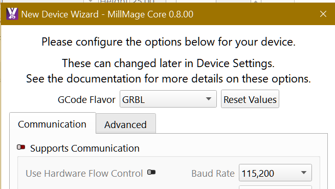

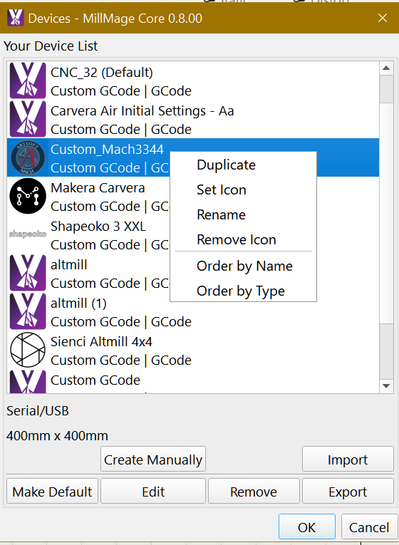

My machine is not supported in the control mode
As a workaround until a better solution Duplicate your Device profile by Right-Clicking it
then Edit and set the Duplicate as GRBL in GCode Flavor
Select the Duplicated Device , set speed to mm/min do your designs set your Operations etc, do a copy of your Project.
Switch to your original Device and the speeds change according to the new configuration, although in mm/sec they are correct. Send the code to the machine and do the Hula-Hula. :grinning_face:
