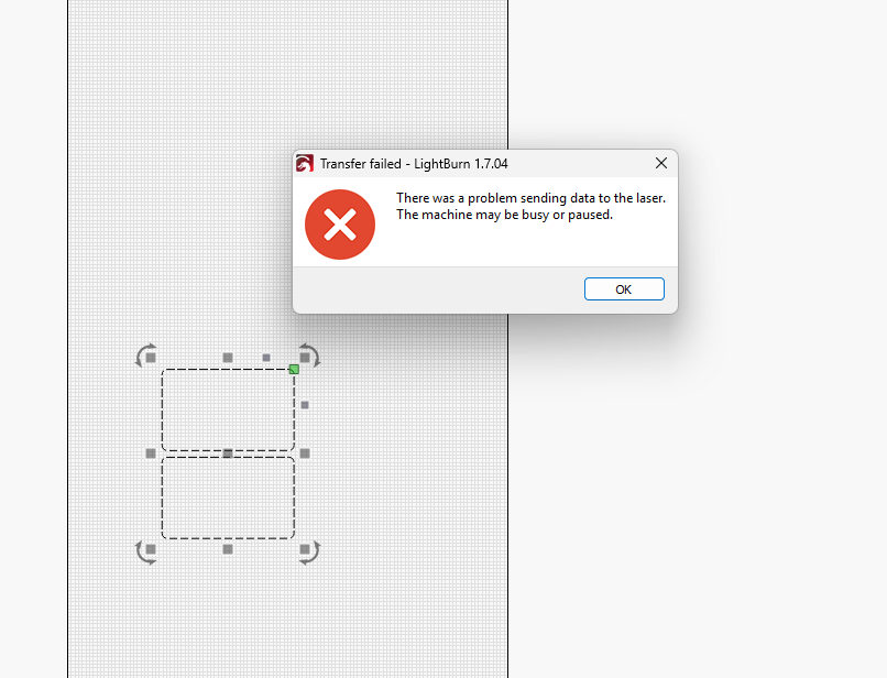

Hello, We are unable to connect our laser (Arcbro 2440mm x 1200mm) (Ruida RDV6445G) CO2 Laser to the PC. We have tried 2 differnt PC’s and also tried the ethernet cable and the usb cable, we also have tried to save a file from lightburn and plug it into the USB on the CO2 Laser it self.
When we sent the project to the laser we get the followinf busy error.
Also, it is still disconnected - have tried find my laser and also manually.
This has been working but since November 2024 we can’t get it to work.
Any ideas please?
First check the status on the controllers keypad LCD screen. This message often occurs when the controller is in an error state. Is your machine trying to home? Did you try and run a cut with your chiller/water pump off?

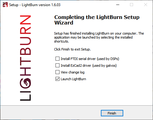

Have you installed the FTDI driver file during the installation of LightBurn? Ensure Install FTDI serial driver is checked…
Just to clarify, in LightBurn does your device show as “Ready” or “Disconnected” on the laser window bottom right.
You have not made that clear.
You mentioned using the USB drive. What happens when you try that? What steps are you going through and what do you see on the LCD screen on your laser cutter?

We have uninstalled lightburn and reinstalled with the FTDI Driver already.
