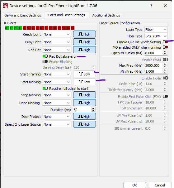

I have a Monport 60W Pro fiber laser that when I frame turns the laser on and marks what I am going to etch or cut. I don’t want it on as it has a red dot that shows me the framing and if my framing is off it marks what I am working on in the wrong spot. I have research this and know there should be a way to turn laser off when framing but mine doesn’t have that setting. Also Move doesn’t have a power level setting either? Thanks

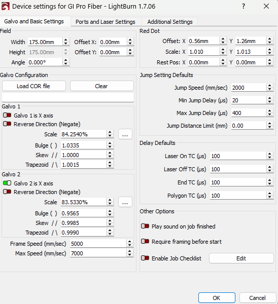

Post screenshots of:
Galvo Basic Settings
Ports and laser settings:
Start with this, See where it leads. Unusual issue.

Ok so here are the software tabs you asked for.

I don’t see anything unusual except for the 2 “Low” are usually “High”. Turn red light always on to off.
I can’t see that any of these should cause trouble but someplace to start. Power the laser off, unplug from wall and usb. Give it a few seconds and re-start.
Plug the USB directly into the computer, if your computer has 2 or more USB ports, plug into a different on. If you have a foot switch, unplug it. If you have a rotary, unplug it.
Probably none of this will make a difference, but maybe get lucky.
You can also turn on Q-Pulse, nothing to do with this problem but it is a feature you may want to use in the future.

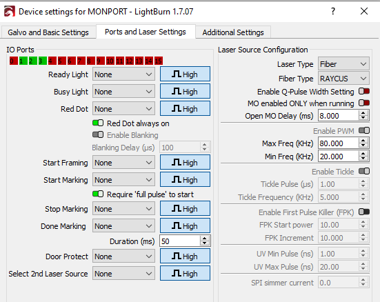

I have the same problem as described in this post, but my Ports look different. What does the coloring mean on the IO ports screen?
I see only three ports green when the machine is on…
This is what I understand, please correct me any one if otherwise. There are 3 inputs, 1, 8, 9 on the BJJCZ board DB15 Con 4. My foot switch is connected to #9 that is General Input 15, and can be associated with start framing, start marking, stop marking, done marking .
I determined this by trying them one at a time.
Also Ready light, Busy light, Red dot, (Red dot from -R source, not from combiner) Door Protect, etc I assume the same will check next time.
Screenshot above I see it is associated with “Start Marking” a common configuration. EDIT: Ready, Busy, might be for the 2 TTL outputs, going to test when open. Can’t find documentation.
Pin 8 and pin 1 can also be connected to momentary contacts and can be associated the same way. Pin 8 is called Remark and pin 1 is called XORG0 but from documentation they are both general input pins, same as 9. Can be associated with any of the inputs. I’ll confirm this next time I have the case open. (I have a use for them). Then there are 2 IO output pins, 2 and 10, that are TTL I have heard of leds etc running off these. I haven’t found a good use yet.
Rest are power, ground, direction, pulse for rotary.
The BJJCZ standard board the PUL and DIR have their own positive and negative, the Lite board which most lasers are built with the PUL and DIR share VCC 5V + as common, which causes some confusion. The color indicates which ones are in use. I’m color blind, cant tell if they are green or red, but what I’ve heard.
Mine shows the first four lights lit 0 through 3. I got in touch with Monport and they had me send the same screen as above. They told me to change red dot to 0. Didn’t change anything so now waiting for their response. Will let you know what they say.
