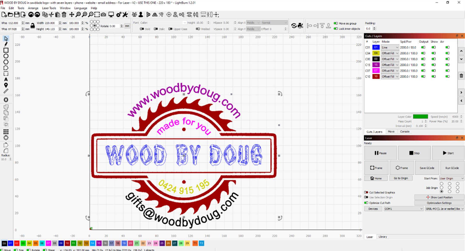

I used to be able to assign a scan angle and cross-hatch, but for some reason they are no longer available (greyed out) what have I done ?
I can’t find where to turn them on?
Also, I now have no more “Multi” options? I have the latest update (1.2.01)
I’m not running in Beginner mode?

Hi, forgive my silly question about not being able to assign a scan angle, (I hate to admit it but I had selected Offset fill, thinking I had selected fill?
But Multi has me confused, when it first appeared, after an update, I had about six tabs that were Multi, Now (on my computer in the house) I only have one Multi Tab, (#5) yet on my laptop in the workshop, I have no Multi Tabs, when opening the same file?, (both running latest versions)
Pic attached of the house computer screen,

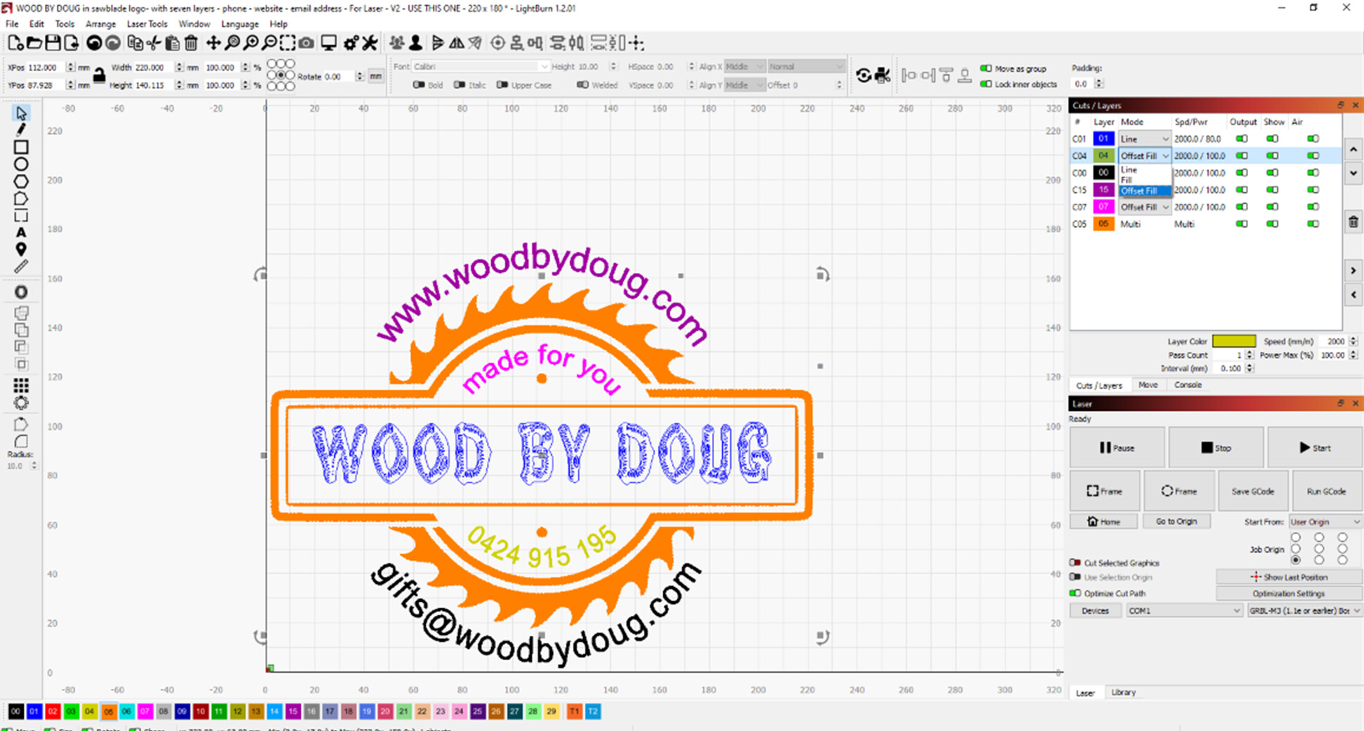

Again for reference, Multi shows up when you have multiple sub-layers defined for that layer. In the screenshot example you have 1 Fill and 2 Line.

By “Tab” I’m referring to the coloured tabs along the bottom of the screen, (they probably are “Cut Layers” ?) When we were first introduced to Multi (with an update) I had about 5 or 6 of those Tabs that would give me the option of Multi, the other Tabs only gave me the option of Line, Fill, or Offset Fill. But now (on the house computer) I only get one Tab with Multi. (#5 - Orange Tab) On the Workshop computer (same version) there are no tabs offering Multi.
I’ll attach two screenshots here (house computer) The first one shows the sawblade in red (#10 - offset fill) The second one I selected #5 - orange and got Multi, you can also see in the dropdown menu on right hand side, the other Tabs only offer Line, Fill, Offset Fill.

Okay. I see what’s happening. I think this is an understanding thing.
The defined mode for each layer (or tabs as you call them) are not pre-canned. Also, except for those layers that are saved into the design, each layer will retain the last used set of parameters. Every layer can be customized so you can change between line, fill, or offset fill.
Multi is not an option that you select. It automatically will display if you have opened up the cut settings by double-clicking the layer in the Cut / Layers window. If you have multiple sub-layers defined there the main Cut / Layers window will show multi.
You can add more sublayers by pushing the plus button in the cut setting.
