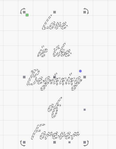

How can I select the word Love to give it a slant; just playing around. And to move words closer together? Lucie
This should help.
You can put the word love in it’s own text box, then you can manipulate it separately from the rest of the lines.
You can also convert the text to path.
You can make more than one text window. Then you are free to apply effects to the separate windows individually.
@Lucie Nice quote.
Thx. New to Lightburn and was trying to figure out how to “ungroup” text so I could reburn individual letters if needed. This works, just a few extra clicks.
I agree. Convert Text to Path will separate the letters in a word. Then you can move them as needed. But, after doing that they are no longer letters any more. Just individual design elements.
