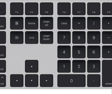

I think the problem is that i am on a Mac with an Apple Magic Keyboard, which, despite having a numeric keypad, only has numbers, no arrow keys – and no Num Lock key.
If the development team have possibility to test this configuration, using this keyboard, I think the problem will be evident.

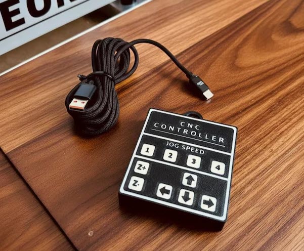

Try this from Etsy. Got one for my pro and i love it. Can Jog X, Y, and Z axis and set speed of jog.
Just plug into a USB port and go to the Jog screen In Carbide Motion. Has a 2 meter cable.
Shapeoko/Nomad Jog Control | Carbide Motion - USB Controller with 2 meters Cable - Plug & Play - Works Mac+PC
Try one of these. I got one for my Pro and I love it.
https://www.etsy.com/listing/1726484984/shapeokonomad-cnc-jog-controller-carbide?ref=yr_purchases

Because Apple Magic Keyboard numeric pad does not offer “arrows icons” and does not have Num Lock key, I suspected that it wasn’t working for that reason…

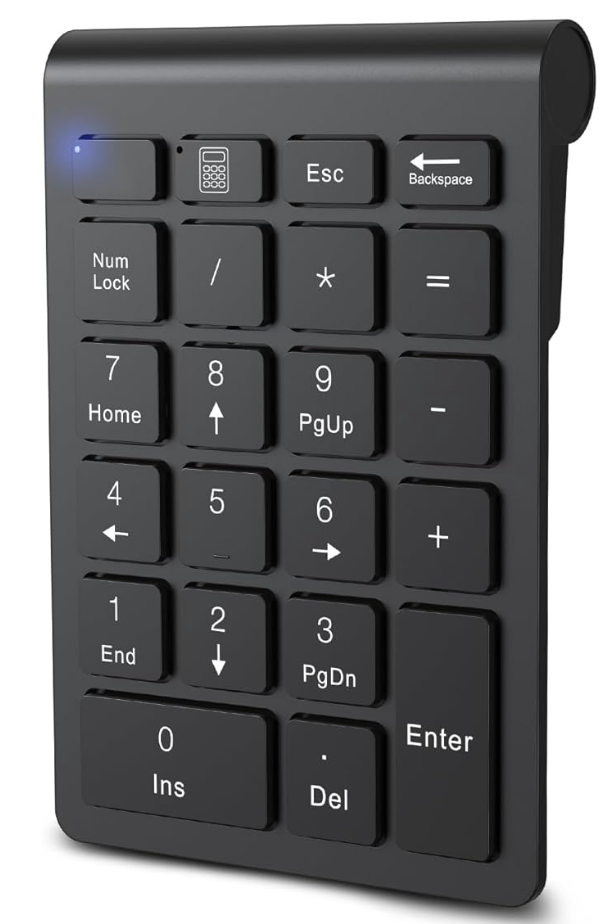

So I have purchased a dedicated BT numeric pad:
which have arrows icons and have Num Lock and works exactly as expected (numeric values/arrows depending by Num Lock) in my Apple Mac Studio for any other applications, except LightBurn and MillMage, where no jog function is triggered.
I think this “jog by keyboard” feature in Mac environments is definitely buggy and I would expect the development team fix it.

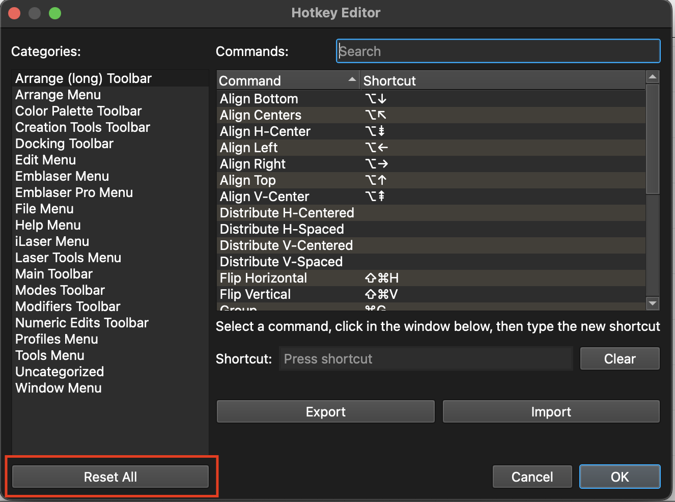

Dear all,
I am not sure to understand why, but looking in the menu File > Preferences > Edit Hotkeys and performing Reset All command, it start to work, on both Apple Magic Keyboard and the numeric external pad!
Doing the same on MillMage and Lightburn, now it works on both!
It seems to suggest I’ve changed the settings somehow, but frankly, I don’t remember to be explored that Hotkey Editor before today.
Anyway, it works now!
