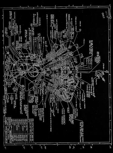

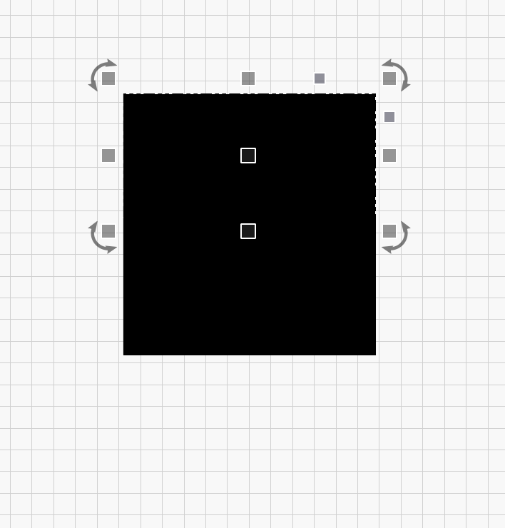

I am trying to cut this in half with targets and i am doing as a negative so it only prints the white
Image files act different than Vectors with cutting shapes. See docs.

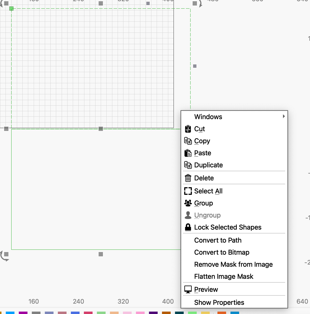

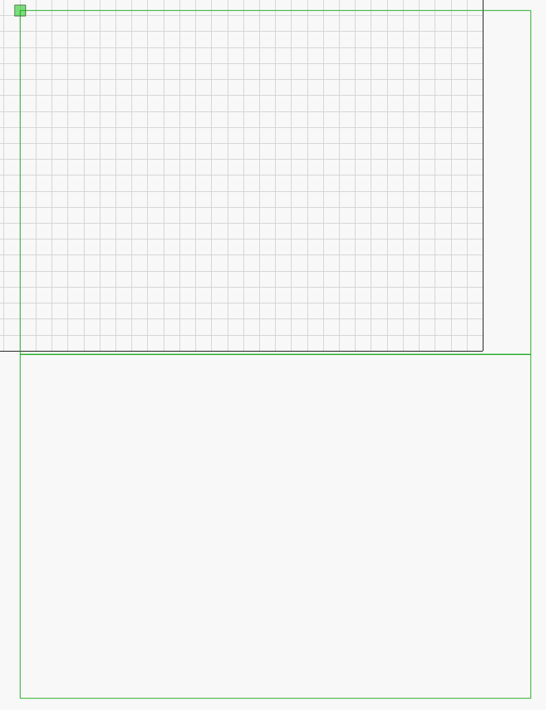

Try this. Make 2 boxes exactly the width of the file and 1/2 the height. Align them to the image, one top, one bottom. Temporarily hide the image and verify that they are touching in the center and aligned on the edge.
Show the image then duplicate it. With one copy of the image selected, hide the image, shift click the top rectangle, right click and choose apply mask to image then right click again and choose flatten image mask.

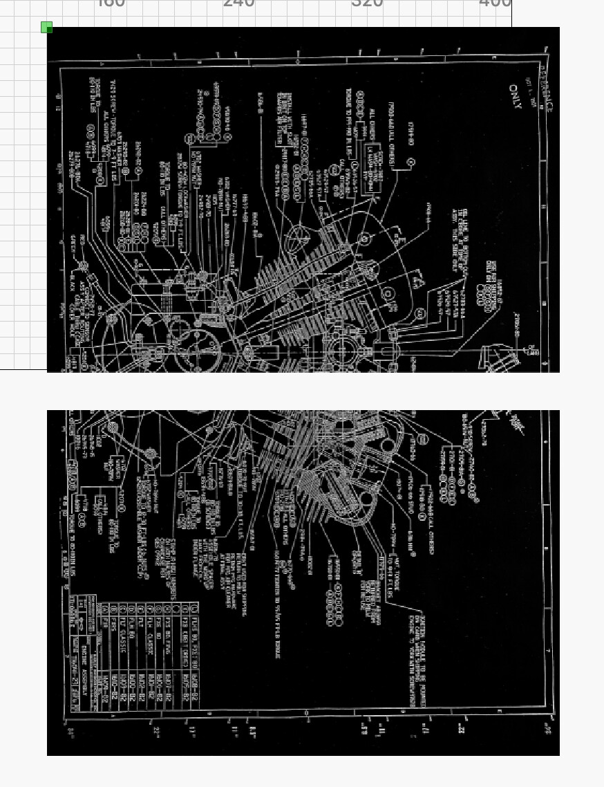

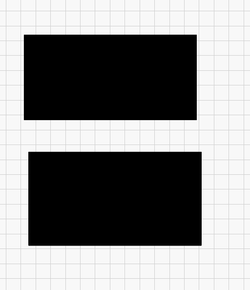

Show the image layer, select the bottom half of the image that you didn’t apply the mask to, hide the image, shift select the remaining rectangle, right click and choose apply image mask then right click again and choose flatten image mask. Show the image. I moved them apart to show they are separate.
You now have the image split in half and you can place targets as needed for print and cut.
