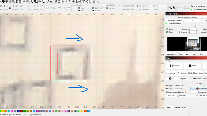

I am experiencing drift in the drawing between the camera (work area) and the laser
Hello. I calibrated the camera well. As you can see from the screenshot, I filled the frame, but when I took the photo of the work area again, there are differences between where I drew and where the laser drew. How can I fix this?
Under Camera Controls, use the Shift Controls
It should show you the results, live

I use Shift Controls under Camera Controls, you must have seen the values ​​there. After drawing the frame, when I update my work area by viewing the overlay, the frame drawn by the laser at the bottom is shifted again. I don’t think the problem is with the shift controls. Is there another setting in the program that I don’t know about? Note: I save the settings after using Shift Controls every time.
The camera system under LightBurn is very sensitive to calibration and bed height (focus camera to surface material). Changing this distance, even just a little bit, will cause this inaccuracy. You will get the same error when the 4 marks are not hit very precisely at the last part of calibration, the image becomes slightly distorted and this can cause this inaccuracy.

As you said, can we make the camera settings like this then? For products with different thicknesses, for example: 3mm plywood Shift Controls Y= -1 X= +2 \ For leather with a thickness of 1.2 mm, we make X=2 Y=3 and export the camera settings according to the thickness of the products separately. If we import the camera settings when we will work with leather or plywood again, can this problem be solved?
Shift controls are only intended for fine adjustment, e.g. with a large machine bed there will always be some distortion/fisheye effect in the outer areas. I currently have a deviation in the outer areas that I can eliminate with +/- 0.2 to 0.4 mm.
