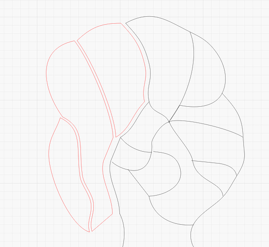

I am having trouble with preparing pictures to use in marquetry
I have tried Inkscape and gimp along with lightburn. How do I break apart this drawing to cut individual pieces?
To be able to divide the image into individual parts, the open shapes must be closed and the rest divided into individual parts. In this case, it requires a lot of manual work, but it can be done.
A small example is the head, here I used node edit, duplicate, break apart, delete and auto join…

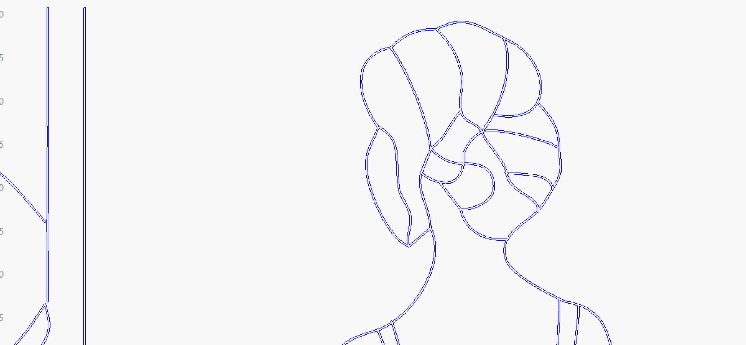

Try this
In LB, convert the vector into a bitmap then trace it back to vector
I tried this on a less complex image and it worked.
Let us know if this works or not
I`ll first try a small Offset (0.05 or 0.1)
Then select the shapes as you wish.

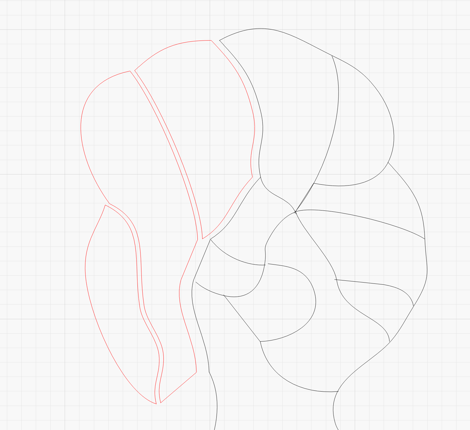

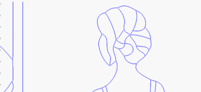

I was picking at this yesterday to tweak some of the lines..
This looks like the plan.
Bill
What thickness ‘Kerf’ does that black line need to be.
