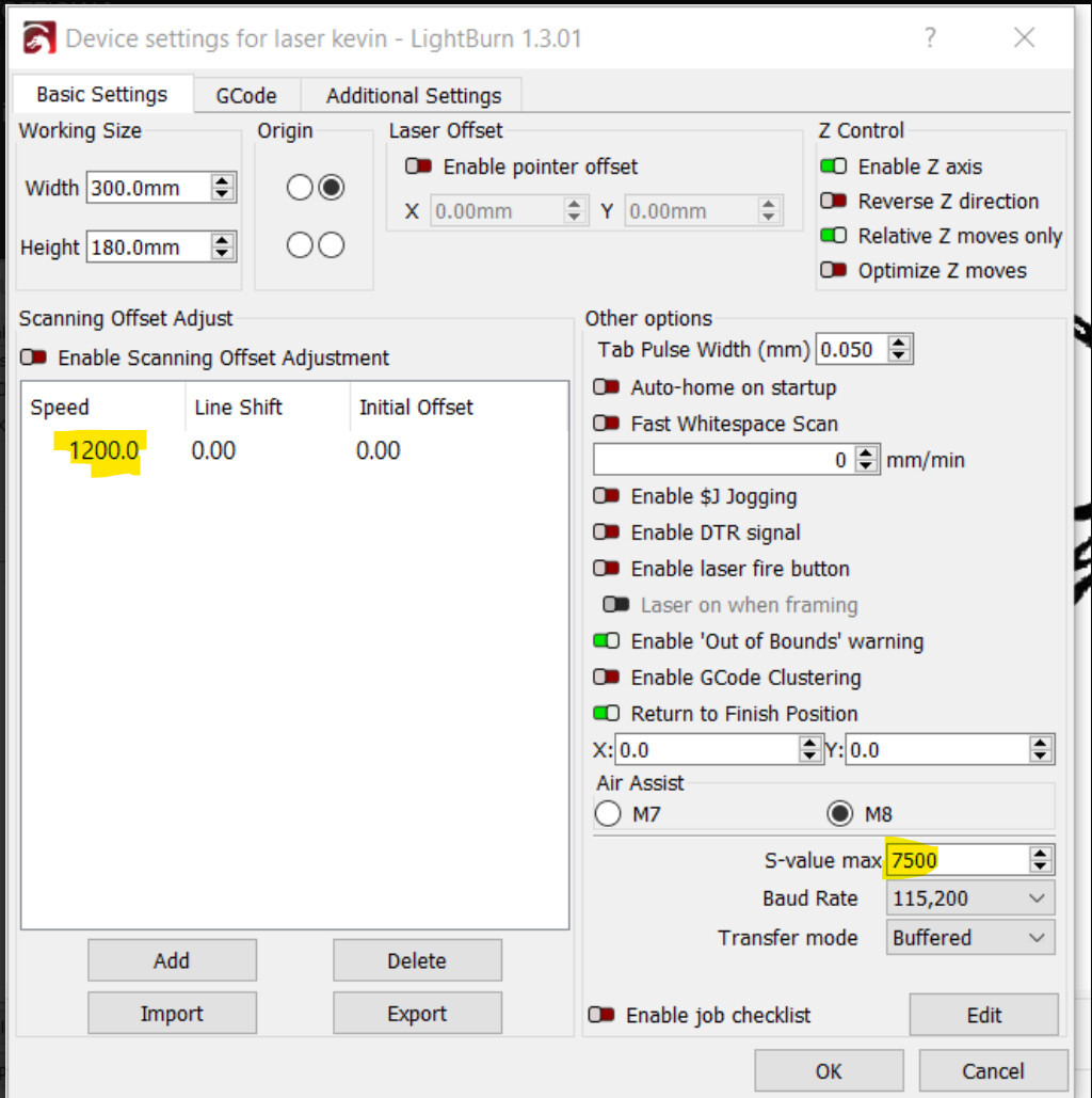

I just bought my first machine ever. I didnt do any research or know what im doing, I spend every weekend firguring things out and trying to get my first print done.
But for some reason, when i try to print something. My engraving does work, the laser does do something. But I don’t see it burning anything and it doesn’t get hot. I have no idea what setting to change or how to fix this. im sure that my machine is build correctly so it must be software
I googled and to burn wood i should set the power to 75% and the speed to around 1200. So I did that but still nothing.
Here are my settings:
Does anyone have any advice on what i should do for me to be able to atleast get my first print done ?
I have an S3018 CNC Engraving Machine
and a XTS05 laser and it’s 5.5W
Thanks in advance

I can see some of your settings are probably off. You should go over how to setup your grbl machine and how the coordinate system works…
This is a learning curve and you need to read and understand the documentation. If you read it and can’t make it work, then we’re here to help…
I can see your S-Value max is 7500, which should match $30 value of your machine, Lightburn recommends a different value… This effects how the laser power is controlled. This is explained in the setup link I posted.

Are the highlighted areas the way that you’re setting 75% power and 1200 speed?
If so, you’ve misattributed those fields and how cut settings work.
First you need to fix the Device Settings.
  1. remove the Scanning Offset Adjustment of 1200 that you added
  2. For “S Value Max”, first go to Edit->Machine Settings and lookup the value of $30. It’s likely 1000 or 255. Take that value and replace 7500 with that value
  3. I suspect your origin position is also incorrect but don’t change anything else for the moment. If your engravings end up looking rotated 180 degrees then change origin to bottom-left position.
After that, I highly encourage you to read through the beginner docs on how to use LightBurn. It steps you through the basics which I think will be useful to you.
