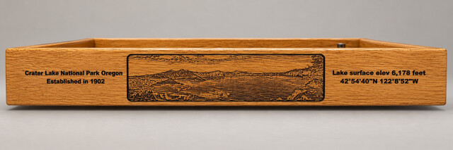

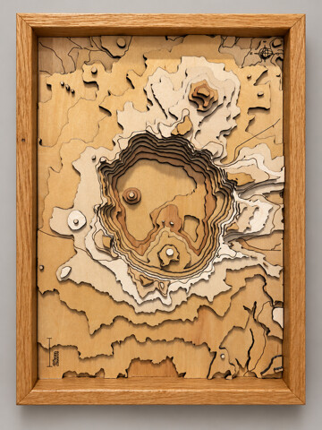

ONG the Crater Lake got my attention. I know a former USFS Ranger who was stationed there in 60s. I should make him one of these.

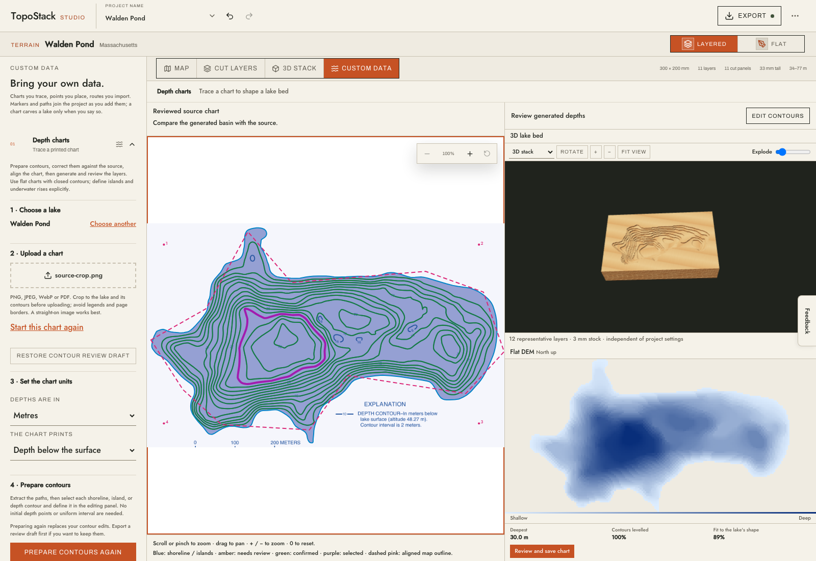

Version 0.5.0 is live now, with the headline feature being a new Custom Data section and the ability to create custom depth maps from 2D chart data.
Custom Lake Depth Map Guide
How Chart Tracing Works (technical explanation)
This turned out to be a fair bit harder than I expected, and is highly dependent on the quality of the input data. Complex depth charts will need some clean-up before trying to import, or the contour editing process will be a little painful in TopoStack.
I plan to improve this in future versions, but I’m shifting my focus elsewhere in the application near-term (automatic nesting using sparrow is coming next).

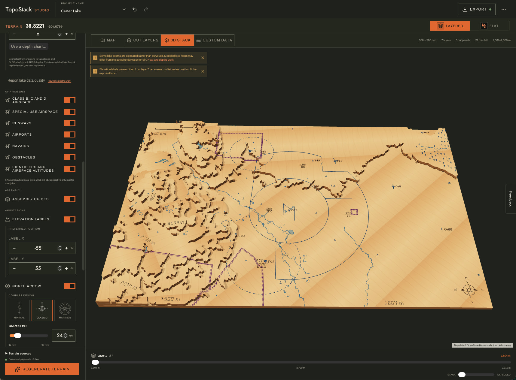

Version 0.8.0 is now live and features aviation data layers (FAA only currently).
This is a feature that is probably a little niche, but it’s one I personally wanted for some of the projects I have in mind (and adding what I want is part of the point of building it myself, haha.) Hopefully someone else finds it cool or useful.
The next iteration of this idea is to represent airspace in 3D using translucent acrylic, that feature is in development now.

Thanks Chris. I made Crater Lake for a friend who was a ranger there in the 60s. Now making one for my sons where we lived when they were young & playing in the creek.
That looks awesome! Thank you for sharing, it genuinely made my day to see this.

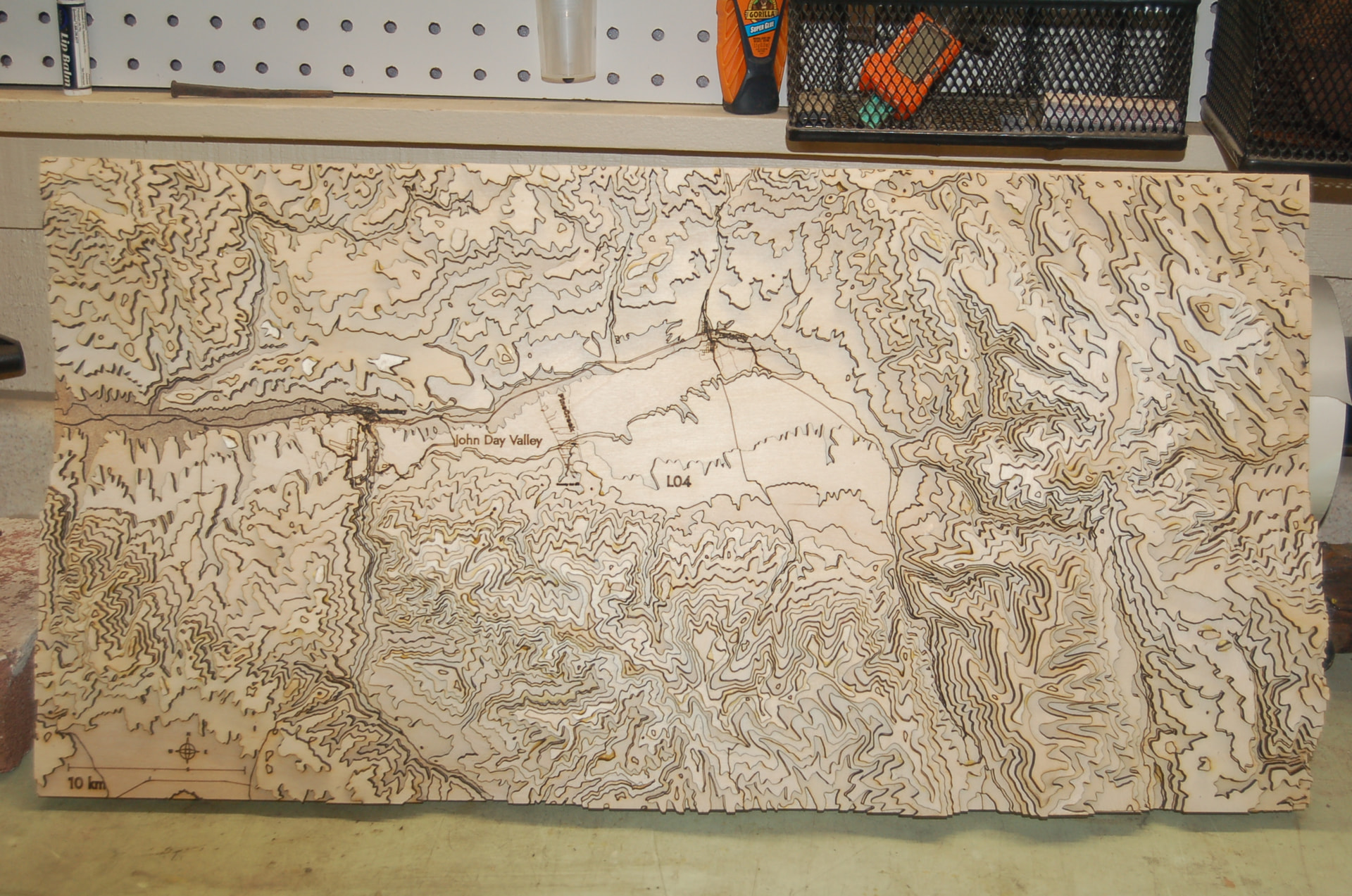

Don’t look too close. The ones for my boys will be far more precise. Still don’t know how LO4 got there. Dead center is Pine Creek and a very small burn where I built the house. Tks again. R
LO4 would be the layer identifier but it should be placed only within non-visible glue areas. It doesn’t appear that you are missing a layer on top of it at a cursory glance, but it’s hard to say without seeing the project files.
If you are able to send me the project master.svg file (in a private message) I can take a look and make sure this isn’t a bug in the placement system.
