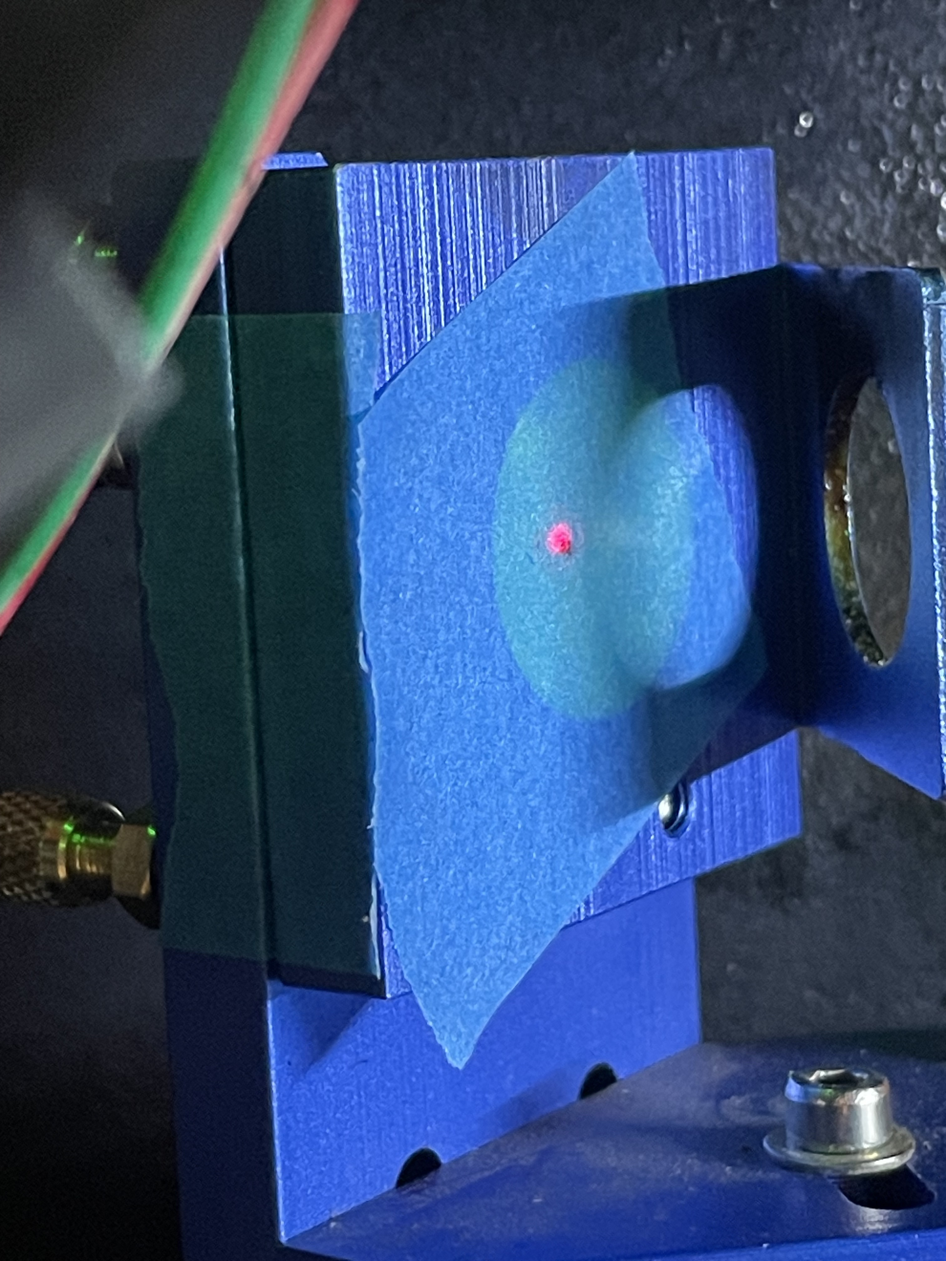

Hi guys, Im turning to you after researching almost all alignement related topics and ytb videos and I just cant get it right. So yea I have as I read here classic fourth corner, but thing that I found out with my makeshift reverse alignement tool is that also my the dot from laser pointer travels and making loops around the near and far corner of the X-axis (M3 to M2). I tried thightening laser head or loosening and rethigtening belts but dot isnt stable, could there be some bumps on the actual rail or something? Should I buy a new rail?

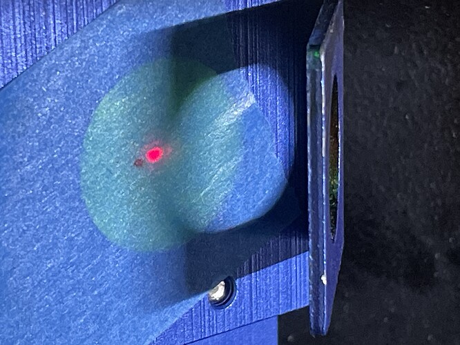

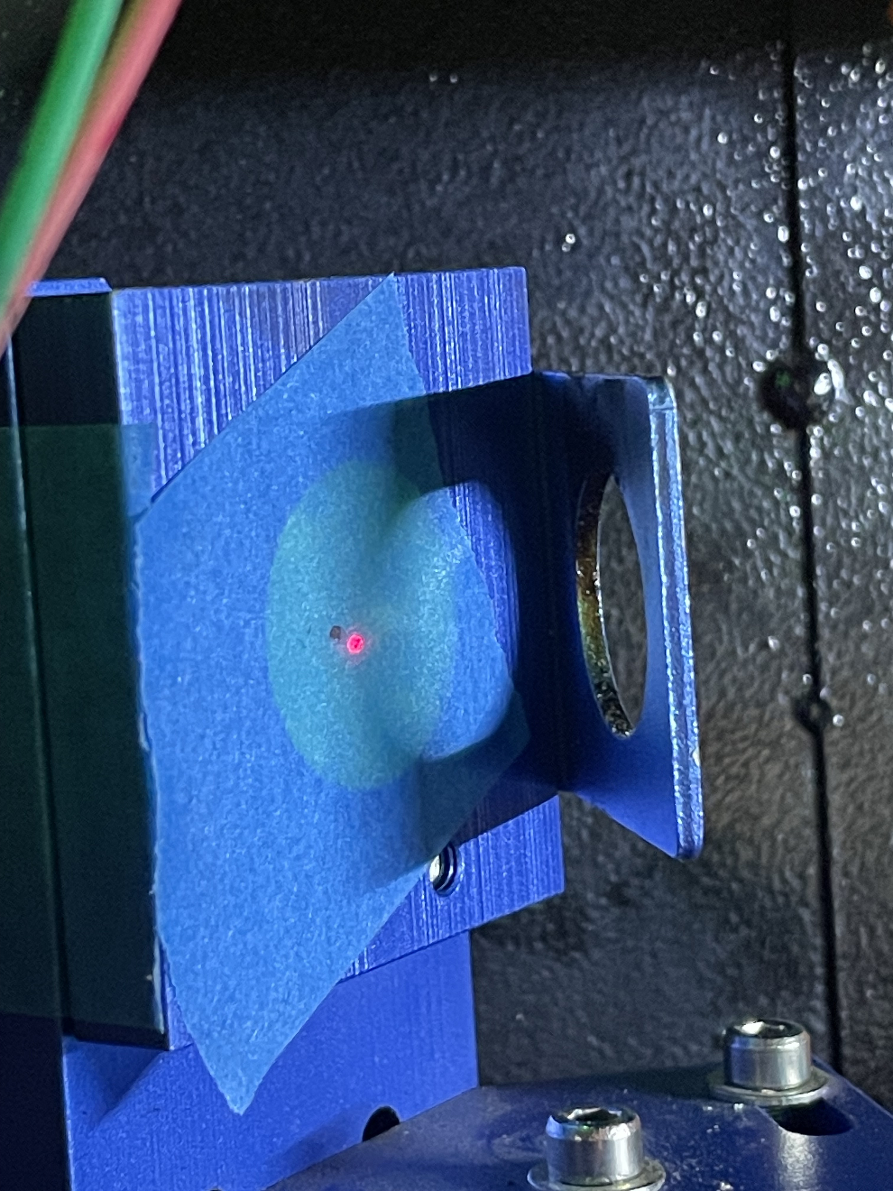

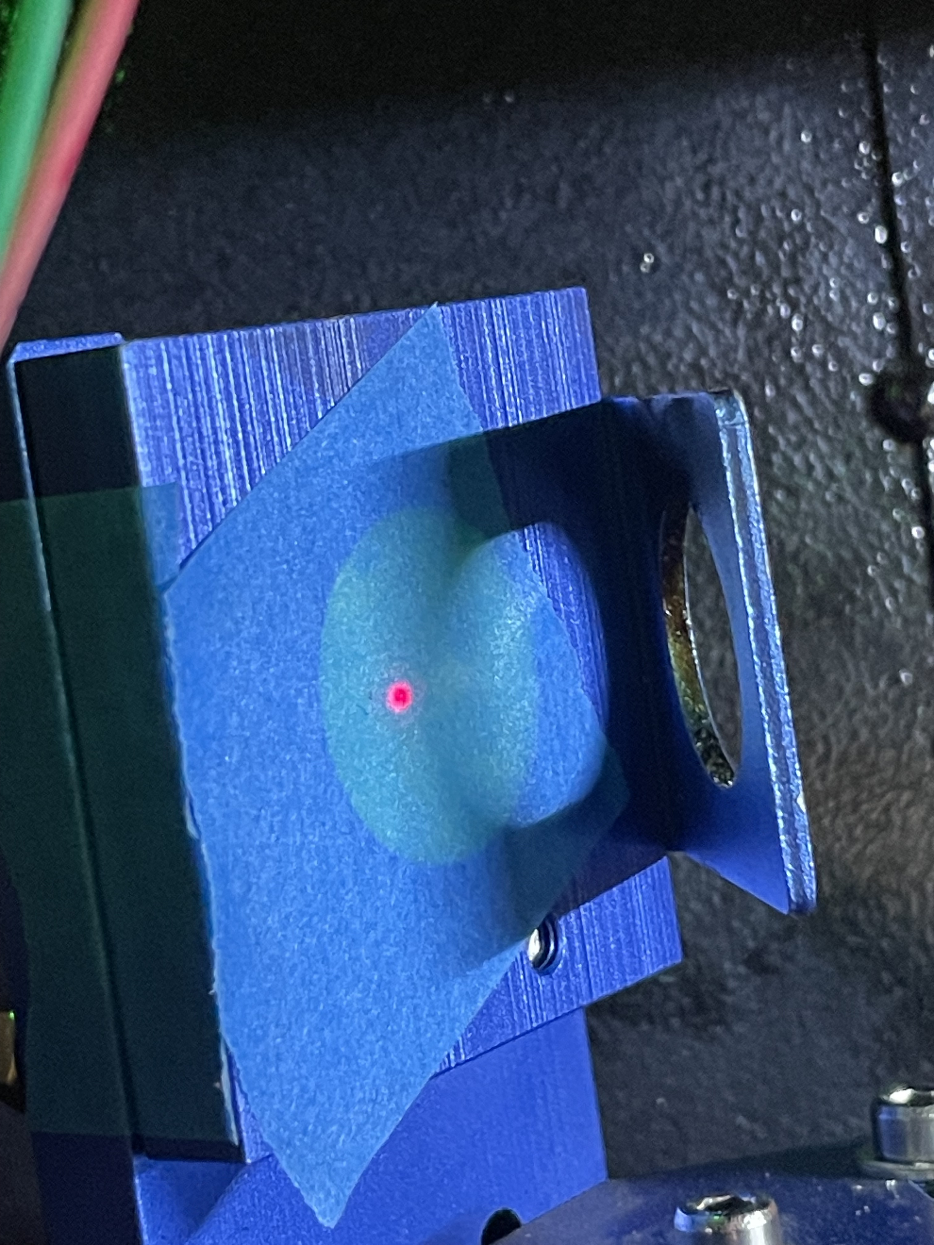

Well here some pics of what I’m talking about. The ones where the dots kind meet are at the end and the other is right after I start travel from one side to the other. I’ll post some video and share link here so you can see exactly. And it doesn’t look like much but it really is
here the travel from near to far between M2 and M3. Mirrors brand new, from cloudray hardly used.

So it appears that the laser pointer coming from M3 drifts along M2 as you move the X axis. That means the beam is not traveling parallel to the X axis. Just adjust M3 until the dot doesn’t move. Then move M2 until the dot is centered in the mirror. Similar process M2 to M1.
I also never use tape. You should be able to see the laser pointer on bare mirrors.
Also my experience is that you don’t need to get everything exact. Some drift is acceptable. I would have no problem with the videos amount of dot drift over the range of motion.

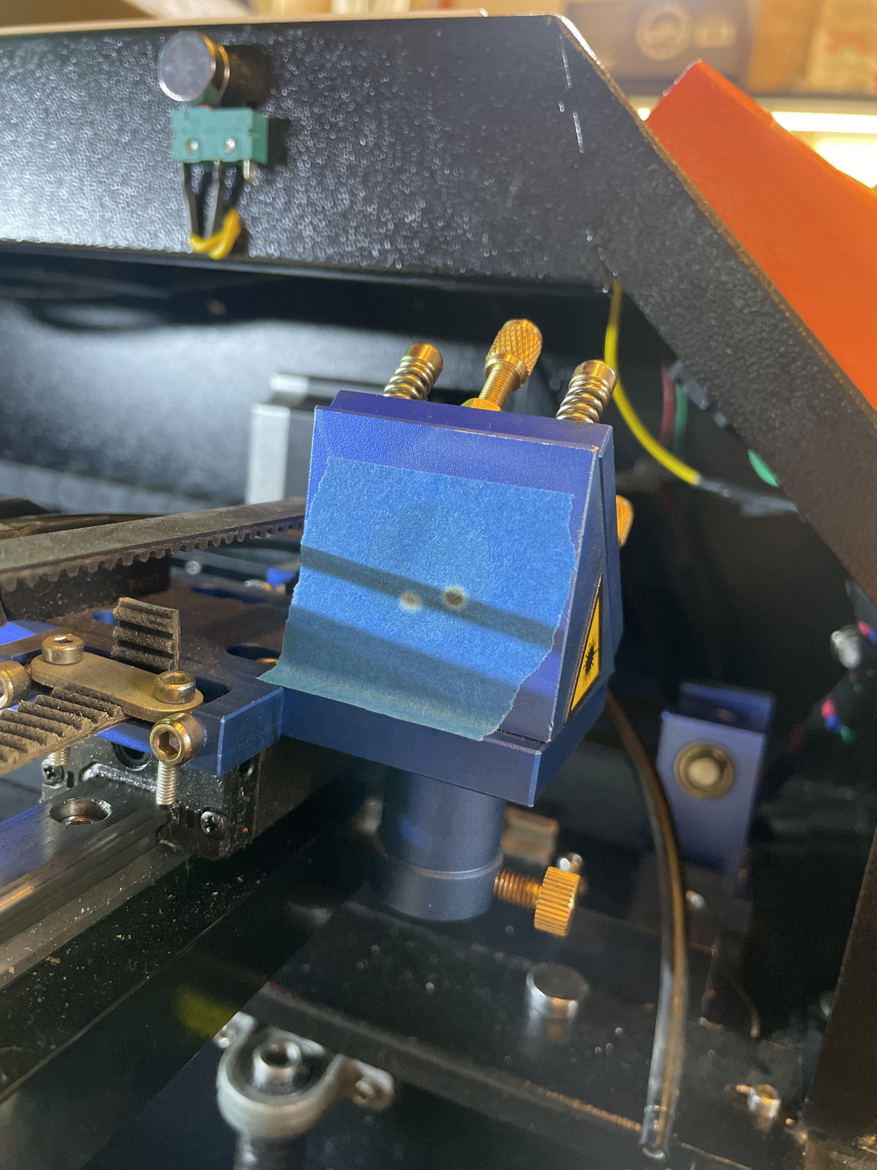

So I did watch them and gotta say that Ive never seen more detailed guide awesome. I went back to tápe method and I manage to get M1 and M2 visibly fine but the far corner is like 4,5mm off the near corner diagonally to the up right and I’m just not able to correct it on mirro 1 as described small movements doesn’t do anything and big adjustments ofc destroys whole process. And it just moves along with the slight adjustment. And no matter how I set(move) M1 this 4,5 mm stays there
Is either beam going down the center of the lens tube?
From the looks of it, both of them are pretty far off…
I don’t know if your head is like my original, but it’s hole is off center from the lens tube.
