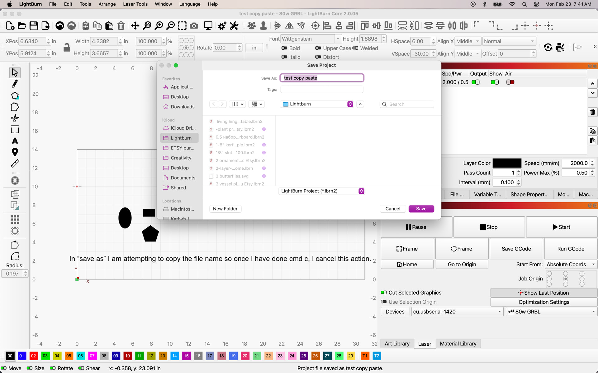

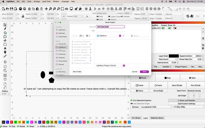

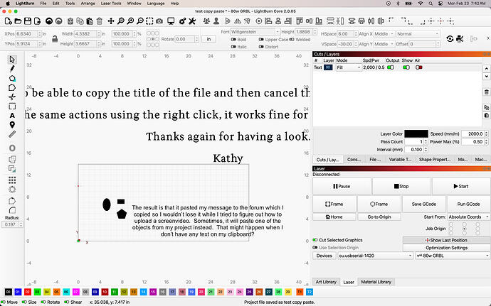

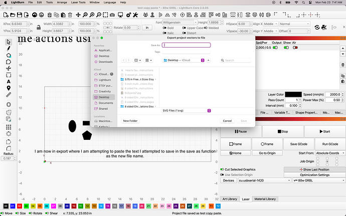

Hello and thanks for trying to help. I’m unable to upload a screen recording of my issue so here are a series of screenshots with notations on each and in case you can’t read those, here are the steps I took.
I created a LBRN file and saved it. I then go to “save as” to be able to copy the title of the file and then cancel the save as. I then go to export where I want to paste the file title to save in the new format. The text does paste in the project but not in the file name field as it used to.
If I do the same actions using the right click, it works fine for me but not with shortcut keys.

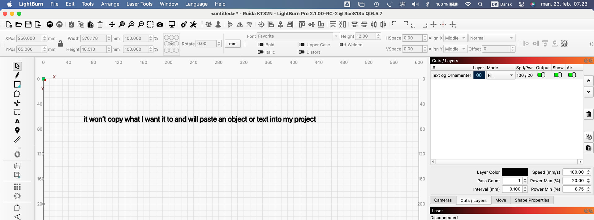

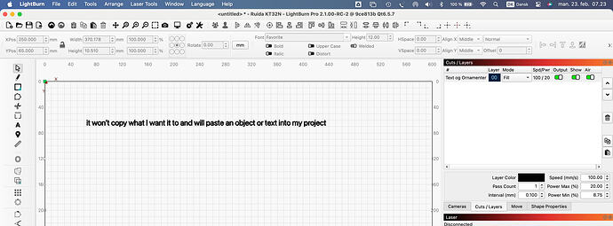

I’m on MacOS Tahoe 26.3. I went through your procedure and confirmed it is functioning as stated. I also tested the same process in Bambu Studio and Libre Office. Both programs operated exactly the same (Cmd-V, Cmd-C not working in the save as dialog, but right click is). I then tested in Affinity and Cmd worked there.
So what I’m saying is it is not an issue localized to Lightburn. Other programs respond the same. But, since it works in some programs, there must be something that could be changed. Now, how simple that change is to make, and whether the devs find it worthwhile is up to them.
