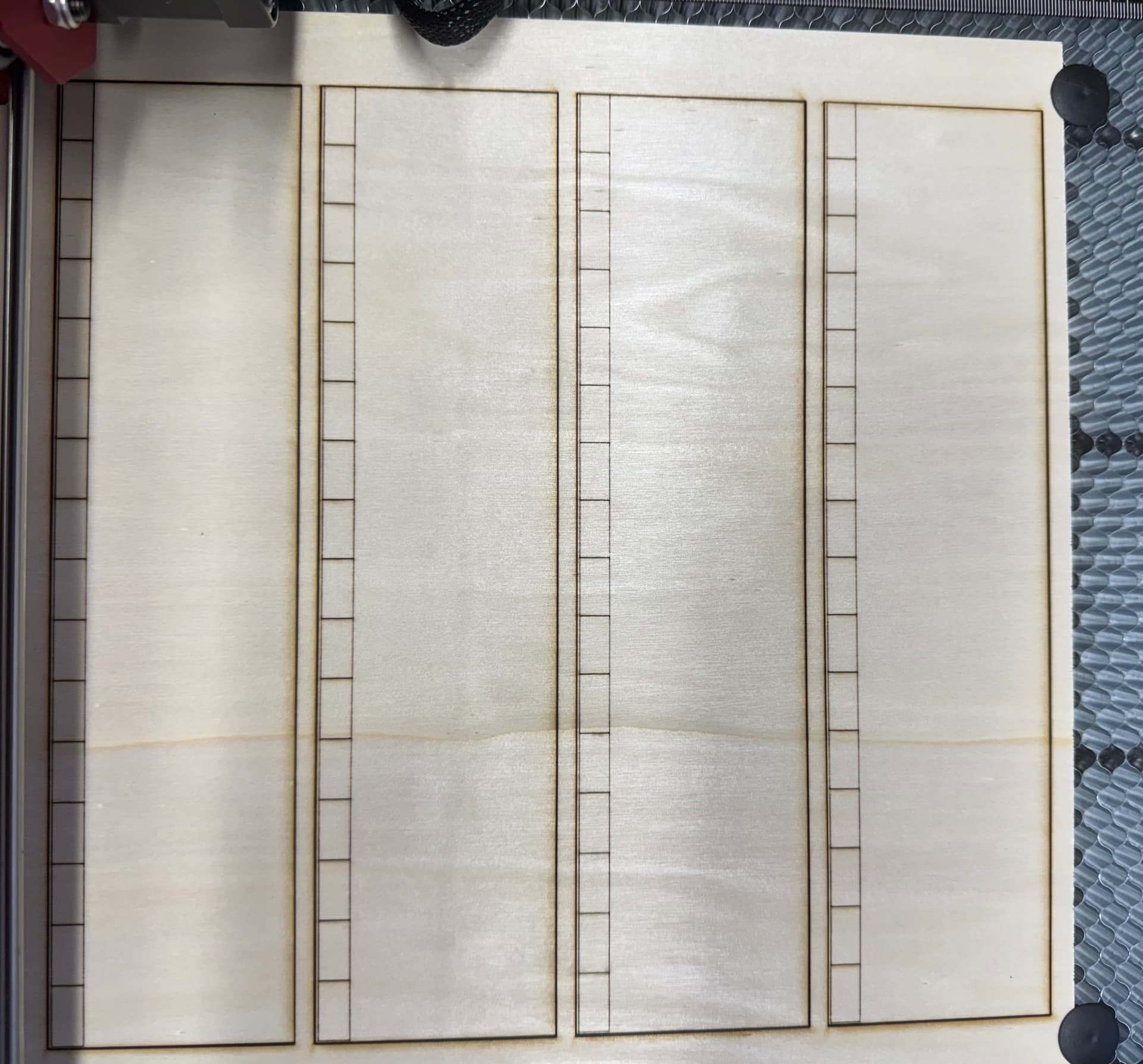

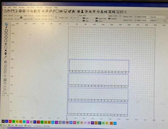

My first project for the cutter was to produce some station platform surfaces for my model railway. These should be plain wood all round except along one long edge there should be 3’ x 2’ paving slab edges. So, I have designed one of these with 18 paving slabs and approx 60mm width. I have some 300 x 300 2mm ply sheets so I drew an 300 x 300mm box to make sure that I wasn’t going out too far. Then I duplicated the first one four times on the board. When the print had finished, all I got was one correct board and the rest was rubbish.
Here is the design in Lightburn.
This is the result on the bed of the Algolaser
The settings were as follows:
The etch of the paving was 3000. mm/sec 80% 2 passes
The cut of the whole panel was 300 mm/sec. 100% power and 1 pass.
I know I should cut the paving down to one pass but why is the output crazy in comparison to the Lightburn file?

Certainly looks like a mechanical issue; belt slippage or drive gear slippage.
As @fins observes, it’s almost certainly a mechanical problem and the photo suggests it’s in the Y axis.
Uniformly scale this test pattern to fit the platform and run it as fast as it will go in Line mode with optimizations turned off and power set to mark (not cut) a sheet of cardboard:
GrundTest.lbrn2
Any differences from the design will be informative.
Upload pictures of the result so we can look over your shoulder.

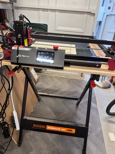

I took the advice given to make sure that the base was not shaking and also to check to tightness of the belts. I put the laser cutter onto a Black and Decker workmate. I screwed a plywood work to to the workman and placed the laser cutter on.
That seems to have stopped those problems. So here is the result. Four nicely produced platform tops ready for painting. I can now print another 8 or so and then some shorter pieces for the platform sloped ends.
I would like to thank everyone who contributed to solving my problems. There was a time when I thought that I had bought a wrong one but all of your effort have resolved the issues and I am now confident of going forward. Thanks again to all of you.
