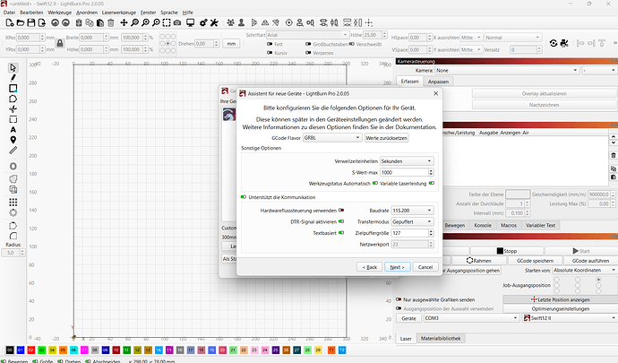

I have an Atomstack Swift 12W since Christmas. I used Atomstack Studio and found this software very usefull and easy to work with. However, since my main projects need to cut printed paper very exactly, I got problems whith the exact positioning.
I did a little research and found that a camera would help. But for that, atomstackstudio isnt capabal and even the Atomstack Camera says I need Lightburn for that.
The Problem:
I cant even connect my lasercutter to Lightburn.

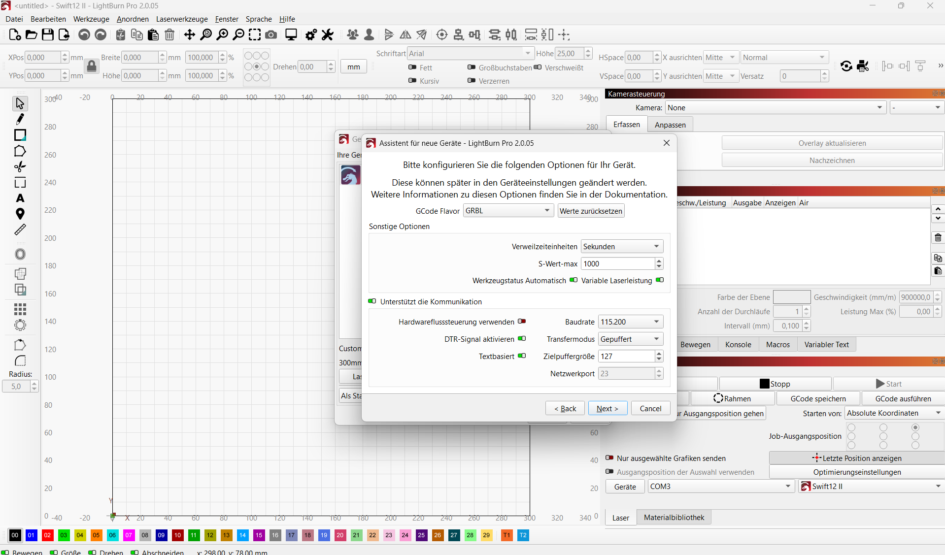

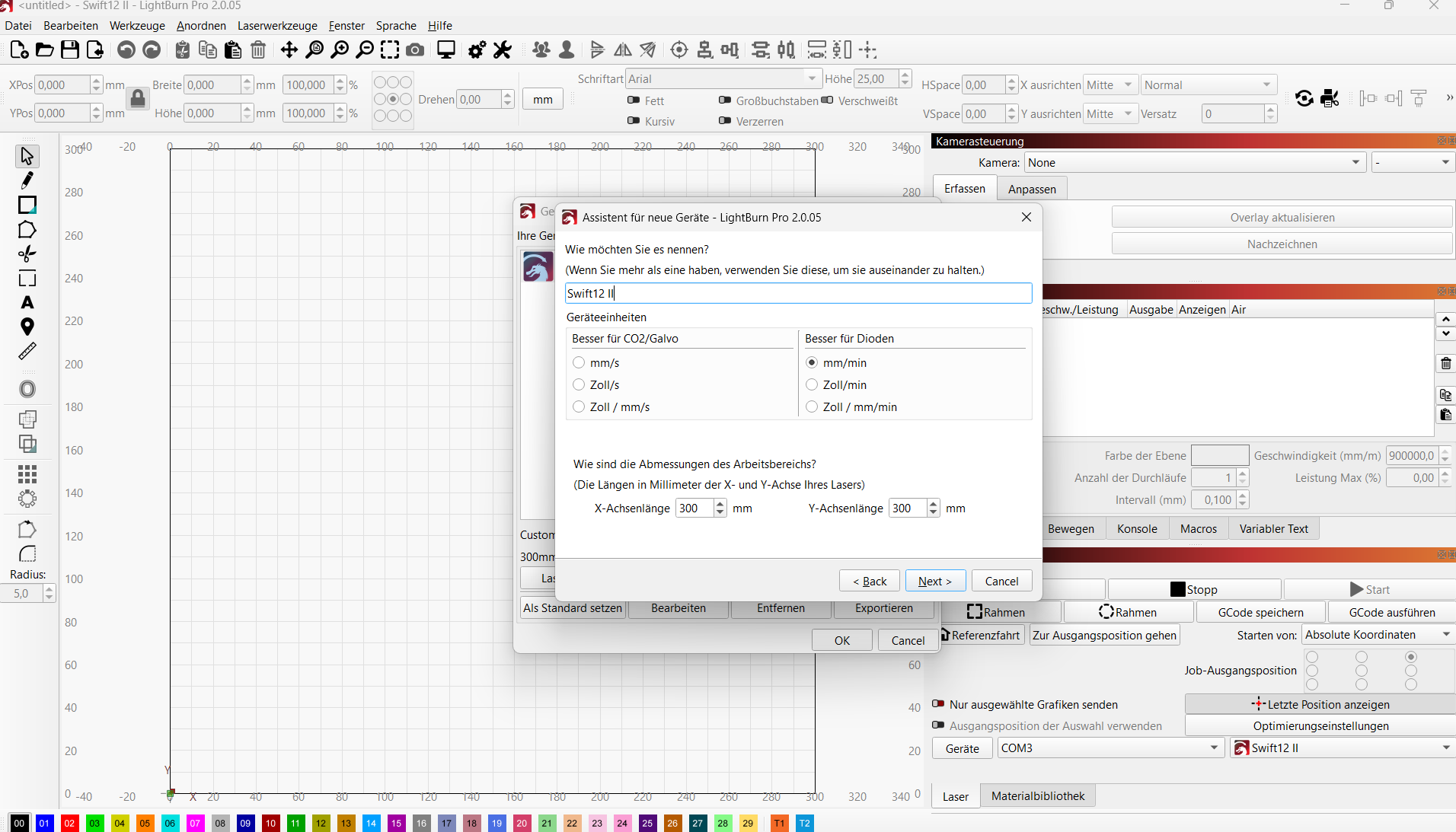

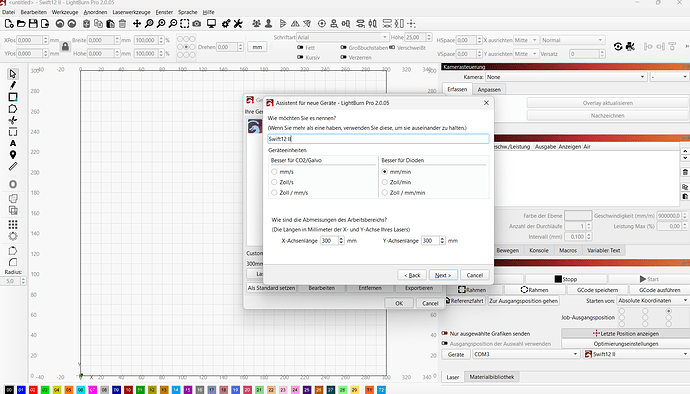

Lightburn cant find my device automaticly, so I tried it manualy:
Costum Gcode> Serial USB > settings (GCode Flavor: GBBL; Activate DTR Signal)
The “Laser”-Window says “Ready” (When I unplug usb it says “disconnected”) but i cant move the laser.
Can anyone help?

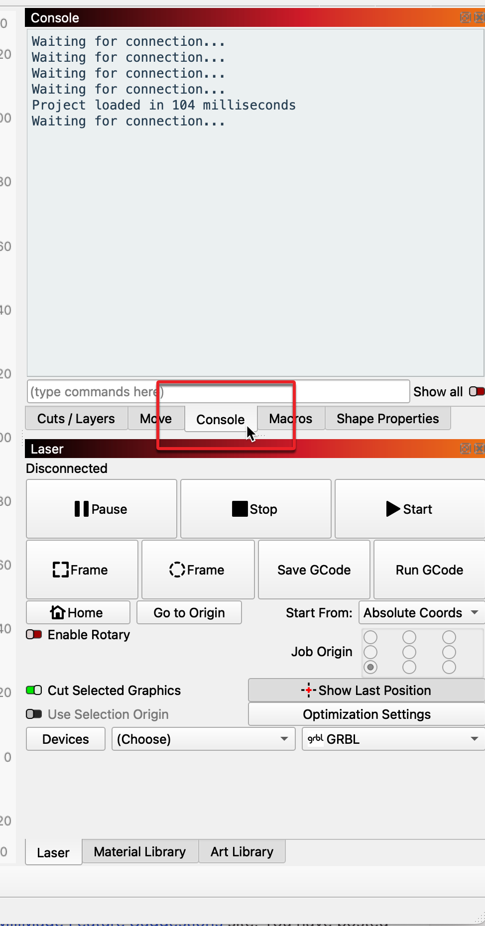

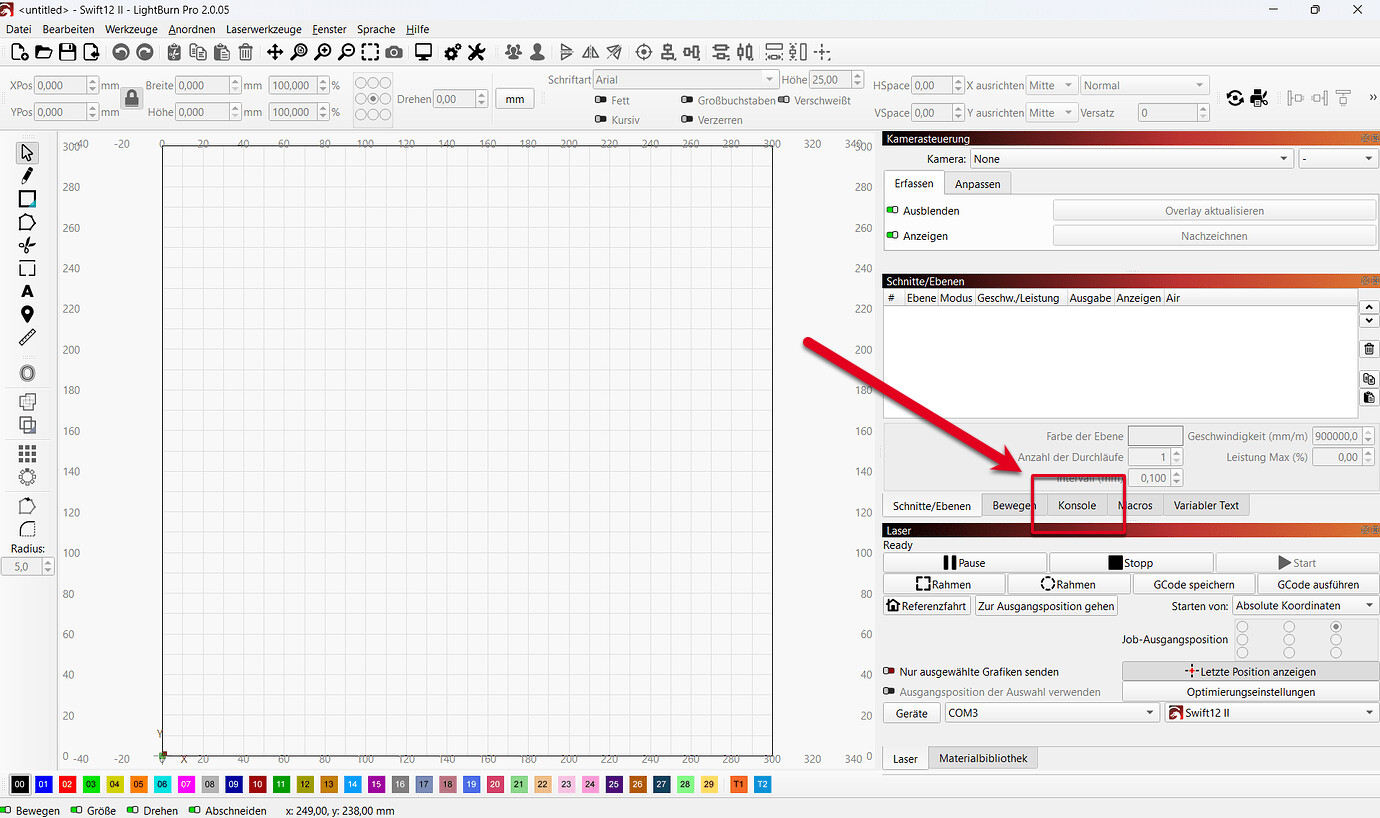

When doing this, what is reported in the ‘Console’ window? Share a screenshot or two, full screen and the console (the console window is scrollable; capture all reported there). Let’s start with that and we can go from there.
Thank You @Rick !

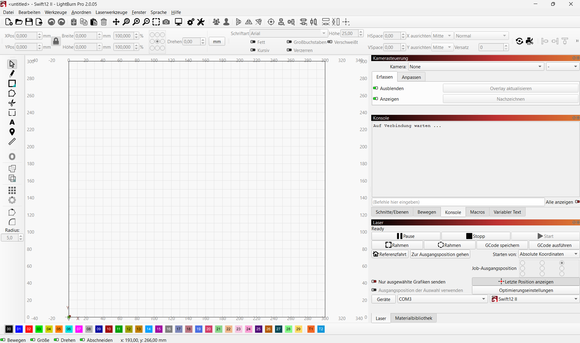

there isnt much to show. There is no window opening or something after this.
Iam not shure if I know what you mean with console? English is not my mothertongue. Console is the Lightburn screen, right? There is nothing scrollable

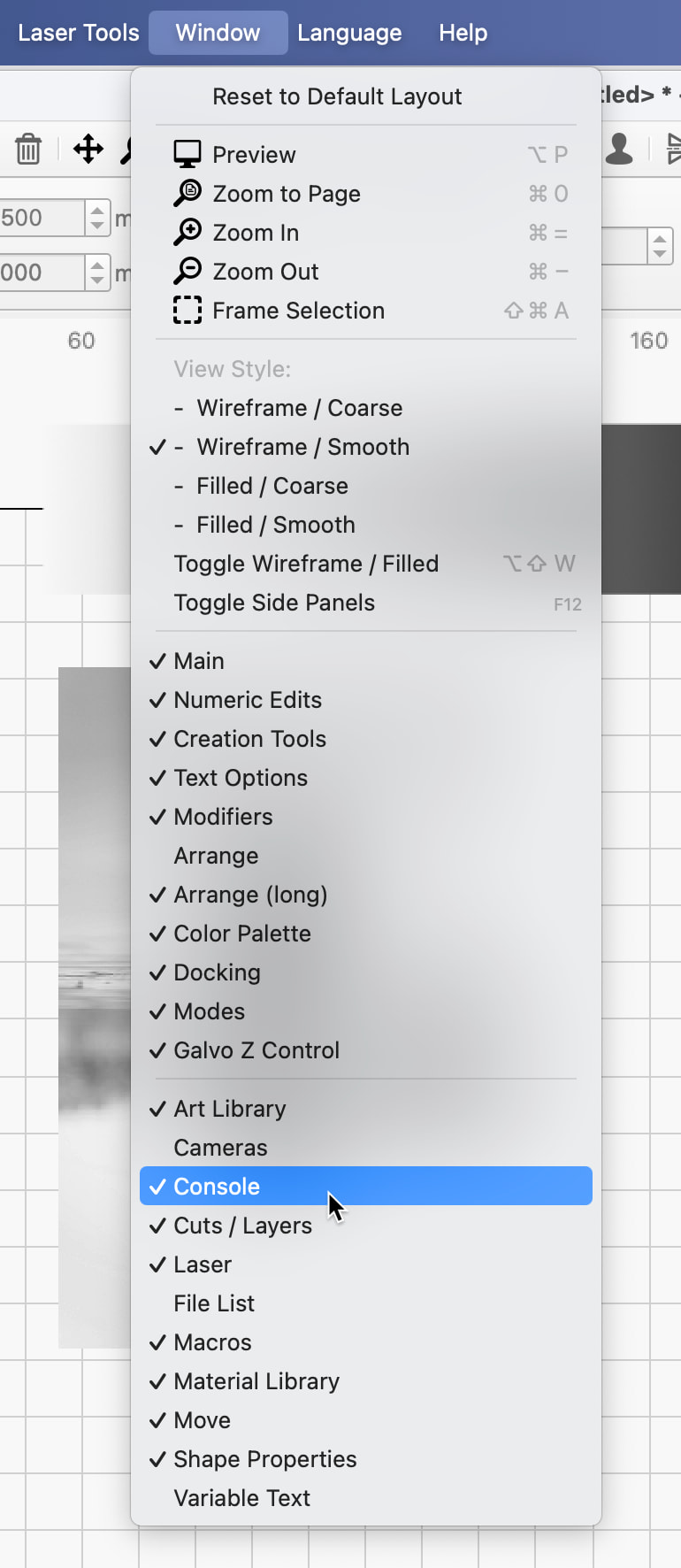

Let’s ensure you have the ‘Console’ window turned On first.
And here is that window docked to the default location in the LightBurn UI.

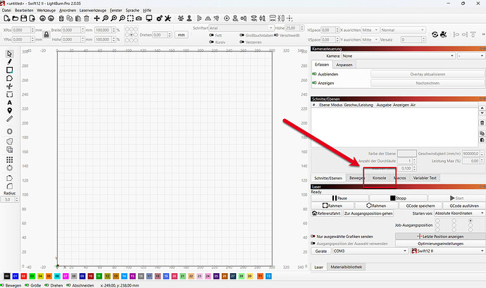

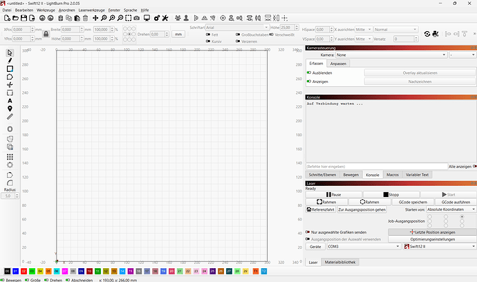

In an image you shared, I do see you have the Console window on. Click that tab to show the console contents.
It Says: Waiting for connection
