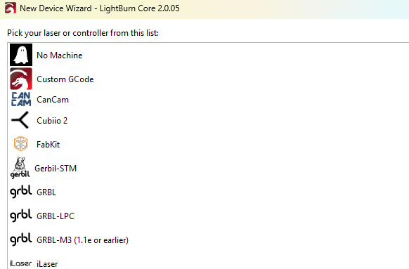

I can't connect my Longer brand laser machine to the Light Burn program; it says I need to download a program. Could you help me obtain this program?
Please provide more information about your Longer laser. We know nothing about a “hobby laser”.
Have a look at this guide by Longer:
RAY5 5W - User Manual – LONGER
(See page 28)
Not sure if that is that exact model you have but chances are your setup will be similar.
Pick: GRBL > Next > Serial USB
