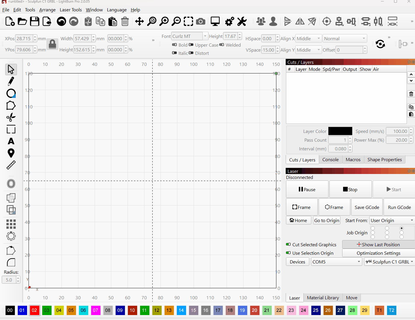

Hint: First thing to try is to create a Device in the Laser window Manually. It is very easy to do and takes just a minute or so.
Hi @Theresa1
The Swift 7 does not need to appear as a named “Swift 7” device in LightBurn. It should normally be added manually as a GRBL device using Serial/USB or if you found “Atomstack” that’s close enough!
After creating the device, make sure it is selected in the Laser window, then manually choose the correct COM port from the port dropdown.

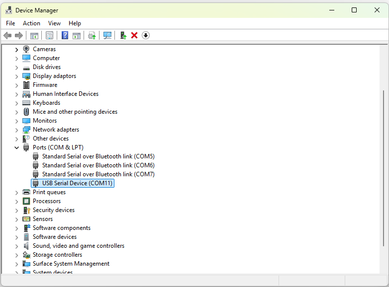

  • In Windows Device Manager, confirm the COM port appears/disappears when the laser is unplugged/replugged. (Right-click on the Windows icon, bottom left of your Windows computer, and select Device Manager.
Your engraver will show as something like USB Serial Device. Try plugging and unplugging the USB cable to find what changes.
COMSelection
If your computer does “see” the engraver, then LightBurn won’t either.

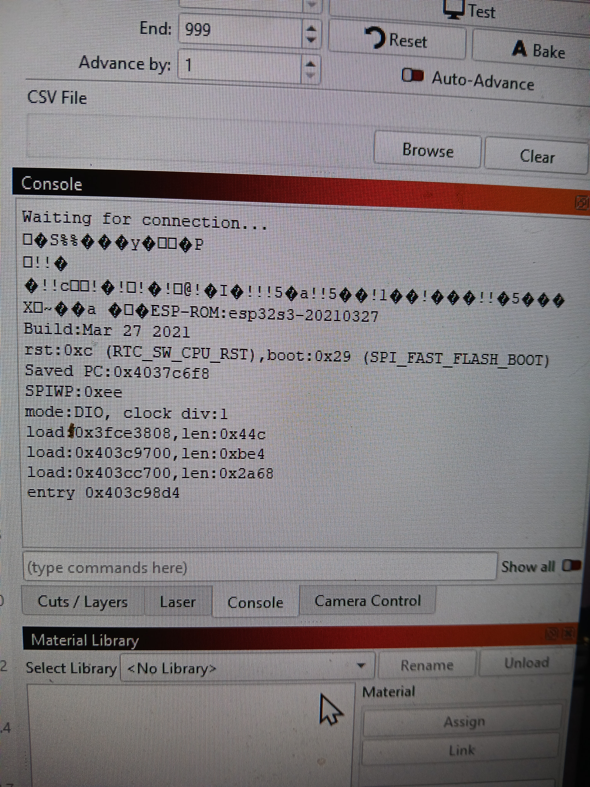

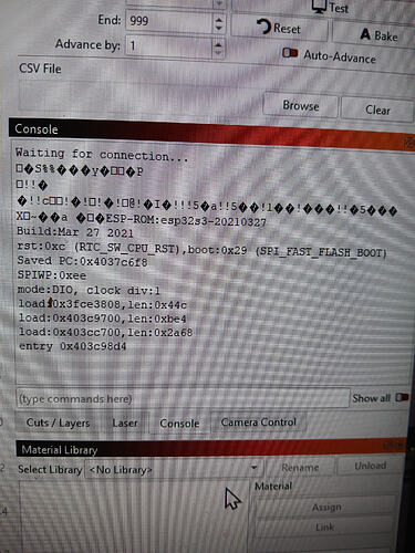

This is what i am getting now.
Looks like Lightburn is seeing the controller. Try entering ? in the Console window to see if it responds.
Screen snapshot: SHFT-WinKey-S is much more readable.

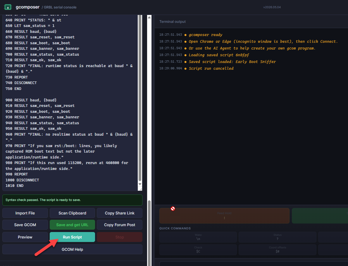

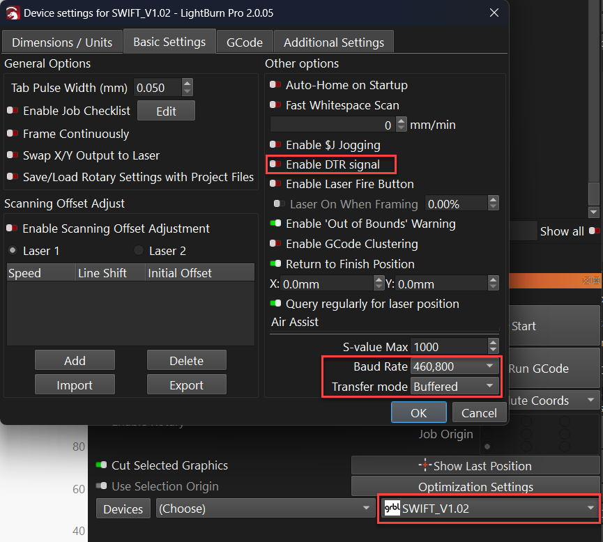

Make sure your connection settings like this:

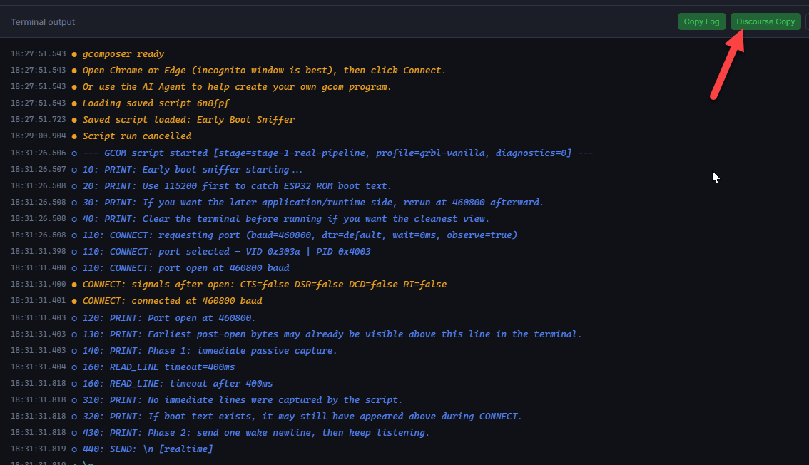

If you still have issues try this diagnostic check please:
Close LightBurn
Follow this link in Chrome or Edge browser:
https://gcomposer.app/?gcom=6n8fpf
Click on ‘Run Script’, ‘Run’, select a serial port then ‘Connect’
Then ‘Discourse Copy’ and paste the results back here please:
