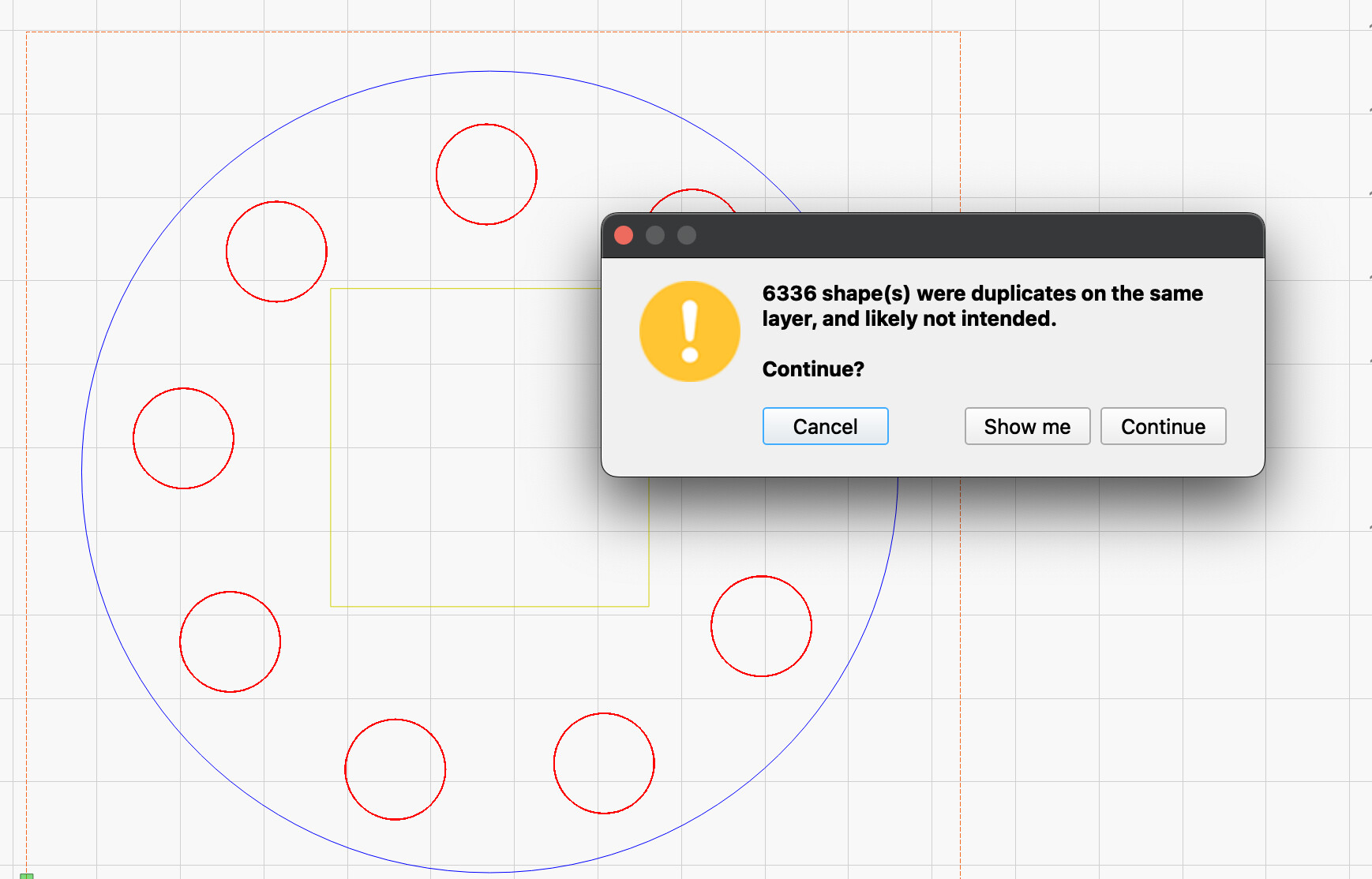

I did a polar pattern 8 holes and
When I do the preview, gives me the following message “computing inner/outer shapes” then if I tell to engrave, goes sits on a hole engraving if I divide by the estimated time is 5 minutes per hole. So I have no idea wqs going on. I used polar before and no issues. looked for an answer, but didn’t find one.

Here’s the problem. I see this when I go to the preview window. Click show me, then delete. This will remove the duplicates and it will work fine.
Thanks, that gave an idea, for some reason, I couldn’t get the the duplicate message you show me, but what I did was went to edit(shapes) and found the 719 duplicates of each circle.
Now a second question, how did that happen( what did I do to cause it), Again thanks the cutting is almost done.
