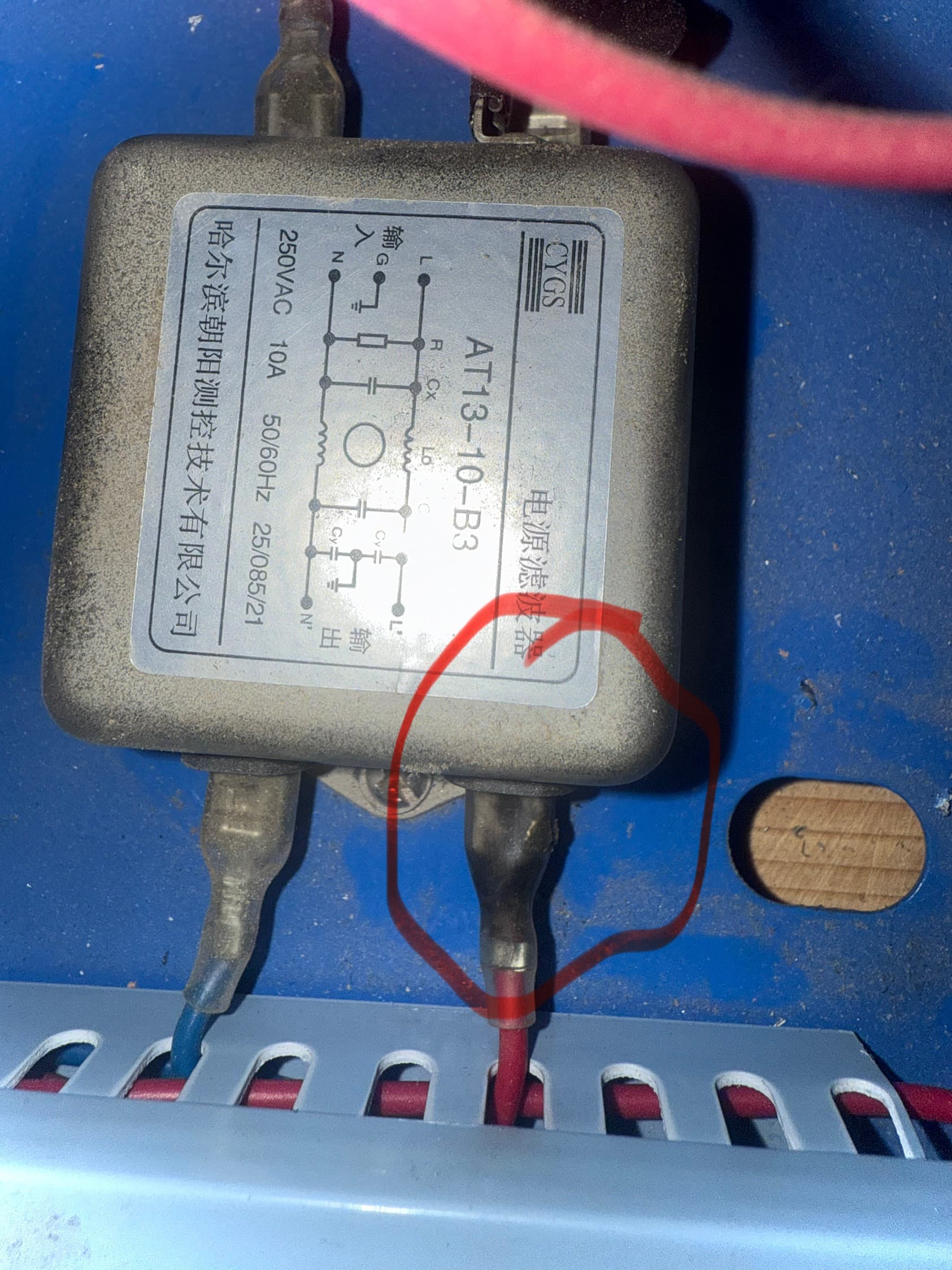

I did a really dumb thing, laser is dead
I know this is a lightburn forum, but with all the great expertise I am hoping someone can put me in the right direction
Omteck 50 CP2 laser.

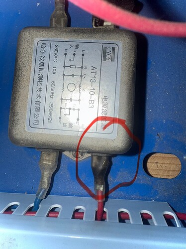

There wasn’t a hole through the panel for me to run the ethernet cable so I drilled a 1/2’ hole to run it through. I thought I was good and clear, but the bit caught and ran all the way into this black wire. if you look close you can see the cut, sparked and smoked:-(

Well, as far as I can see online that’s a AC power filter: https://www.amazon.com/OMXWOQMP-Filter-AT13-10-B3-AT13-20-B3-AT13-6-B3/dp/B0F8R2HMJL
So you hit mains voltage. That probably went into the chassis and hopefully out the grounded power cord.

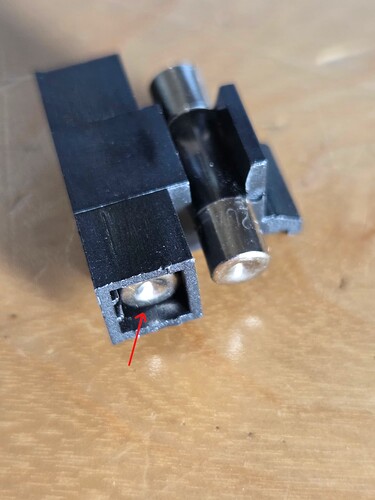

Sometimes there’s a small glass fuse in the socket that the power cord connects to.
There is very likely a fuse integratred into the power cable connection. A quick google search turned this up. Make sure you repair your wiring before replacement.

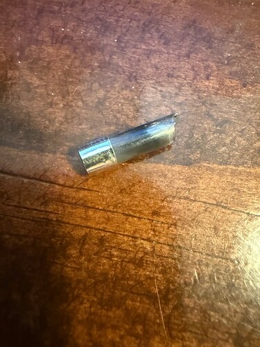

Thank you for finding this. follow on told me where the fuse is s, its shattered. so looking there first, but I save this saved in amazon.
Thank you
Thank you for pointing it out, mine does nt look like that but the fuse was fried and shattered. I will replace that and see any idea what ti is?
My 130W big CO2 laser is a 10A fuse. There’s usually writing on the silver bands of the fuse, or there may be a manual with a spec somewhere.
It ,ay still be stuck in there, this end does not have the writing.

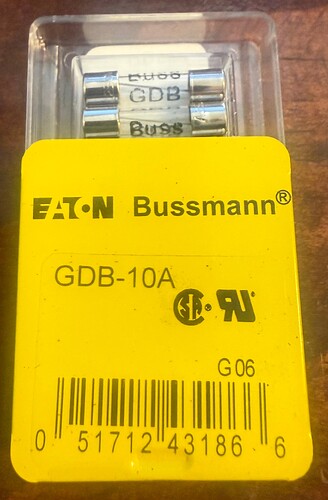

You want the “fast blow” variety for electronics, not the “slow blow” variety for motors. There are also ceramic versions less likely to shatter under duress, which is what happened to yours. :grin:
Of course, there are several “standard” sizes. Measure twice, because the fuse must fit the holder correctly = snugly to ensure a good connection.

I was able to take the two pieces of fuse out. I could not read them.. I just have cataract surgery yesterday. My neighbor could not read them But my neighbor tried over three hours. he ended up at Grainger And the old fart behind the counter says nope, then some youngster spoke up so let me see that. he was able to see the number on it and went right to the Parts catalog grab the fuse! they’re expensive five bucks apiece. I had to buy a box of five, but put it in and it comes on and works great!!!

On my OMTech 50W china blue machine the fuse it marked F20AL 250 and is 5x20mm in size.

Finally found it at Granger, first a older guy said don’t have them, then a youngster behind the counter knew what it was and had eyes good enough to see. It was 10A
Now that someone could see one of the responses above provided a link on Amazon a lot cheaper. Granger charged me $5 each, I had to buy a pack of 5.
