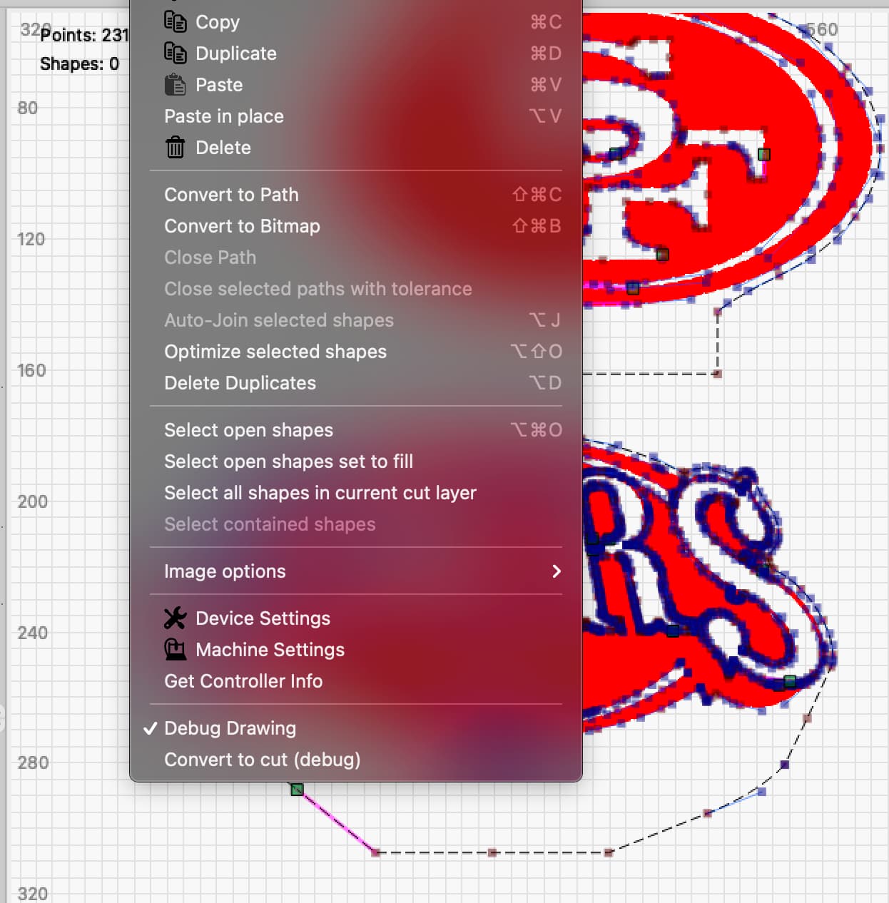

I was trying to close open shapes to fill on acrylic and somehow I selected something that made all of my projects look like this. Control Z did not undo the action and every new page I open has this. Thanks in advance for helping me get back to normal.

I did that. Control Z on my Mac until I got to the blank page before importing the image. I’m at a loss as to what I did. Every page I open now whether it be New or Import has this weird thing around the images.
The top left corner has Points: and Shapes: along with numbers. The original file is now fixed and has no open nodes, but I can’t get all this junk to disappear.

That’s how it’s supposed to look! On my page there are a ton of little purple squares on each node. And a purple box outlining each design. Then in the left corner it says points: shape: and those lost all the points when I click on a shape. Preview looks great, but on the workspace it is a confusing mess. I was trying to close three open shapes when I clicked on something that made this mess. Control Z did not help at all.

Thanks for trying. I did a close up screen shot. You can see in the top left of the workspace where the points and shapes are. And all the -1 numbers on each point. I’m going crazy trying to figure this out.
Uncheck Debug Drawing

You ROCK!!! Thank you so much. That was it.
