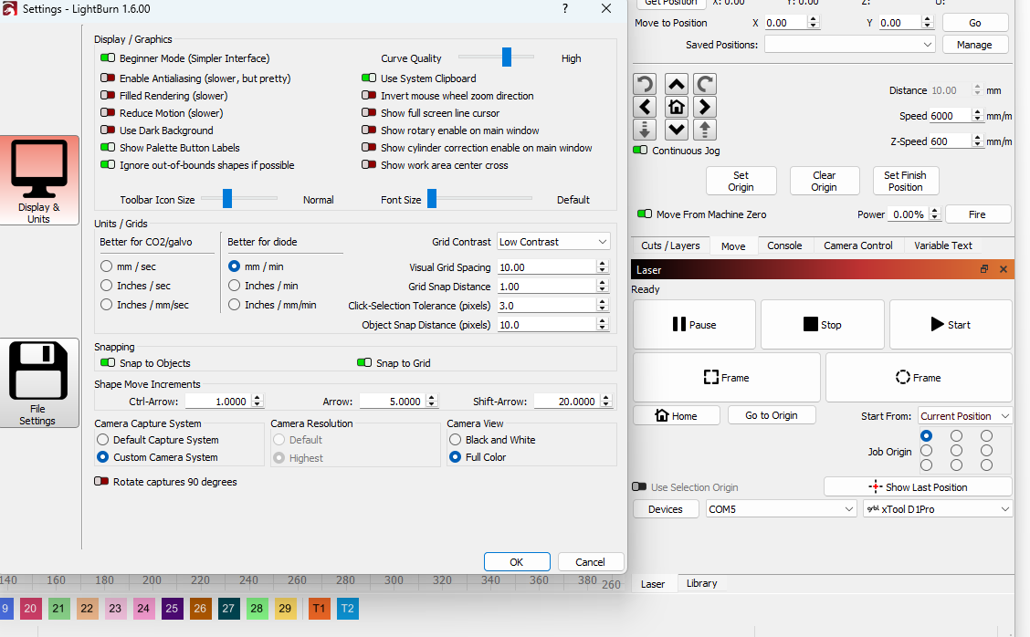

You said you have an Xtool D1 Pro. If this has a blue laser beam and a red cross hair positioning beam, since you have Pointer Offset disabled you should be using the blue laser beam to position your job not the Red Cross Hair Positioning beam. Also you can turn off Beginner Mode to give you more options in Lightburn

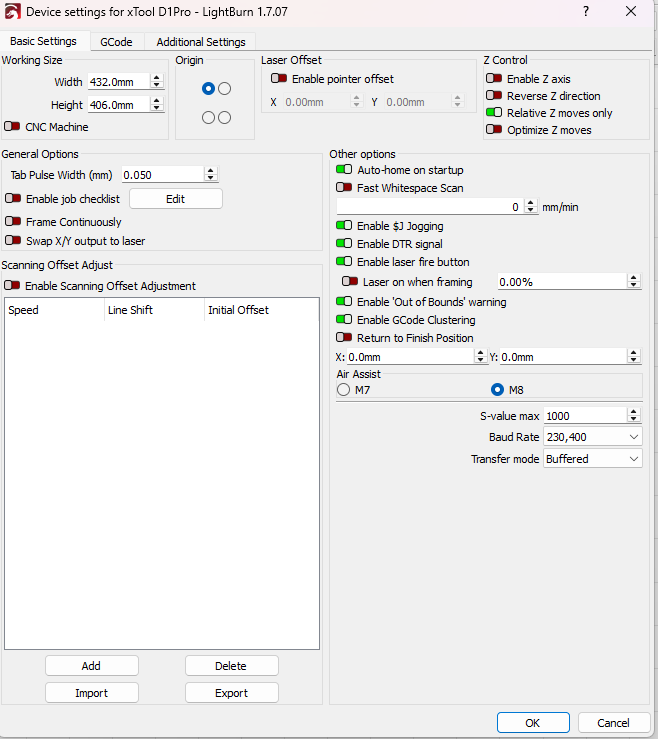

I do not see other than in the control panel where I can toggle off the offset
I have both laser heads the IR and the Diode

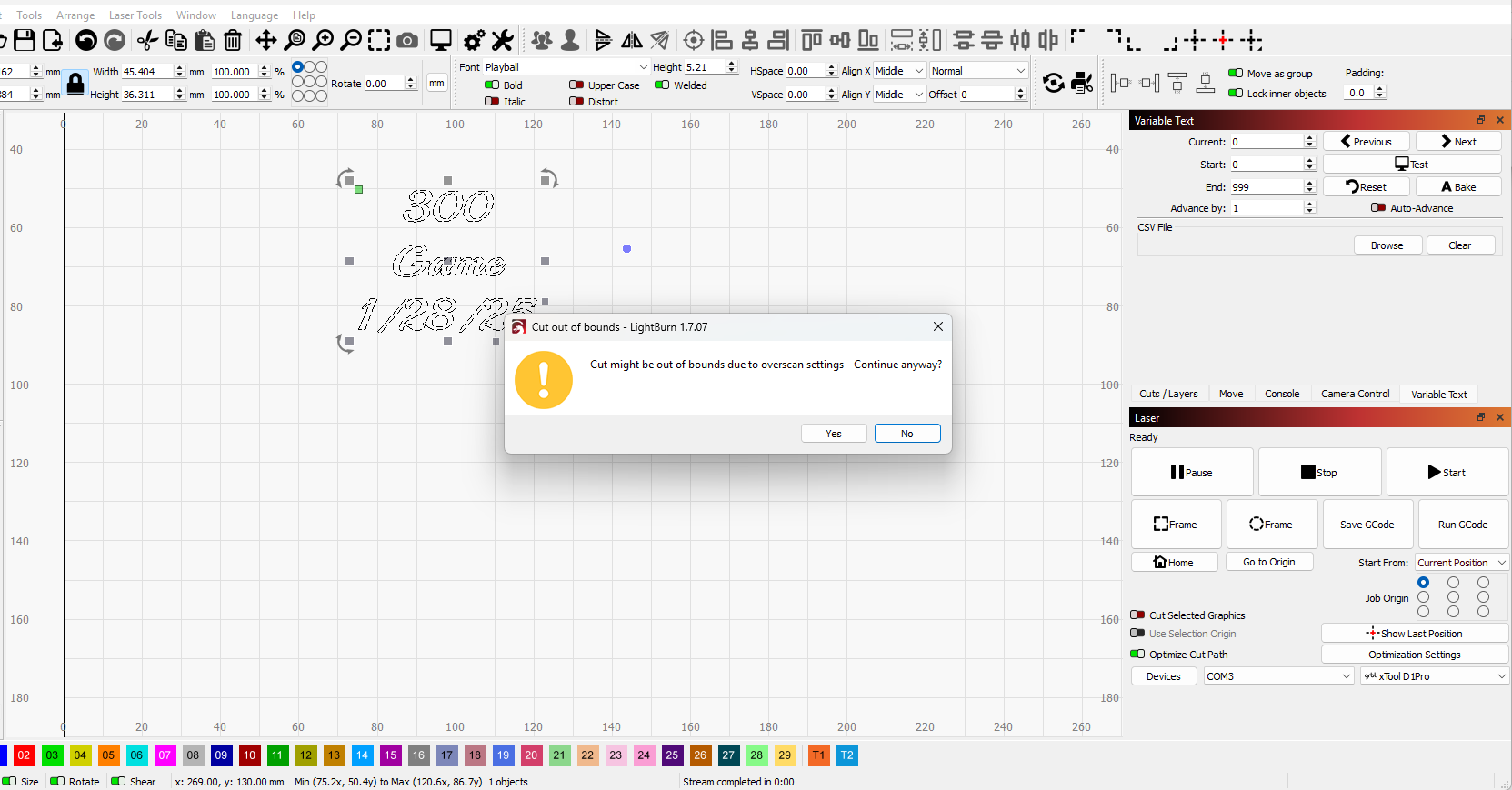

Not sure what is wrong. I am not outside the boundaries when I frame. When I start I get this message

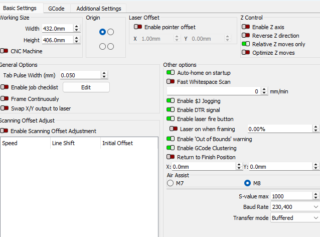

When the offset is off (on both the XCS=controller and LB) framing and lasering happen in different places.
When the offset is on, the offset value(s) compensates for the distance between the optical axes of the laser itself, and the red laser pointer.
All sorts of weirdness may occur if the offset is on both in the controller (XCS) and in LB.
That’s the reason why I suggested that You toggle the offset off in XCS.
My workflow doesn’t rely on the red laser pointer, nor framing, so I may remember incorrectly, but IIRC the offset is ~16mm in Y direction for the “blue” head.
IIRC, it was a hair different for the IR head.
In any case, there’s been reports that the offset differs a few millimeters between units, so it’s always best to test it.

As for the “Might Be Out Of Bounds” alert, it’s rather common with D1 AFAIK.
Sometimes it’s warranted, and is partly because of the difference in the optical axes of the laser pointer and the actual laser.
Sometimes it happens even if the work area has been reduced (by the offset amount) and/or the area to be lasered is relatively small and in the middle of the work area.
The latter is probably due to the GRBLishness of the xTool controller or a certain firmware version vs. LB version, AFAIK there’s not been a definitive explanation for it.
If there’s been an explanation, I’ve certainly missed it.

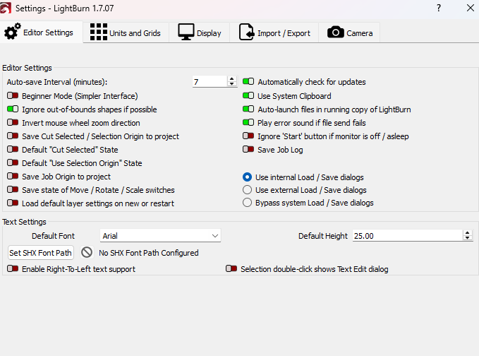

The out of bounds warning is common when you use current position even though you may not be out of bounds. This can be turned off in the settings. You will not get this if you use absolute coordinates

Your working size is 432 x 406. Seems like those are kind of weird numbers. Usually working size is something like 400 x 500 or 450 x 400 etc. I looked it up and X Tools D Pro says 430 x 400.
I do a lot of custom projects. That might have something to do with the strange sizes
Project size has nothing to do with your machine size. Machine size is the physical working area of your machine and once set should never change.
