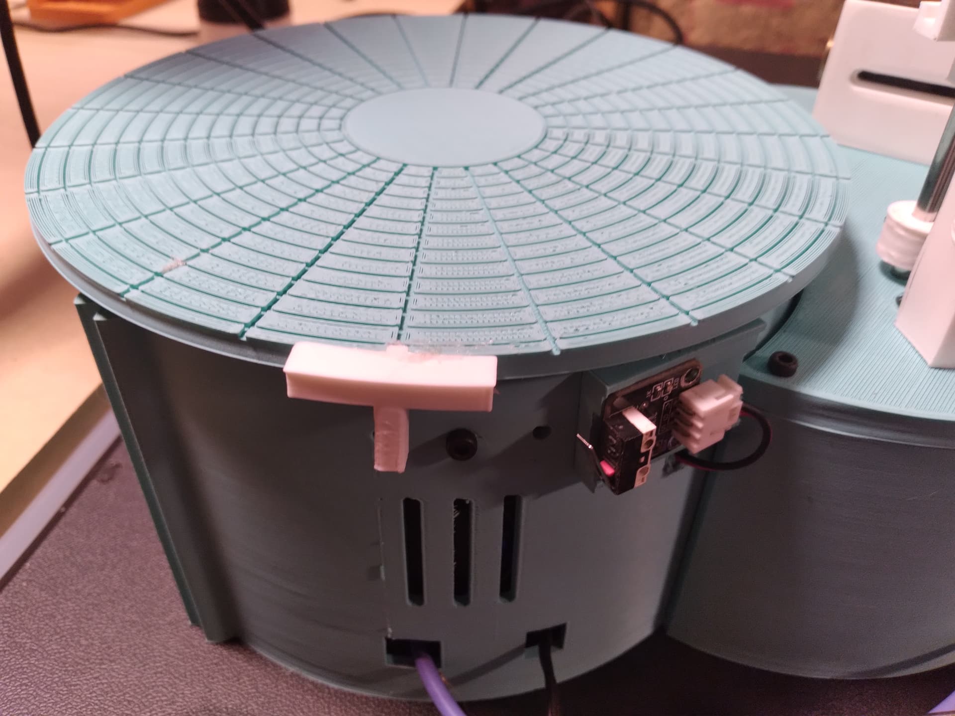

I am new to laser engraving/ laser work, but seemed to have a lot of mug orders. So instead of tying up my panel engraver i made, i did this:
it runs on fluidnc
esp32 d1 r32 arduino board with cnc shield
sd card
185mm table (y) with 200 mm (x)
has both limit switches. Or change out the table and not use the y limit switch.
well thought i would post to see if anyone like it

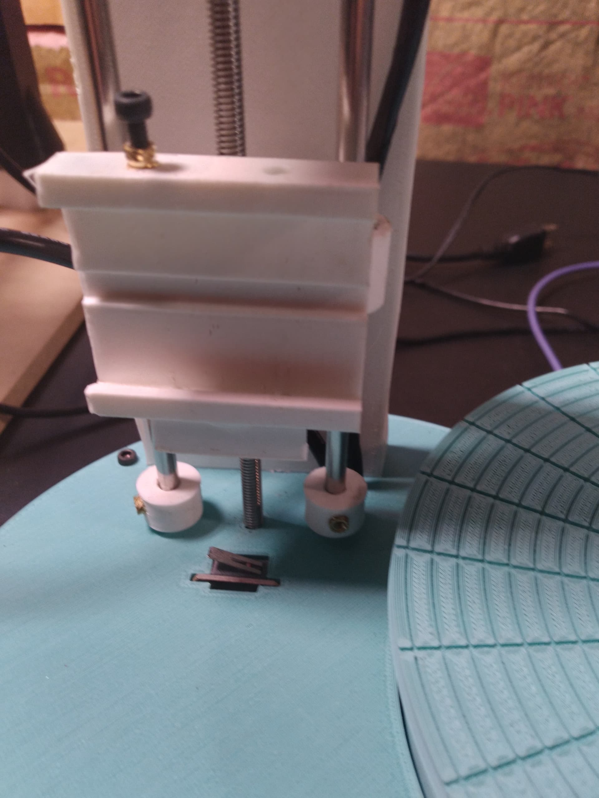

some more pics. any advice would be welcome. i did fix the belt on the printer to solve the issues

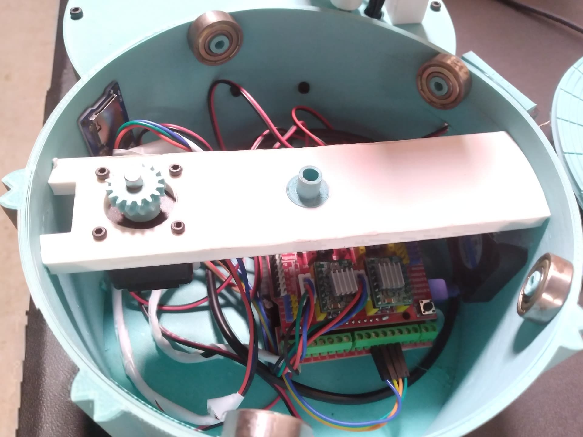

bit messy on the inside of it but i used what i had on hand.
and yes I printed the wrong file as its missing that bearing support so gonna reprint it and add the sd card mount stuff
