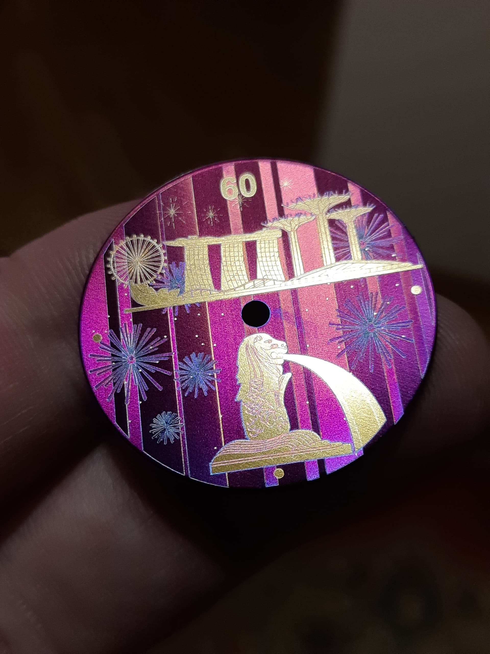

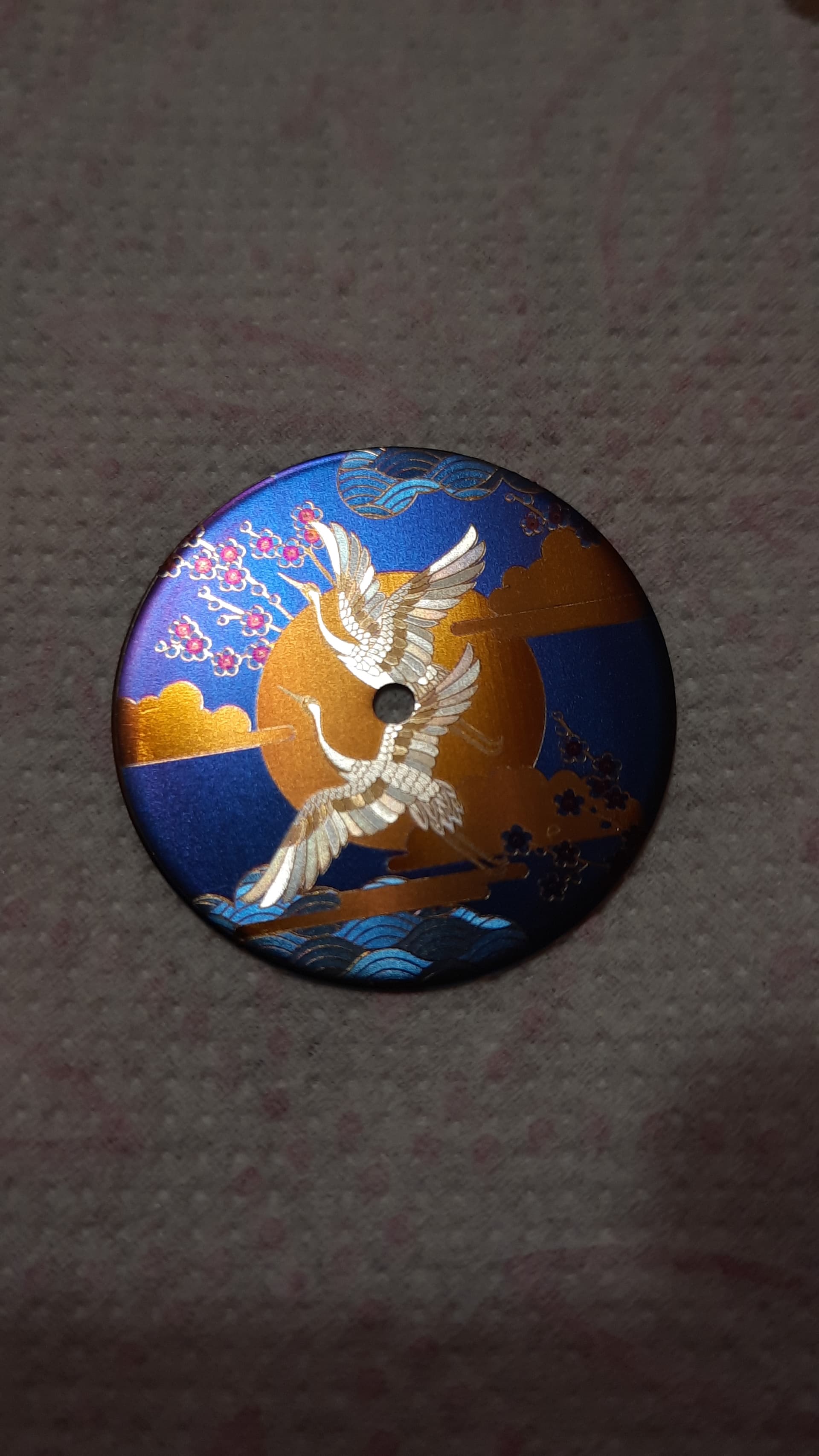

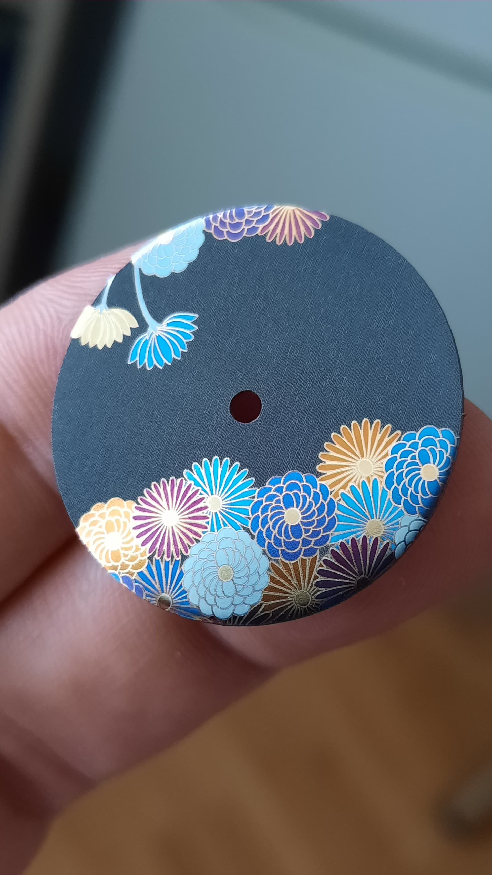

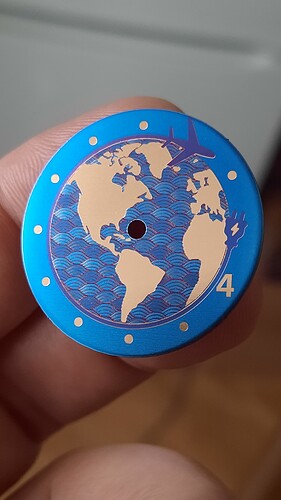

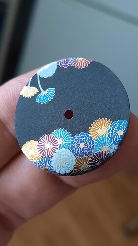

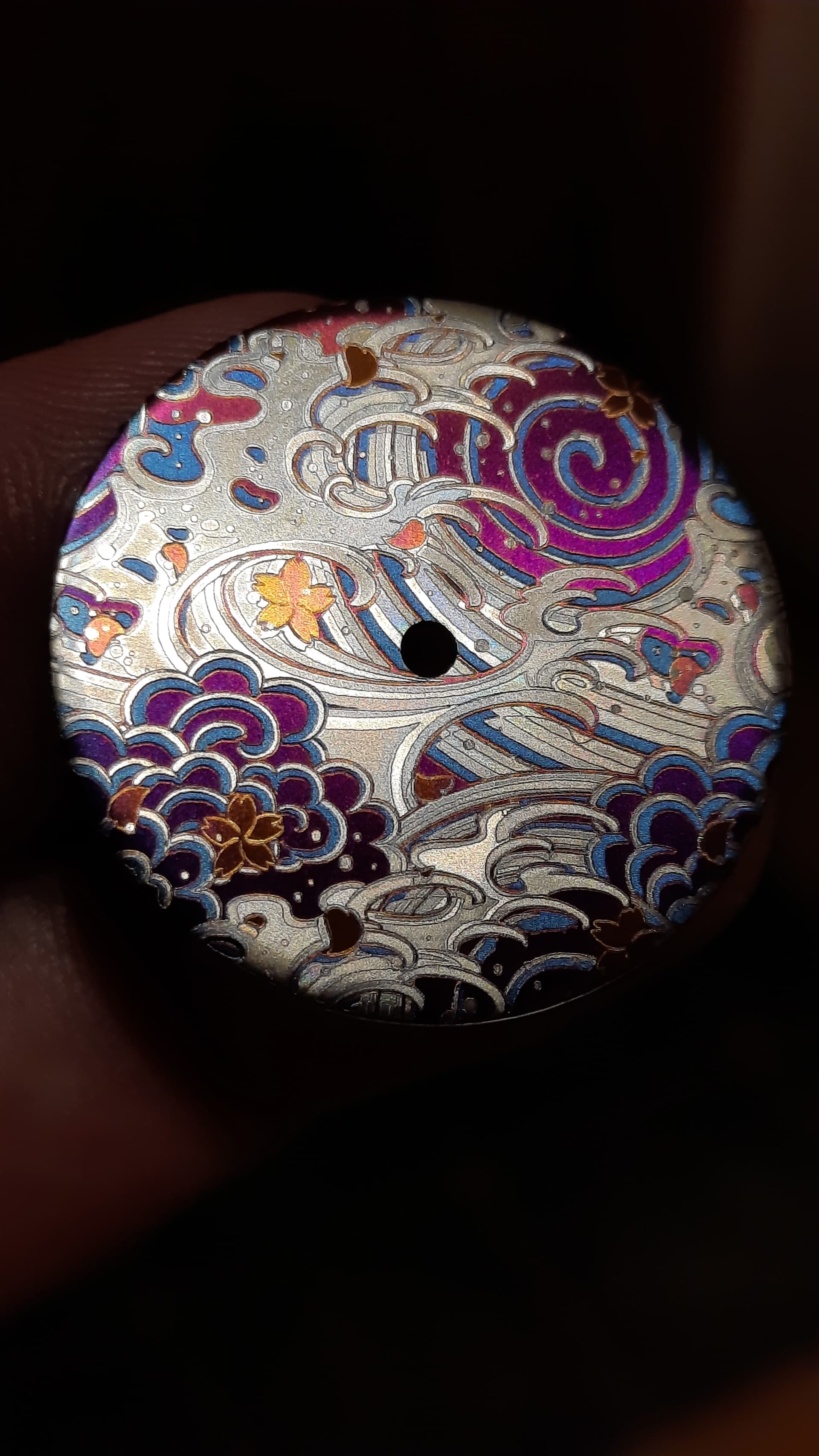

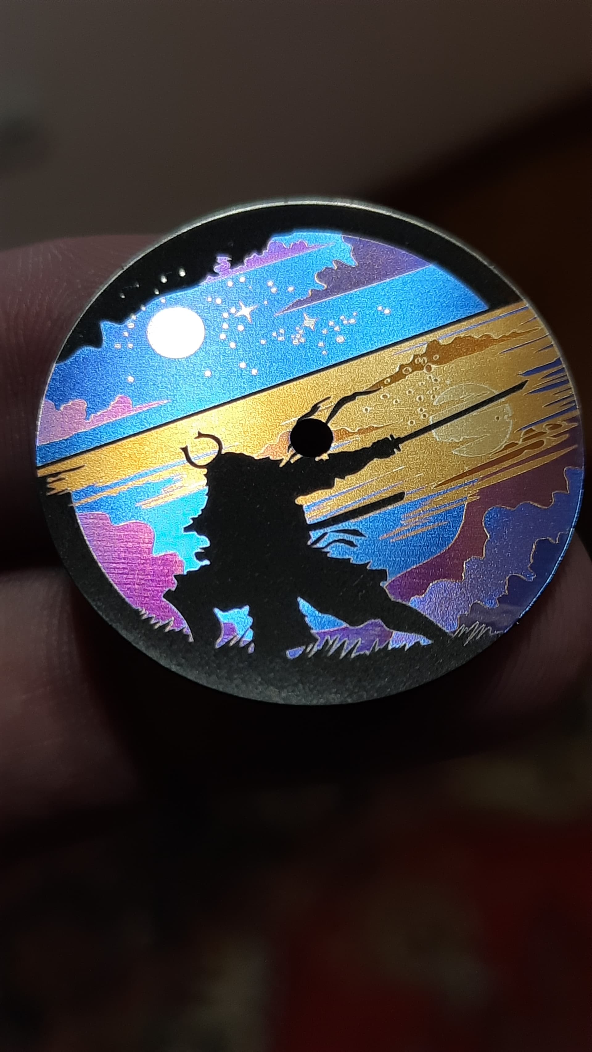

I need this for color laser engraving. Here are some examples:
To achieve iridescent effects, I need to slightly change the engraving parameters of each element, even though it is the same color, the parameters are different and then at different angles one color glows brighter than the other
Thank you for sharing these impressive results. Did you look at the options available with each Sub-Layer?
Without the exact setting details identified, I would suggest a review of all available Sub-Layer options, where you can adjust many of the parameters required to accomplish this goal. After review, please let us know which of the parameters you would like to control but can not do so with Sub-Layers in the current release. This will assist us in providing a more detailed response. :slight_smile:

I haven’t ran into this problem yet, but I’ve gotten close to using all the layers. I think a larger amount of layers is most useful for MOPA color work. Anyone that has worked with colors on steel or titanium know that they depend on the viewing angle, with a larger amount of layers you could have the same color settings with lets say 20° scanning angle difference on a layer, so that would be 9 different layers for a single color. As Sergey said this could be used to create fancy iridescent artistic effects so that a color pops-up in different place on an image depending on the viewing angle.
Additional use case if the layer number was as large as 256 or even unlimited would be to be able to use an 8bit color palette on a single engraving on steel or titanium.
