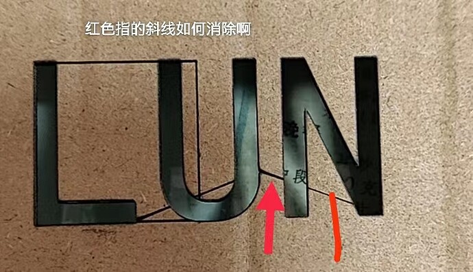

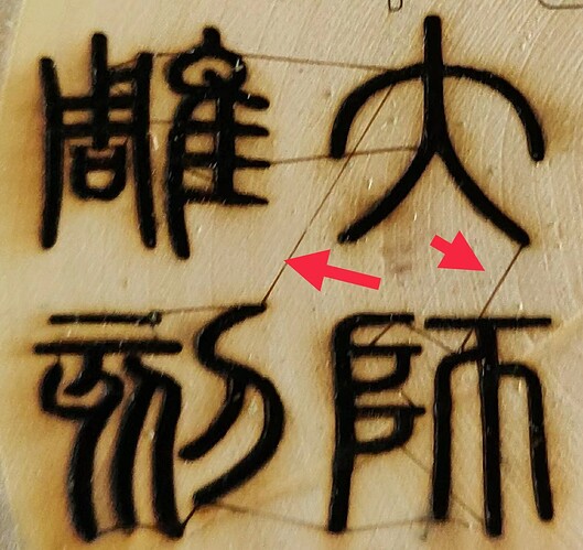

Please consult with all experts. I have a connection when using Lightburn to burn lettering. I don’t know how to handle it. Thank you
This is usually because you are not configured for laser mode ($32=1).
Thank you for your quick reply. I’ll give it a try
Thank you for your guidance. It’s done. Thank you
