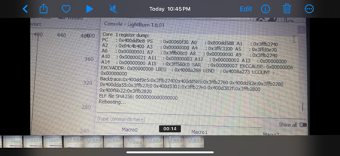

I have a elegoo phecda and it started to run a reboot
Hi Thomas,
This seems to be a firmware issue, therefore preceeds LightBurn.
Have you updated to the latest version?
Might need to get Elegoo support to explain what might be happening.
I would confirm if the power adapter is the correct one, and if machine performs homing as expected while unplugged from LightBurn

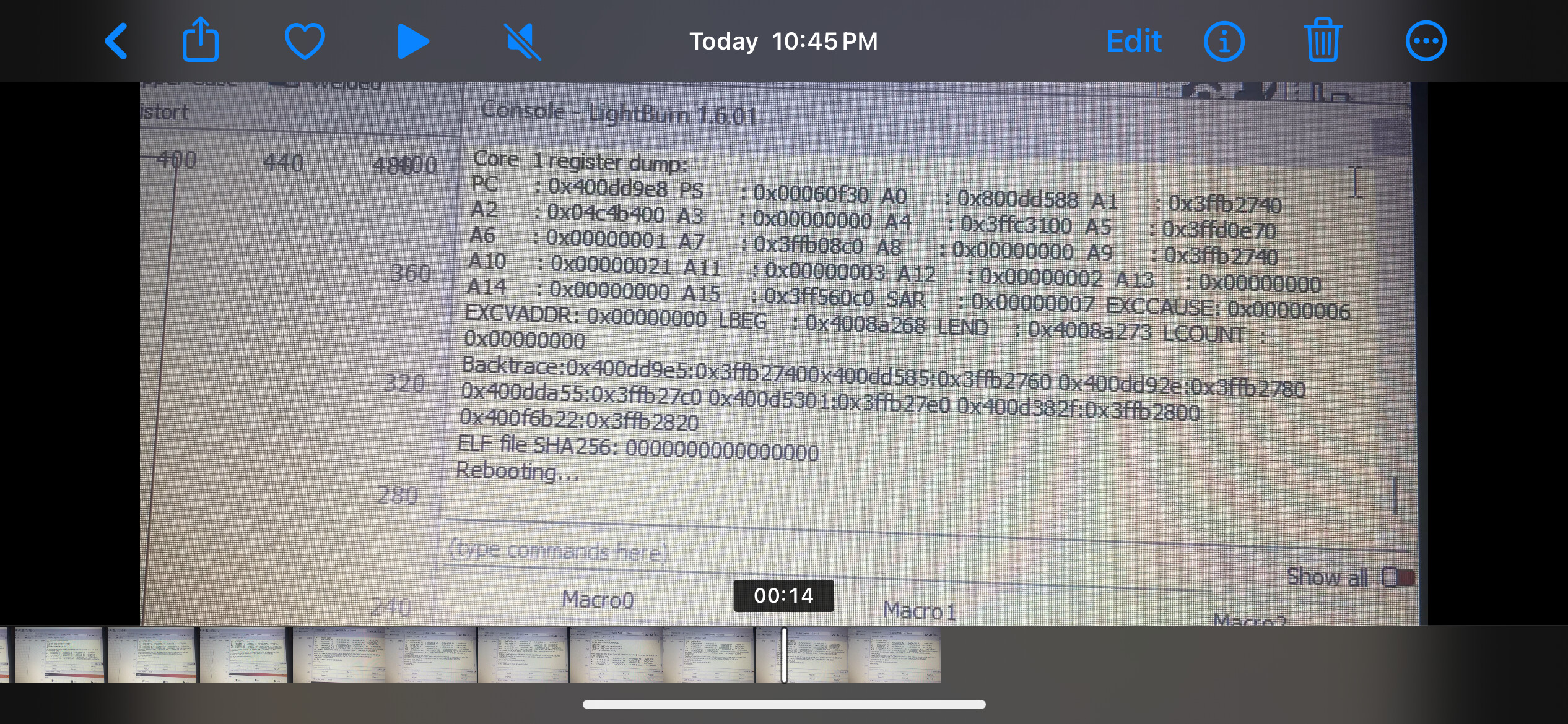

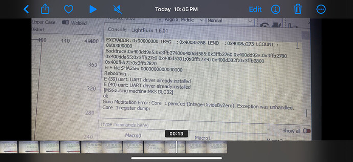

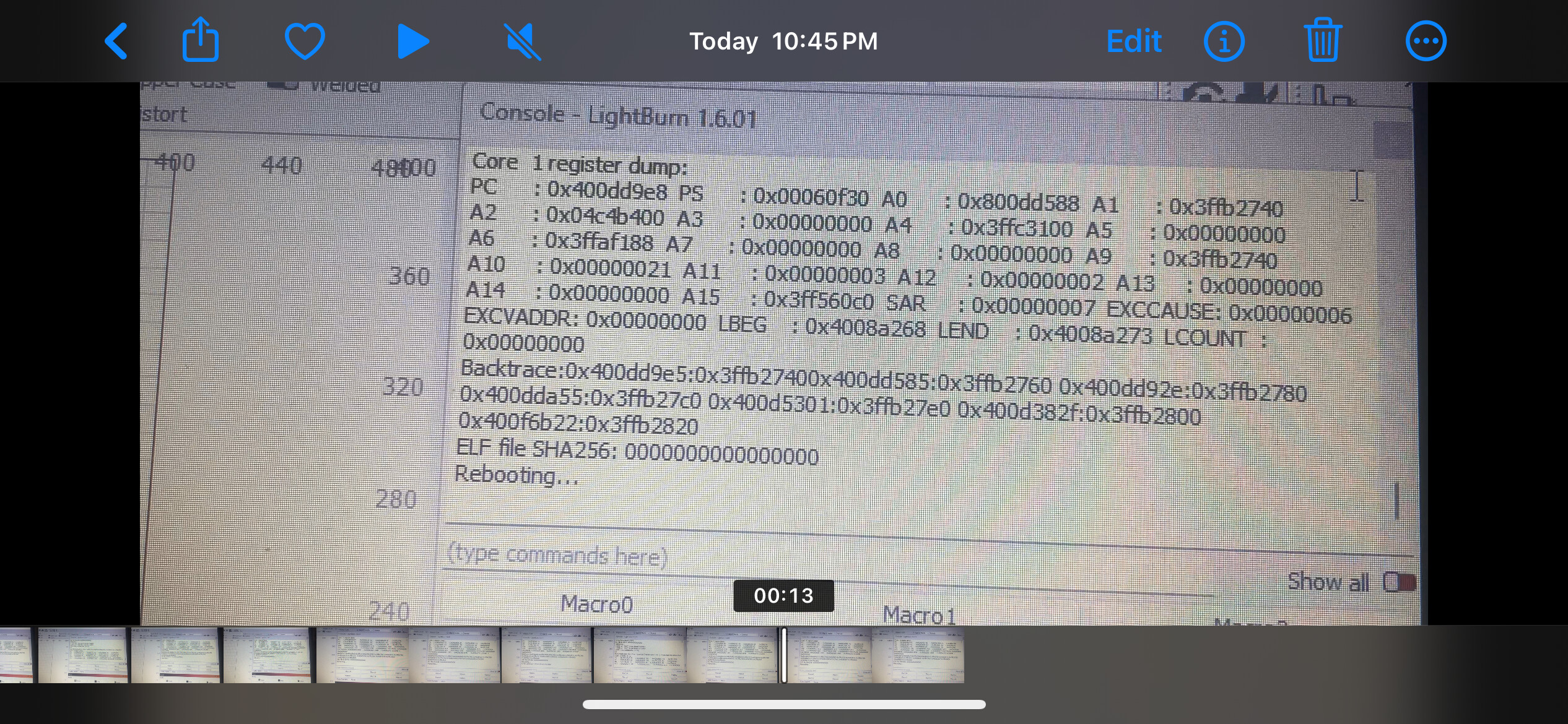

It appears to be an unhandled exception, like division by zero… Is home at startup turned off when you start Lightburn? Sounds stupid… just reading the output he posted.
I think it’s posted here - at least the config file… I thought the firmware was over there also…
