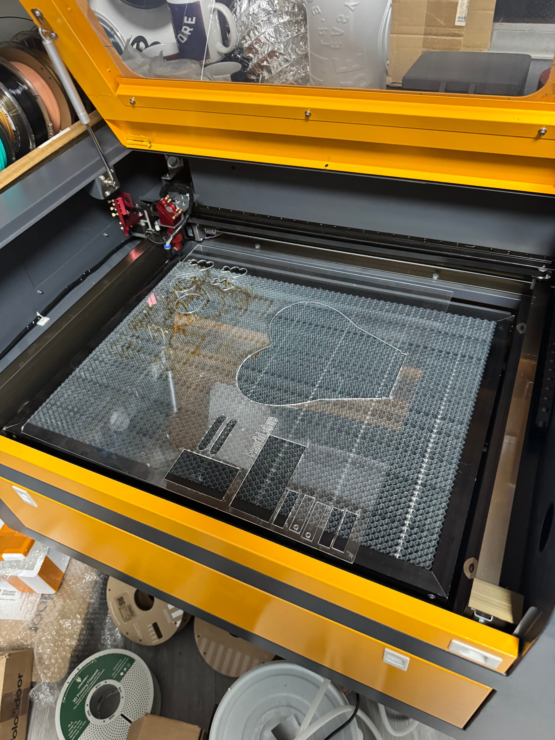

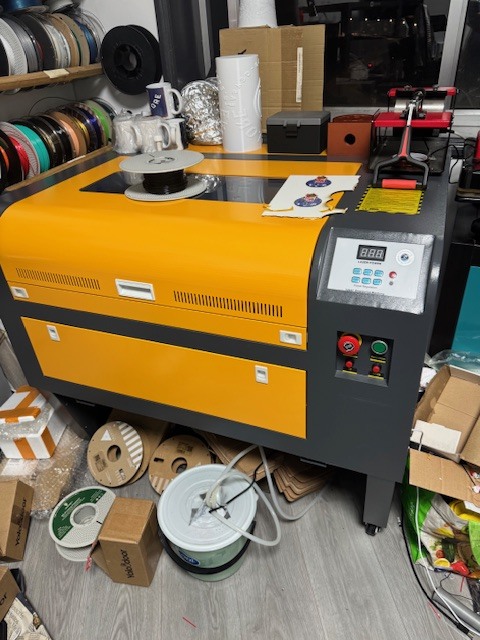

Hi i have a machine co2 vevor china with plate 600x400 i change por motherboard monport nano 2
the program reconized the machine but give me the error folt determination ponto zero homming.
i thing something i made wrong cant help me Thanks best regards

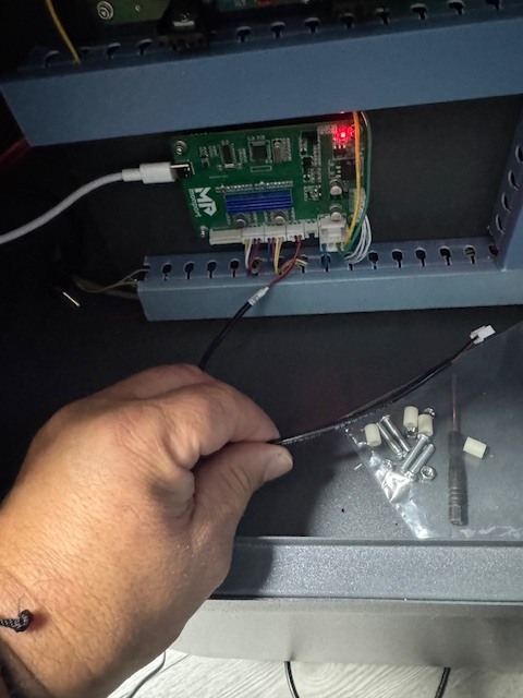

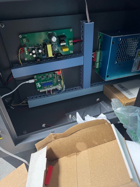

Please tell us more details about this machine.
Pictures of the interior and your wiring would be helpful.

i conect all like the manual only this Control Laser i cant conect

this is the cable but i dont know here plug
This controls the power of the laser. It connects to the laser power supply.
Described on page 9 and 10 in the manual:

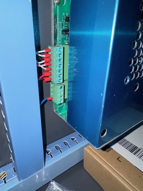

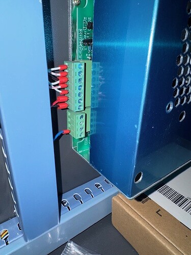

yes i see one picture but my power supply its diferent off the k40 i dont know here plug
there is my power supply here i conect ?

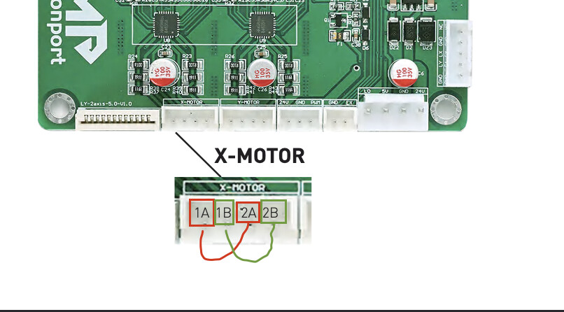

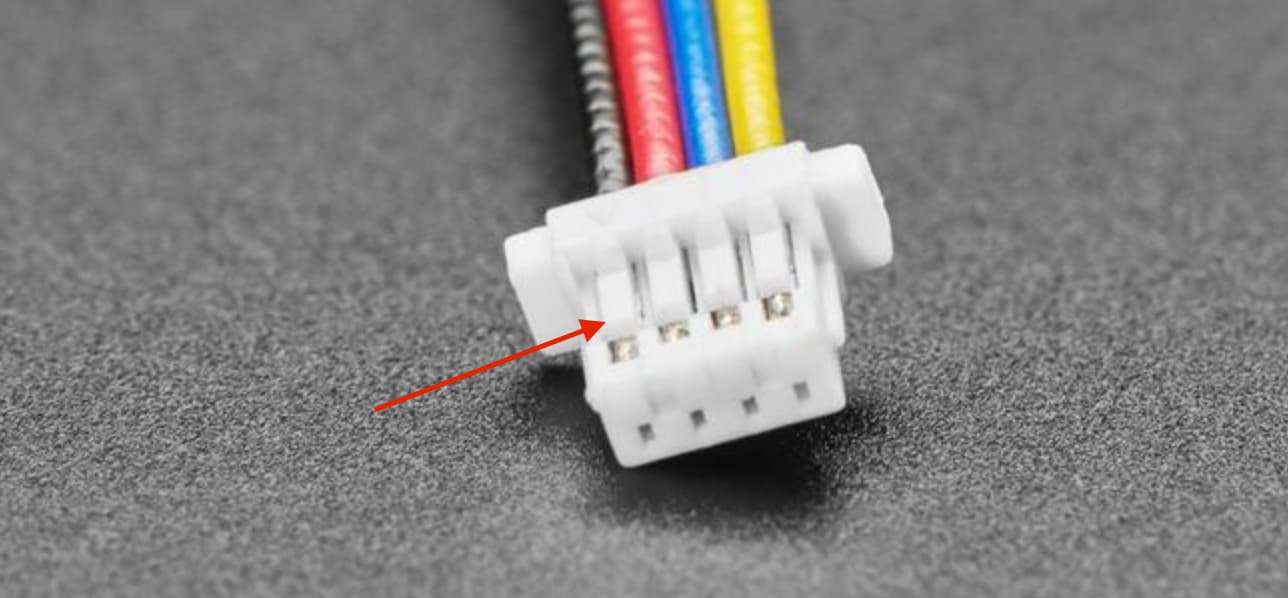

Did you ever see any movement on the motors? The coils of your motor might be wired differently.
Unplug the motor cables, and use a multimeter to measure the resistance on the cable going to the motors.
It should measure 1-20 Ohm between 1A and 2A, and between 1B and 2B.
If you measure any continuity between A1 and 1B, you need to switch the crimped wires on the connector.
Lift this tab to pull out the wire and reseat them accordingly.
