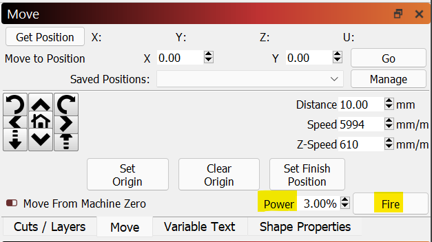

I tried to control my machine with LIghtBurn. My machine was controled its position of laser head. But laser beam couldn’t light on. Are there any commands to light on and off ?
Check the Console window when connecting. Does it give you information about controller type?
What device type did you select when you created the device?

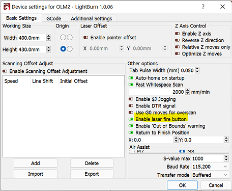

Try enabling Fire button from the Device Settings window. Then use the fire button in Move window to see if you can get a laser dot to appear. Increase power as necessary.
GRBL-M3 (1.1e or earlier) is appeared. I can select only this. There is no Fire button.
You can change this if required. Devices->Edit. Not enough information now to know if this will work yet.
You need to enable this in Edit->Device Settings.
Then there will be a fire button in the Move window. You may need to increase the power level to see a dot. This might not work if the device type is configured incorrectly.
