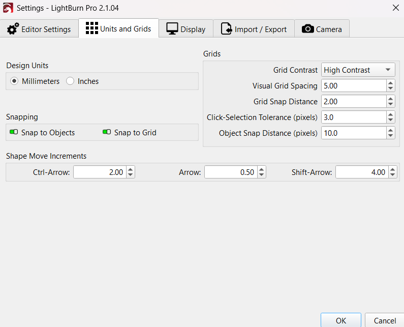

You can “abuse” the snap tolerance, it’s not a pretty solution but an option.
What do you mean by “abuse” the snap tolerance
I don’t know if this is will help, but you can turn off snapping.
