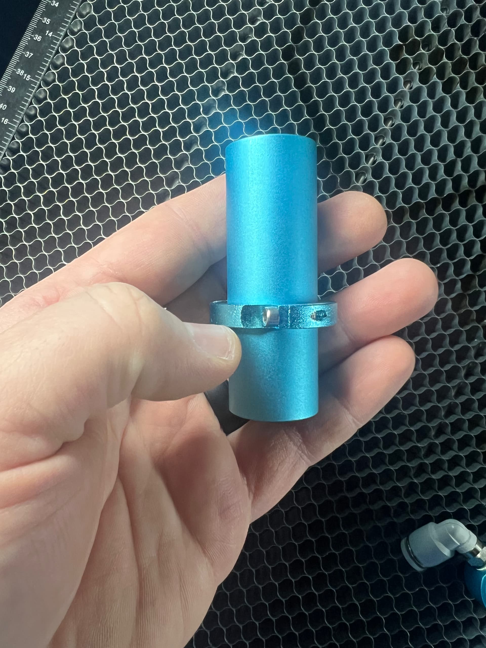

2nd is the more complicated one. I need someone to make me understand how this works because I’m lost on it. So my focal lens is close to the middle of this tube, isn’t the lens suppose to be that length from the material? Or am I wrong about that? I want to change the focal length but now I’m perplexed on how to do so.

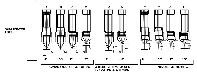

You lens will really depend on the type of tube and nozzle combination you have. The ones I use will allow you to flip them over to change where the lens is in the tube.
Note the nozzle hole size, your beam has to pass through this without any clipping.
These are different configurations of these tubes.
Hope that helps… a photo of this mounted in the head and/or a link to it may help us with suggestions.
Hope this helps

Omtechs customer support has been great until I got to the focal lens issue, tech support told me to change it and adjust my settings in lightburn, then I requested to buy a 2nd tube because it’s an absolute pain to change out and then through an email they told me the shorter focal lens wasn’t compatible with my machine because my focal length is “fixed”

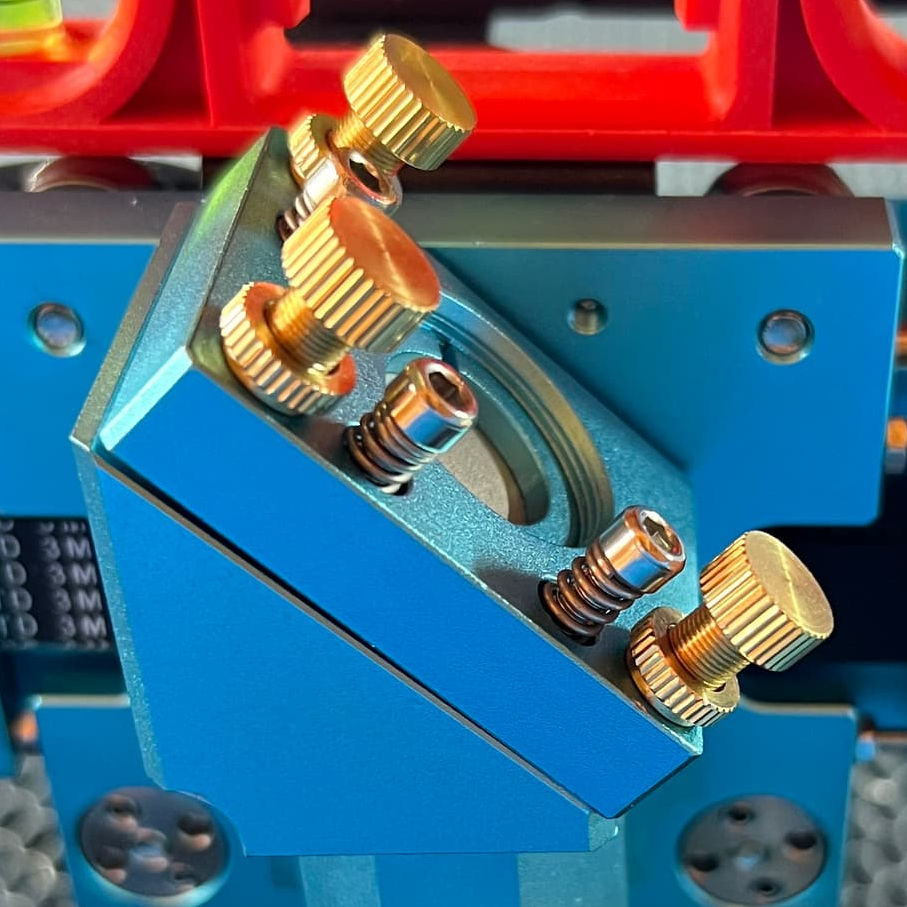

A slight digression:
When you get around to aligning the mirrors (because you should not assume they have been correctly aligned before crating the machine), note that the holder for Mirror 3 is jammed firmly against the laser head.
As a result, you must start by loosening the locknuts and turning all three screws inward to get some air between the holder and the mount. Start by getting equal spaces under the screw head and under the holder.
Then you can proceed with mirror alignment, because you’ll be able to turn the screws and have the mount move as it should.
You may safely assume the two other mirror mounts are equally badly adjusted, so expect some major movements before you start the actual alignment process.
