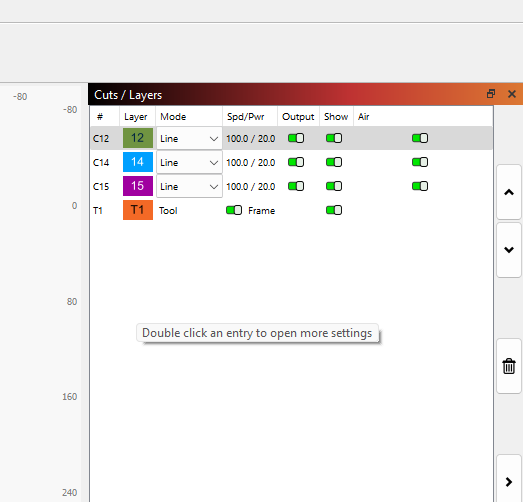

I lost all my speed/power settings on last update
I lost all my speed/power settings on last update there is all my tested speeds and power, now i got problem. every time when i turn off LB i lost it again!

The layers are not the place to ā€œstoreā€ settings. The layer settings will be overridden each time you load a file that uses those layers. You can have one setting for each layer that you set as default, but this setting will still be overridden by every file. So if you have tested values, store them in the material database, those retain and can be loaded onto any layer you like.

Same! Everything is now 100/20. I change it back and when I reopen it goes back to 100/20 again.
That indeed looks like a bug. Since both of you have the same default settings reset every time you start. Maybe remove the LB preferences in total and start fresh. Does it change anything?

In LightBurn, open the main Settings page, click the File Settings button, then look at this toggle switch:
If you have that enabled, then LightBurn is working exactly as it’s supposed to. This function was enabled by default, but there was a bug in the code that was applying it, and it didn’t force-reset the settings if you didn’t have your own defaults applied. That was fixed recently.
If you want your various layer settings to stay put, you can turn this off, or better, go to the Cut Settings Editor window and click ā€˜Make default’ at the bottom to make that layer setup the default you want.
If you leave the ā€œLoad default layer settingsā€ switch off, you’ll lose your settings any time you load someone else’s file who uses a different value on one of those layers, so it’s not a very good way to work in general - they’re too easy to have overwritten. The material library or setting your own using ā€œmake defaultā€ is the better way to do this.
Apologies to anyone who was caught off guard by this, but loading someone else’s project file or material test would’ve overwritten your settings too.
