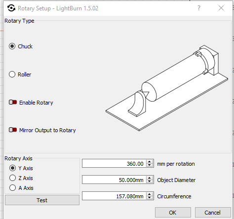

When I use the move in move folder I set the distance to 95 and click the up arrow and the laser moves and stops at 150 not 95 what am I doing wrong it must be in the settings
Any chance your rotary Mode is enabled?
Or that you changed the steps per mm in firmware settings?
Which of machine is the one that is giving you trouble?

i would check, in order
a) make sure you are using the right profile
b) in console type $i press enter $$ prss enter
And past the whole output here
c) make really really sure your rotary mode is NOT enalbled
I typed $i enter then $$ enter and nothing happened
I have included a screen shot of the rotary also.

seems you are not connected to the machine
power off and on the machine
Then reconnect lightburn
once done
press enter

your Y axis is set to 120 steps per min
Type $101=80
perss enter
Rehome machine and try again motion

Should be ok now. Give it a try
Yup it stopped @95 I just cannot wrap my head around this stuff.
Thank you
