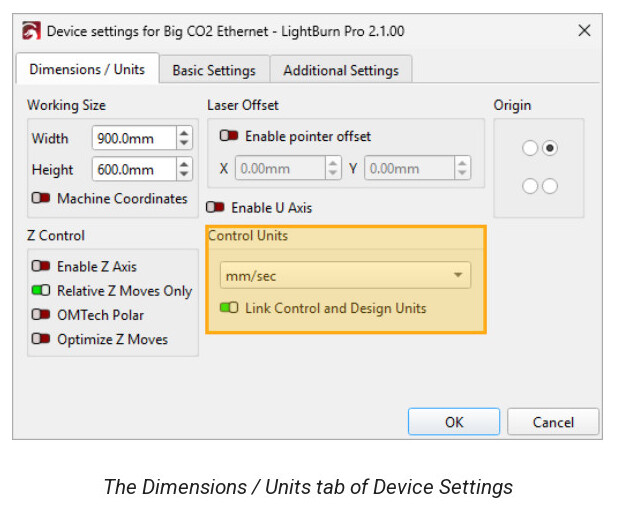

I’m using a 5watt UV laser, and it’s moving very slowly, with a testing speed of 1500mm/sec
Hi gang… I’m trying to use the laser on a cotton bag (I’ve had good success previously)… but no matter the speed i enter, the laser is moving so slowly its burning right through. I’ve looked but cannot see where this may have been discussed and if it was, my apologies. Any suggestions are appreciated.
Perhaps the speed units are in mm/min, rather than the mm/s you’re used to for the CO₂ laser in your profile, so it’s moving at 1/60 the speed you expect:

Are you saying the speed does not increase when you change it in the Cut Settings here?
If it’s still burning too strongly, you can decrease the power output by increasing the Q-Pulse value (but you surely know that)
